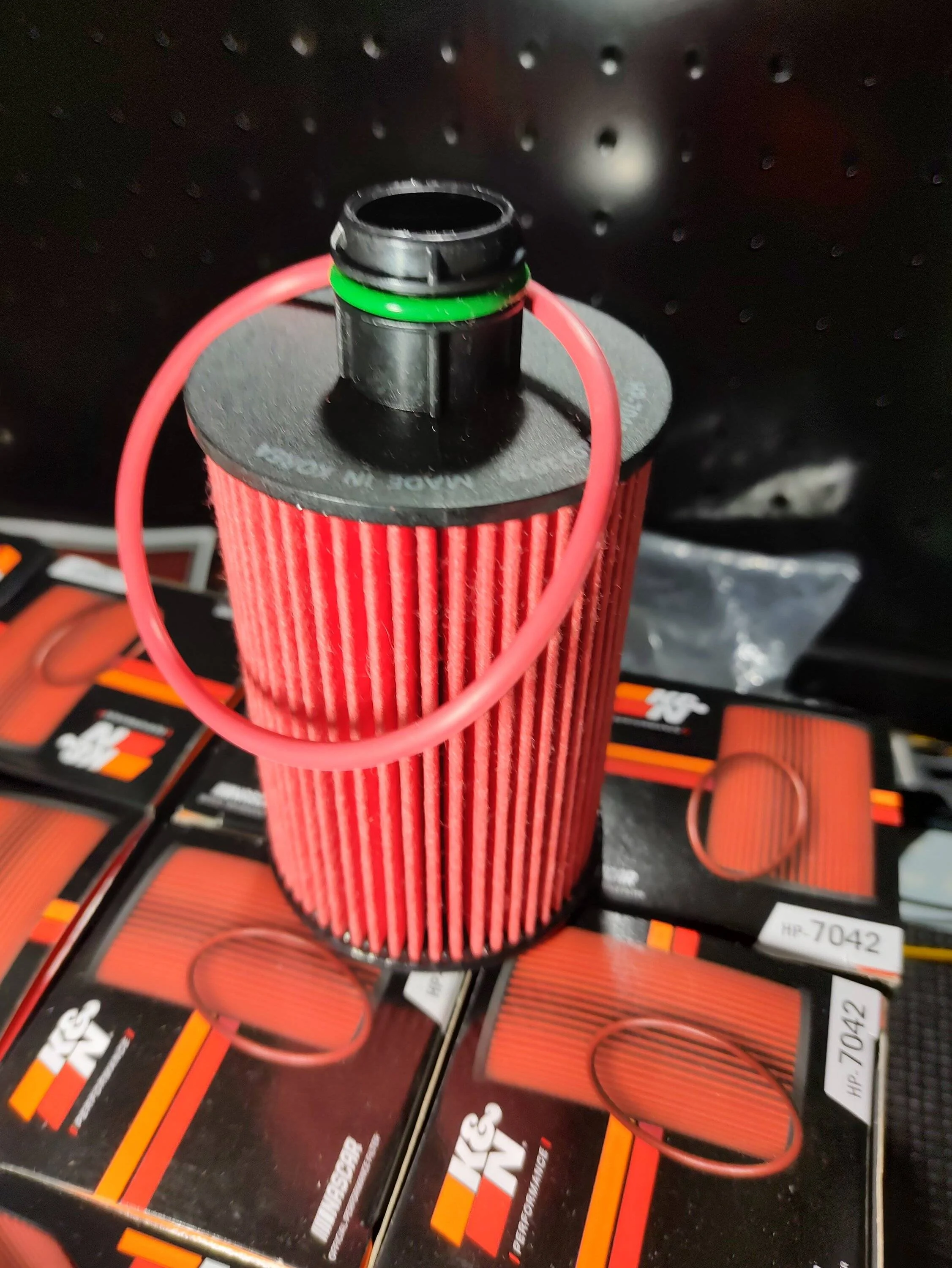

After a lot of people's recommendations, I decided not to skimp out on the oil filter itself. Turns out K&N makes an oil filter for the older 3.0s. Only $14 on Amazon!!

When I had first used the doorman oil filter cover, The k&n oil filters weren't snapping into place, like they are supposed to. I ended up gluing it in place with some industrial strength plastic glue, it held up just fine for that first oil change I did. But ended up having to purchase an OEM oil filter cap for the second gen EcoDiesel after making the Dorman one a one use with that glue.
The difference is a noticeable snap.

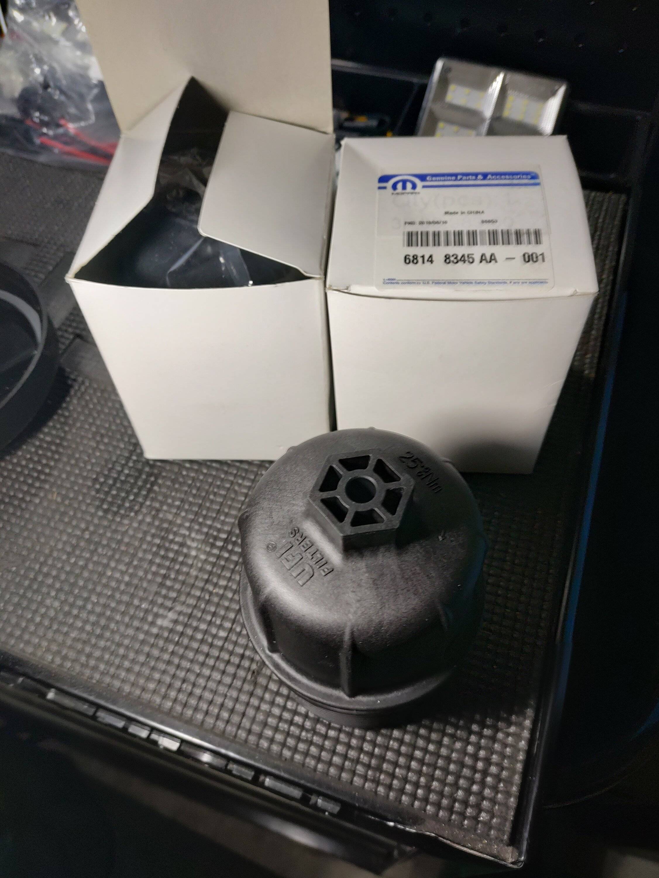

I thought I had bought two of them. Because if the tab inside goes to shit, you end up getting low oil pressure code thrown. So as it turns out I guess I bought three of them at the time one for the current use in the Wrangler EcoDiesel, and two more is backup in case that one breaks somewhere along the way. There's plenty of pointers on the Cherokee and the 1500 forums for how not to break them. It's very simple push it straight in and don't twist it, and then when you pull it out, pull it straight out and don't twist it. If you put it in on an angle or pull it out on an angle, you're likely to break the little tabs inside.

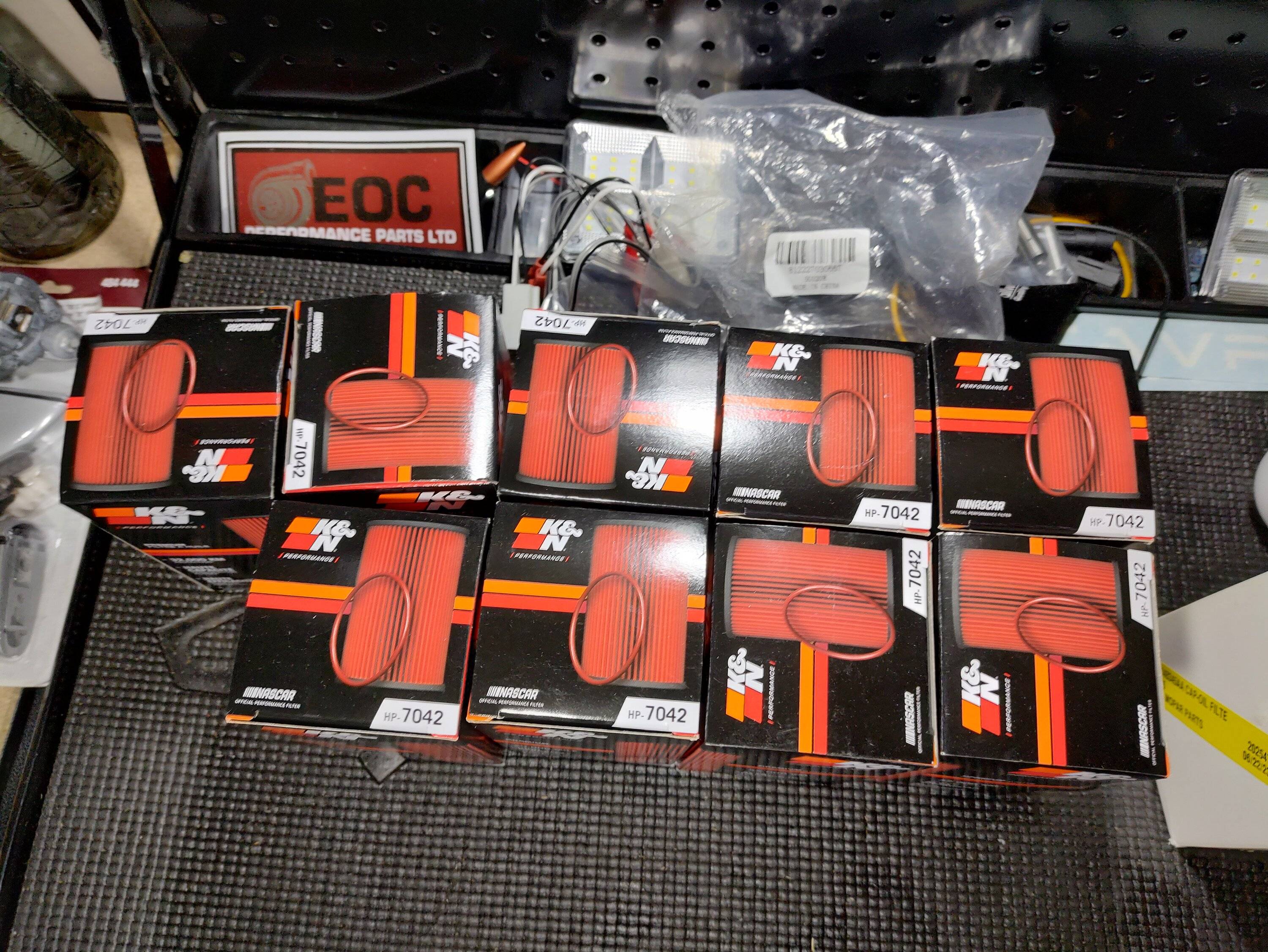

I purchased mine on Amazon because they are free shipping, they're normally $14.99 without tax, but a while back they had them on sale on Amazon for $10.99 each, so naturally I purchased 10 of them.

If you switch to a 2nd Gen EcoDiesel Oil Filter and Oil Filter Cap setup like I did, then yeah you only have to switch out the oil filter every oil change.
However the 3rd Gen EcoDiesel oil filters which come with our diesel Wranglers, do not have removable filters.
So you'll have to go out and purchase a 2nd Gen EcoDiesel oil filter cap.
(68148345AA)

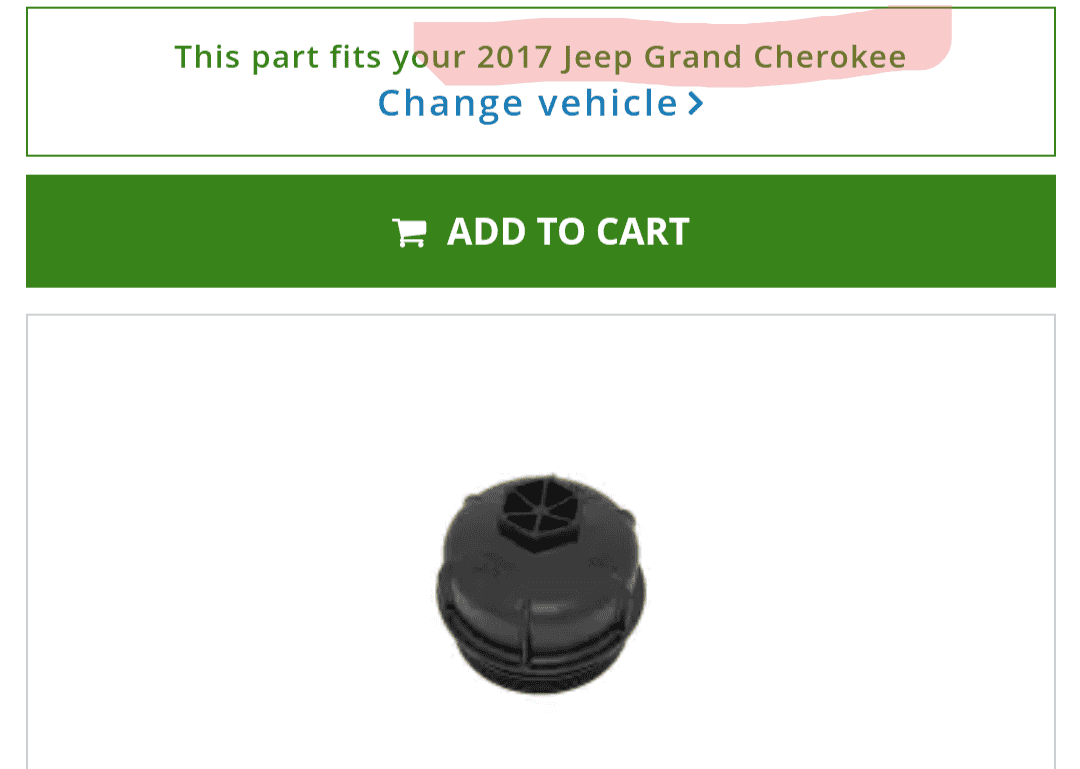

If you do order this from one of those websites where you're required to input what vehicle you have to make sure that it fits on your vehicle. Don't input your actual Wrangler. You'll need to input something like a 2016 RAM 1500 EcoDiesel (they have the 2nd Gen EcoDiesel's) or my personal favorite, 2017 Grand Cherokee Limited EcoDiesel.

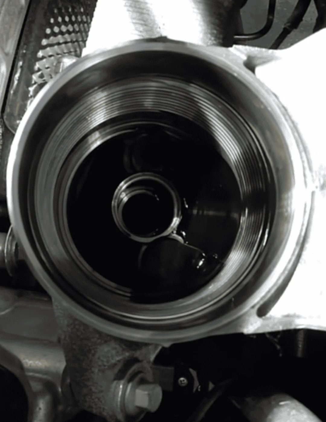

Here is the inside of a 3.6L oil filter housing that I stole from a different thread.
Jeep Wrangler JL Oil Filter Cover Thread Size??? Screenshot_20231029-004205~2

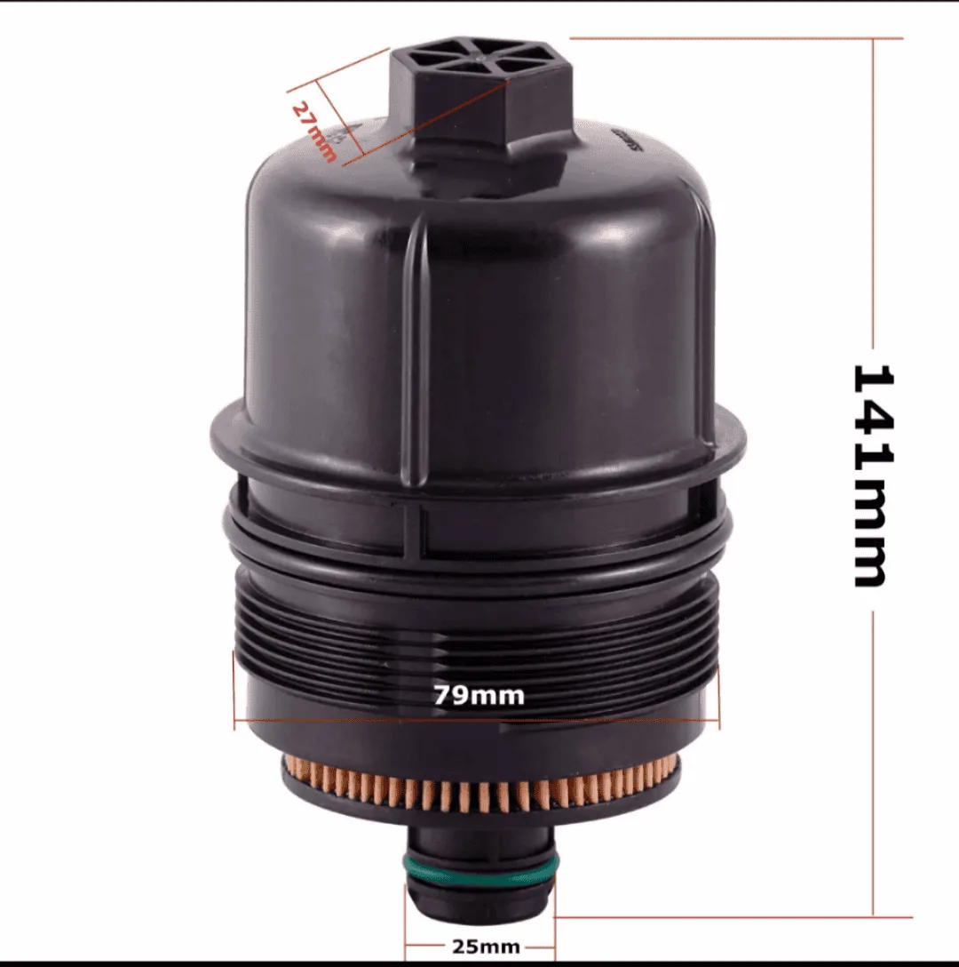

This is the inside of a 3.0 EcoDiesel oil filter housing.
Jeep Wrangler JL Oil Filter Cover Thread Size??? Screenshot_20231029-012504-500
Here is the thread width of the 3.0 3rd/2nd Gen EcoDiesel oil filter cap. 79 mm.

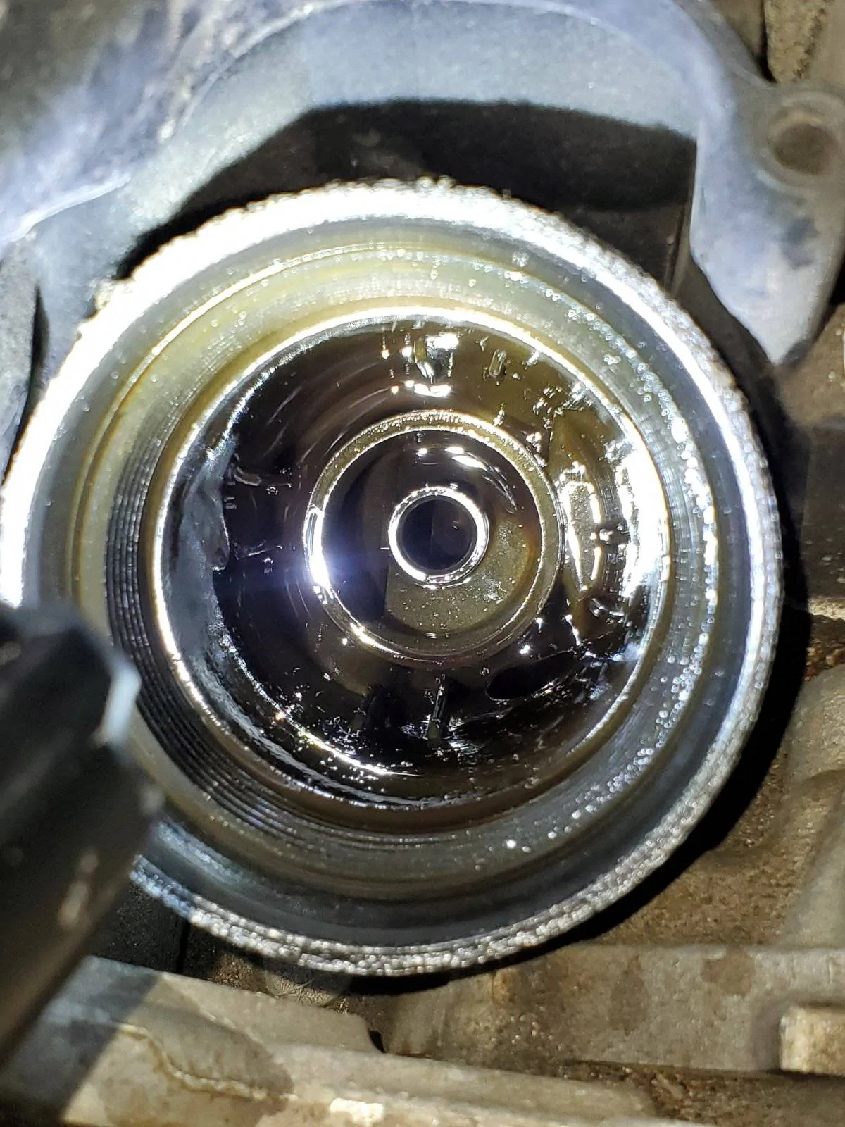

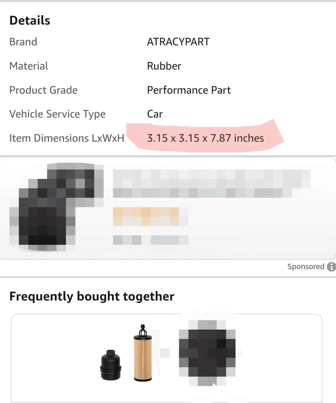

The filter cap for a 2020 Wrangler 3.6L is pretty much the same, 3.15 in comes out to 80.01 mm, which is the same fudge factor issue I was running into with the second gen EcoDiesel oil filters. Some places were saying 80 mm wide, others were saying 79 mm wide..

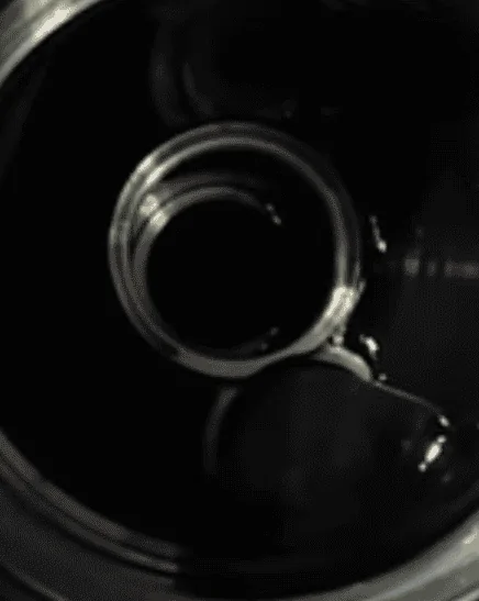

Now obviously important point for this is going to be the hole at the bottom being 25 mm wide.
Jeep Wrangler JL Oil Filter Cover Thread Size??? Screenshot_20231029-012839-584

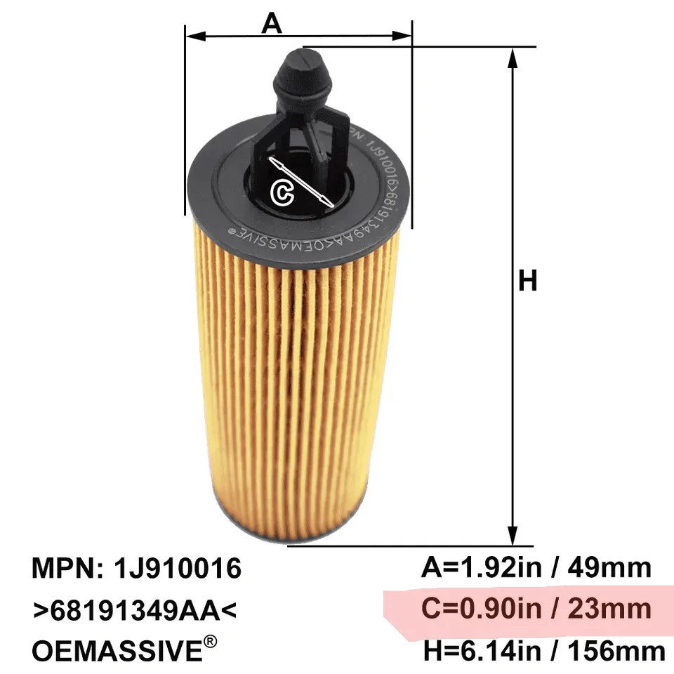

Measurement C in this case here is 23 mm wide which kind of makes me think that this isn't going to work, BUT...
Jeep Wrangler JL Oil Filter Cover Thread Size??? Screenshot_20231029-013039-187
Look how this guy here, not the lowest point on this 3.6L adapter, but the gasket right above it in that thicker piece. If the bottom piece is roughly 23 mm, that thicker piece might sit perfectly on top of the ~26 mm gap I have in the bottom hole of the EcoDiesel assembly...

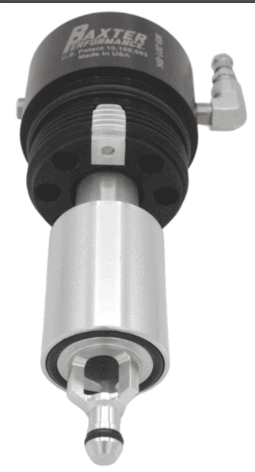

First step here will be purchasing a 3.6L oil filter cap, and subsequent oil filter. While I highly doubt the 3.6L oil filter will fit into the EcoDiesel oil filter assembly, it's still worth a try. At minimum if the cap fits, there's a chance the Baxter Performance adapter might fit.
