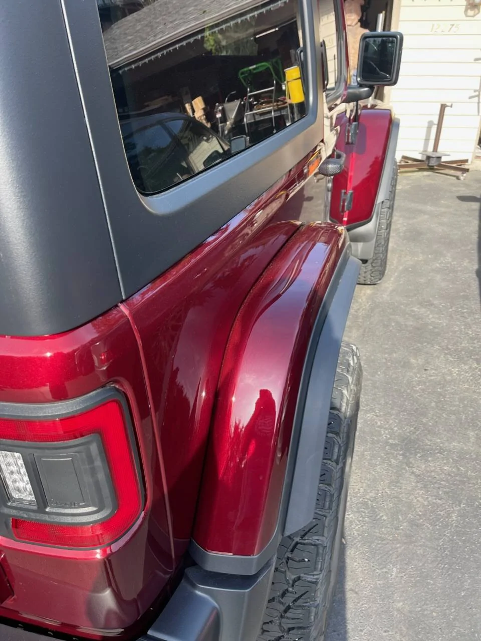

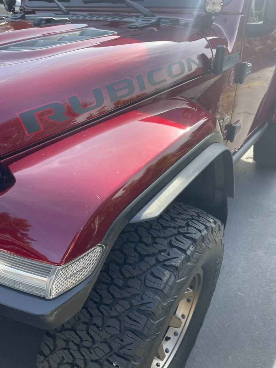

I’m currently running 315/70-17 on zero offset wheels on my JLR. I am very happy with a little poke vs. OEM. Did also install fender flare extensions to help cut down the spray on the rear fender and the doors.
Thanks for the pictures! Looks great! Any issues with rubbing?
