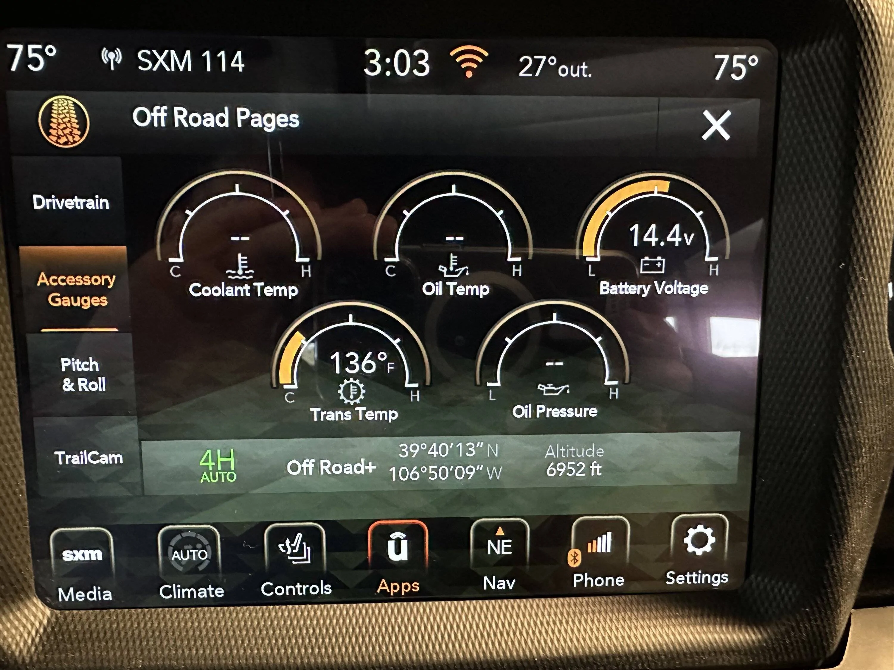

Original equipment, just stopped working.

Original radio or upgrade?
If upgrade, I had to leave the SGW bypass connected to keep them active. I believe with the tazer you just need to leave it connected to keep them active.
I removed the Tazar extension cable, plugged it back in and now the gages are all working.
Well on one hand at least its working but on the other something in the tazer is interfering.
Id love to help troubleshoot but I use JScan. Hopefully one of the Tazer users can give you some tips.
Good luck
Likely a connection issue. Those are very low voltage circuits. Any imperfection, oxidation, less than tight connection, you have issues.
