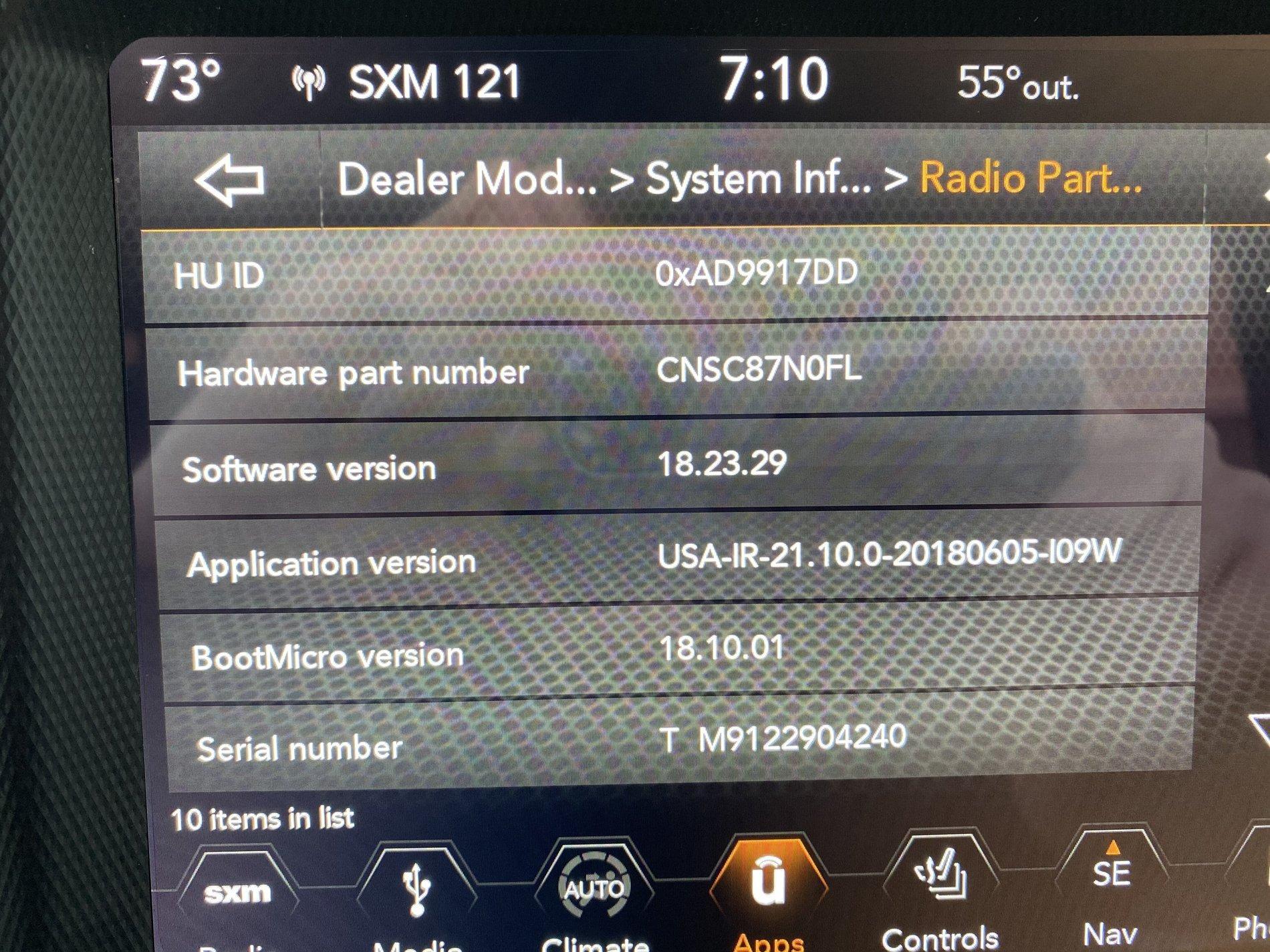

Here's my software version, do I need to update?
Jeep Wrangler JL Offroad Pages Drivetrain & Accessory pages not working IMG_2372
