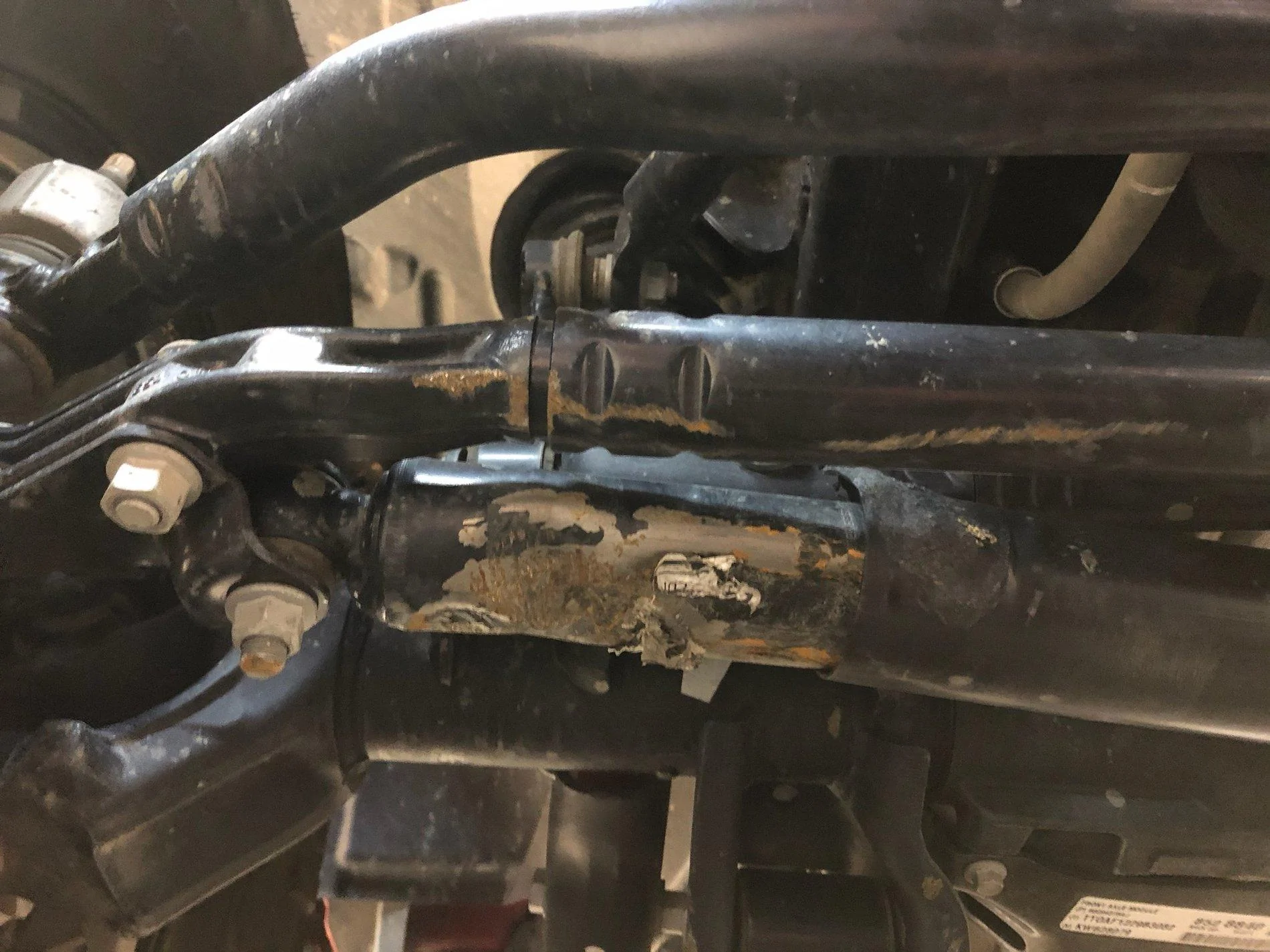

I want to start off with the Jeep is driving fine and I don’t feel any binding or difference in steering. The pic below shows the damage. Is this something I need to replace right away or can I wait?

I’d recommend replacing it sooner than later. If you were closer I have a pile of brand new ones in the shop. A relocation would be something good to start studying up on though.

well now is good a time as any to upgrade the stabilizer. :LOL: As for relocation, I know Metal cloak has one. Any others that are recommended?

Is there any real benefit to spending $200 or more on a stabilizer or is oem or something comparable to oem more than adequate?

As much as I love MC, their tie rod clamp to me leaves a lot to be desired. Steer smart and synergy have a nice relocation bracket and true tie rod clamp. For a stabilizer every build that leaves my shop has at a minimum a fox 2.0 Steering Stabilizer. I’ve been very happy with them and they are at an attractive price point.

Put a Fox 2.0 on it, my dealer even recommends them.

so this stabilizer?
https://www.quadratec.com/p/fox-rac...ce-series-ifp-steering-stabilizer-wrangler-jl
and this Synergy relocation kit?
https://www.quadratec.com/p/synergy-manufacturing/steering-stabilizer-relocation-kit-wrangler-jl
is there a big improvement to make it worth spending $66 more for this?
https://www.synergymfg.com/fox-jeep-wrangler-jk-jl-ts-2-0-steering-stabilizer.html?category_id=4980

Id suggest the first two and the 2.0 TS is a personal preference. My opinion it isn’t needed as the regular 2.0 is great.
@RubiRob has the synergy bolt too. Maybe he can weight in

Works great!

Thanks for this relocation info. I've got a Fox 2.0 waiting at home till AFTER i get my recall done and then I'll relocate and install the fox putting the "AE" on the shelf.
