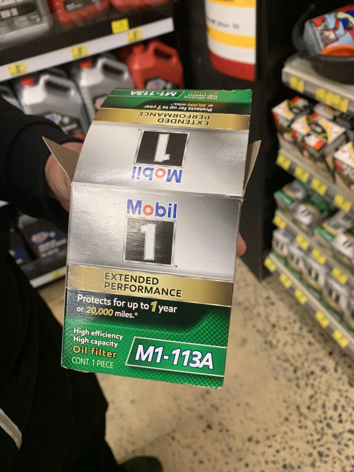

Just did my first oil change at 2k miles and used the pennzoil platinum full synthetic SAE 5W-30 (SN+) 5 quarts with the mobile 1 M1-113A oil filter instead of mopar oil filter and engine is running great! For those want to use oil filter other then OEM I attached a pic. Btw my used oil was really dirty and black for only driving 2k miles. I was surprised and wonder if anyone else had the same problem?

You can not see oil quality by looking at it. All oil is dirty and black after use. You have to do UOA to see if there is an actual issue. You likely do not have a problem. Cut open a used filter and look for a bunch of metal. That would tell you something isn't right. Or send off your oil for UOA and get the real story.
