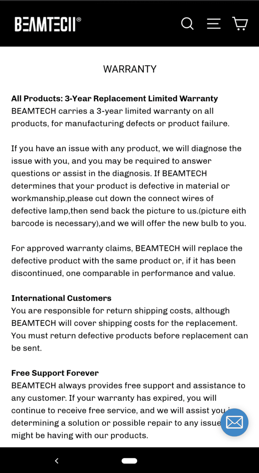

I did just check beamtechs site and they supposedly have a 3 year warranty on all their products, I guess that gives me some confidence in trying their bulbs for a bit.

(Also, just want to point out that BeamTech's warranty page is copied word-for-word from Diode Dynamics; they even missed a DD under "Negligence." They may still stand by it; unfortunately, we haven't heard any customer feedback to share there. Just FYI for y'all!)

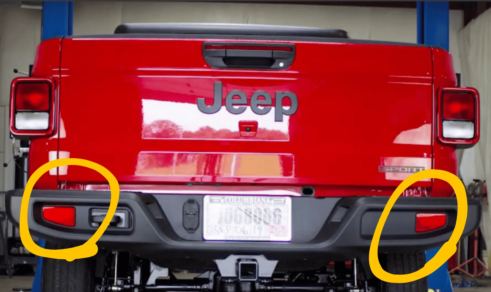

Isn't the JL rear bumper reflector (that your product would replace) different than the JT? Or are you guys coming out with products for each?
I believe they are different for the JT yes, we are working on something for the JL, but may have JT in the future!

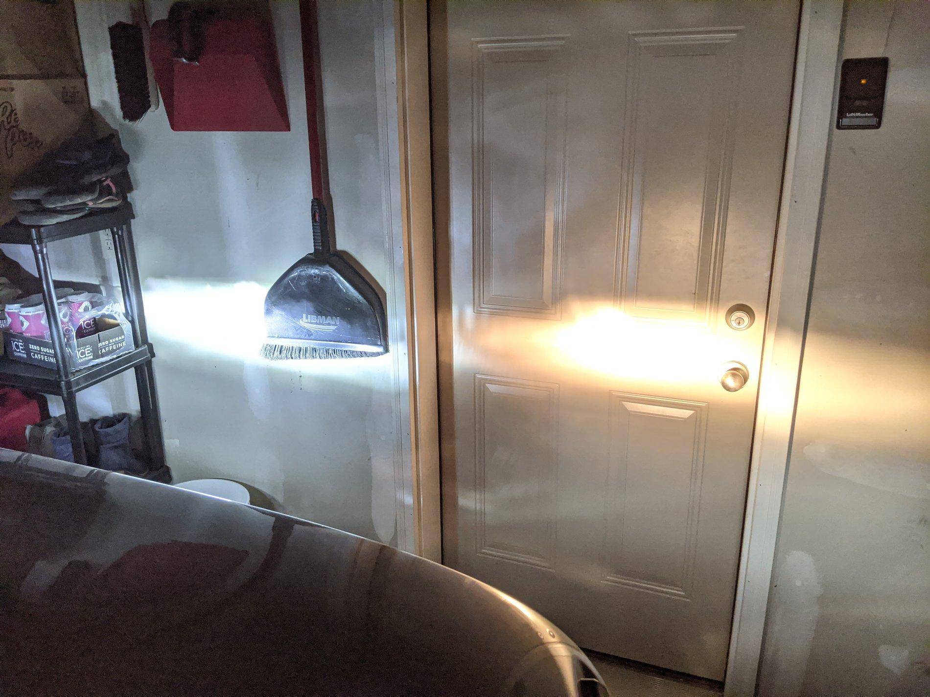

I got the beamtechs installed last night. As others mentioned, you will absolutely need to aim them down a bit from stock. I did a night test drive without aiming and got a few flashes from other drivers. Also noticed a lot of reflection off road signs before aiming them down, so I knew the low beams were too high. After aiming down a bit and a second test drive, no more flashes from others and still have much better road visibility than the halogens. Please don't be a jerk and leave them aimed high and be blinding everyone as you drive, it takes less than 5 minutes and just a screwdriver to adjust them down (extremely easy) . As far as install, they can only be installed in 1 orientation due to the tabs on the light, so can't get them clocked wrong. Also, you don't need to use the orange rubber o-ring gasket that comes on the bulbs since there's already a gasket on the headlight housing. I'm impressed for $40, if they last 2 years, I'll be happy. Quick pic below of the difference in color/brightness.

Yes, I mentioned the need to aim the headlights lower in my earlier post. The factory halogen bulbs were so dim you couldn't tell they were aimed too high.
