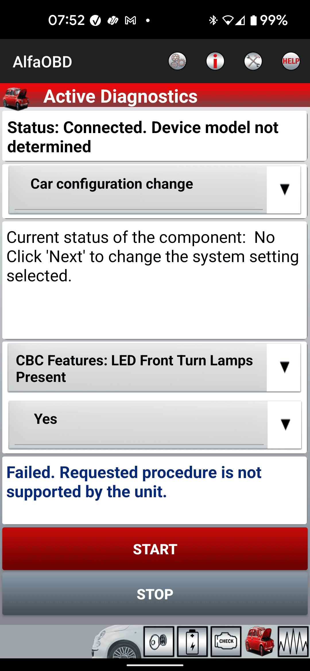

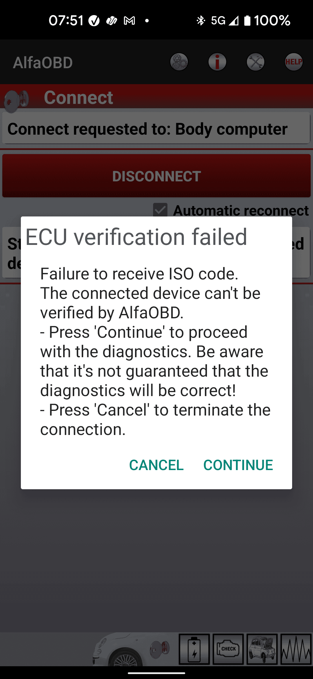

I had a $15 ELM327 OBD reader that worked perfectly with a few different apps to read codes, but didn't work at all with alfaOBD, wouldn't even connect. Bought the OBDLinkMX+ and had it working first try to connect. However, I do get an error when connecting to the Body Computer (and others) with ECU verification failed. I have a '22 Rubicon. Is this too new for alfaOBD? I just downloaded version 2.2.8.0 from the play store
I also have the ECRI SG bypass installed. When I ignore the alfaOBD error and go on, I'm not able to set the item that I want - trying to update the turn signals to LED. Appreciate if anyone can offer any advice. Thanks!
