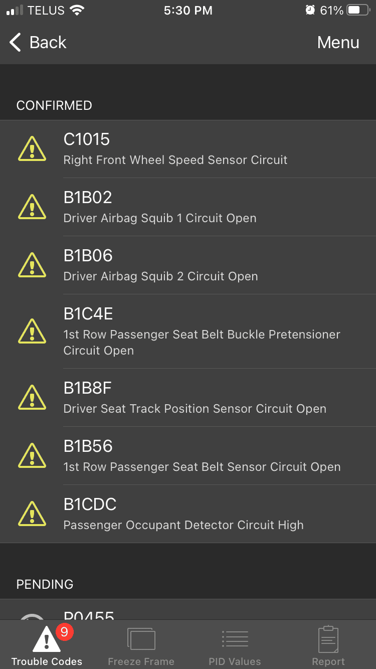

We’ll I went with the OBDMX+, very slick it instantly showed my right front wheel sensor error, but I’ve got every airbag and seatbelt code, what the heck!!! Lol!
Before I start buying all new clock spring and Seat belts is there somewhere I should start? Maybe this is a new thread?
