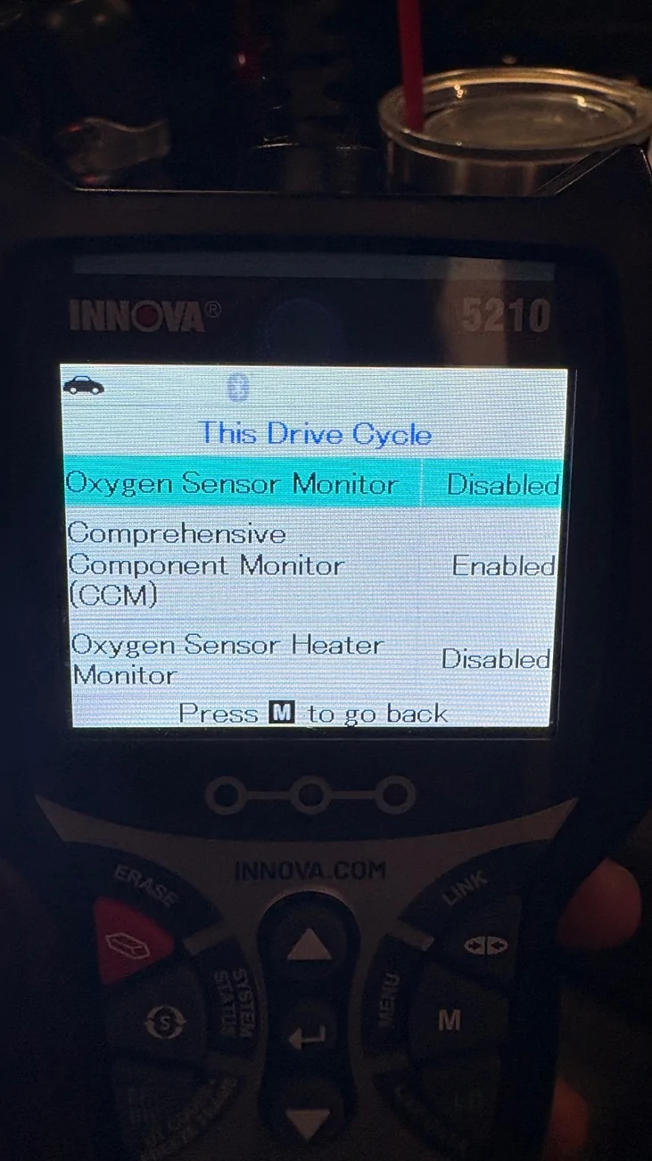

Had a similar issue where it would not clear codes for inspection after a battery went dead. This worked.

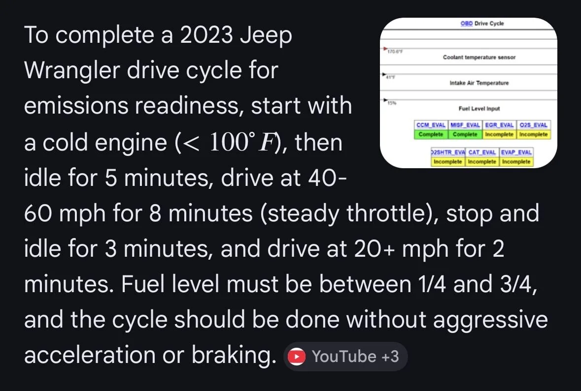

Same thing happened with my '21 JLR (manual) last fall. Had auxiliary battery replaced over the summer and failed emissions test in October after driving for over 1000 miles.
This is what I did to clear it after my Jeep Dealership essentially told me the same thing as you've posted...to just keep driving.
I performed this Drive Cycle to clear the O2 monitor:
1. Cold Start
2. Idle (parked) for 5 minutes.
3. Drive to 35 mph and come to a complete stop.
4. Get on a highway and drive at 55 mph for 3 minutes shifting into 6th gear (manual)
5. Decelerate to 20 mph (no braking, no downshifting)
6. Accelerate to 55 mph for 5 minutes. (I did shift into 3rd gear and back up to 6th for this step)
7. Decelerate down to 20 mph (no braking, no downshifting)
8. Park & Idle for 3 minutes.
9. Turn off engine for 3 minutes.
This worked for me on my 1st try.
Here's a link to my original post:
https://www.jlwranglerforums.com/forum/threads/21-jlr-failed-nys-inspection-emissions-test.159164/
Good luck!!
Let us know if this works for you.
