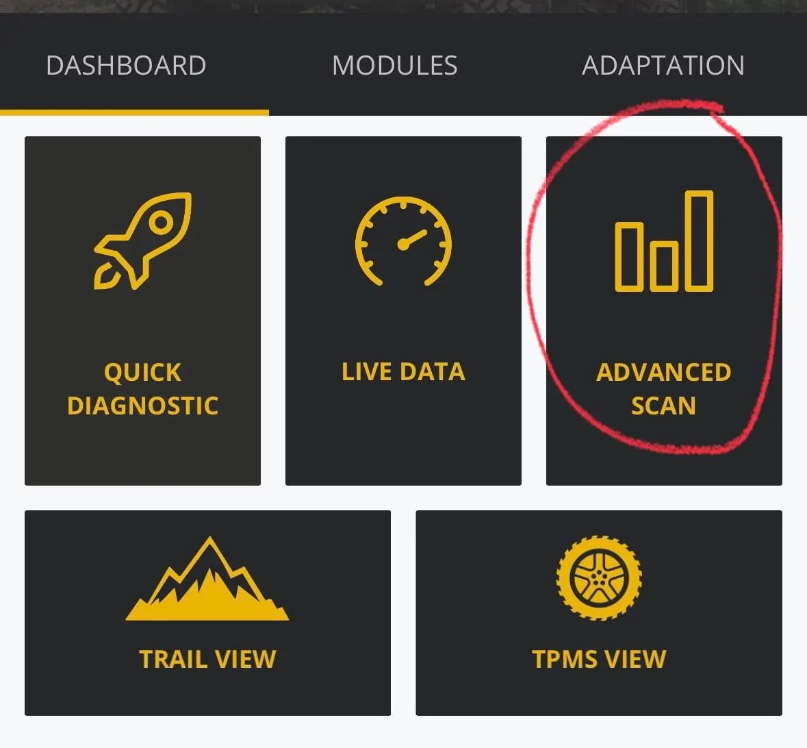

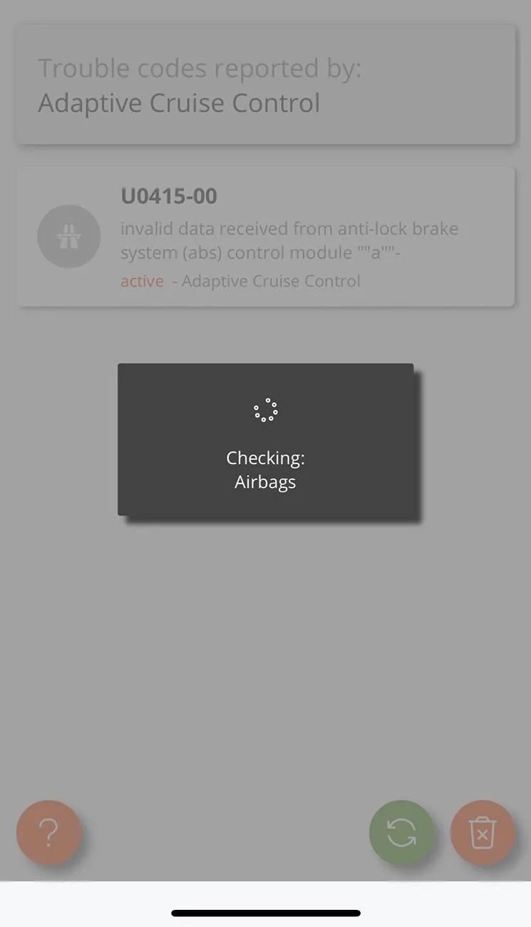

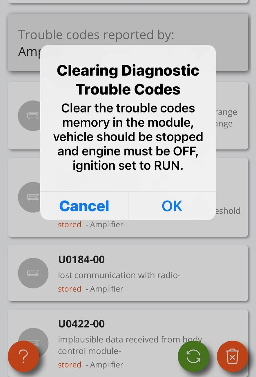

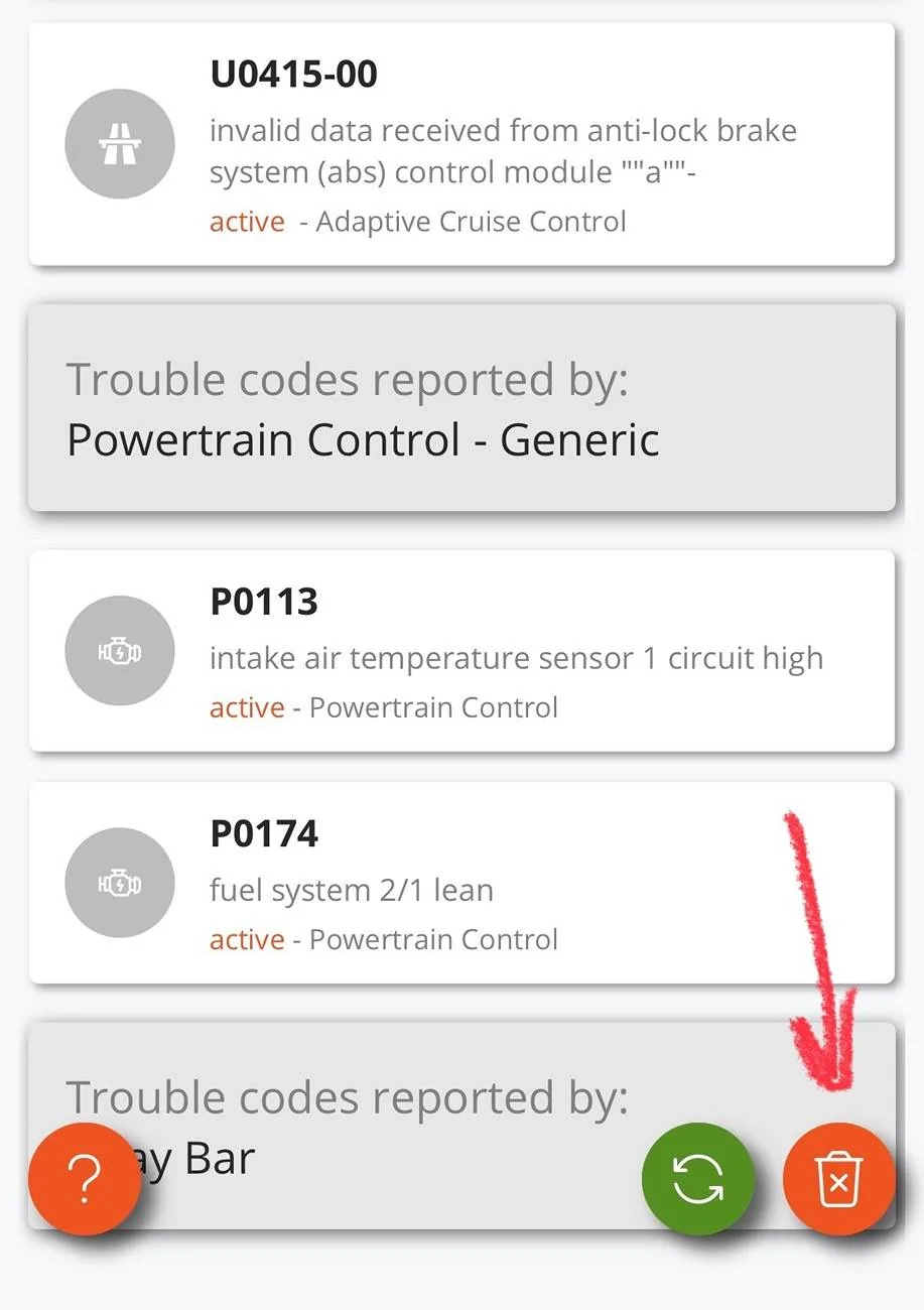

I use JSCAN but I’m not an expert. Here is how to clear any DTCs
