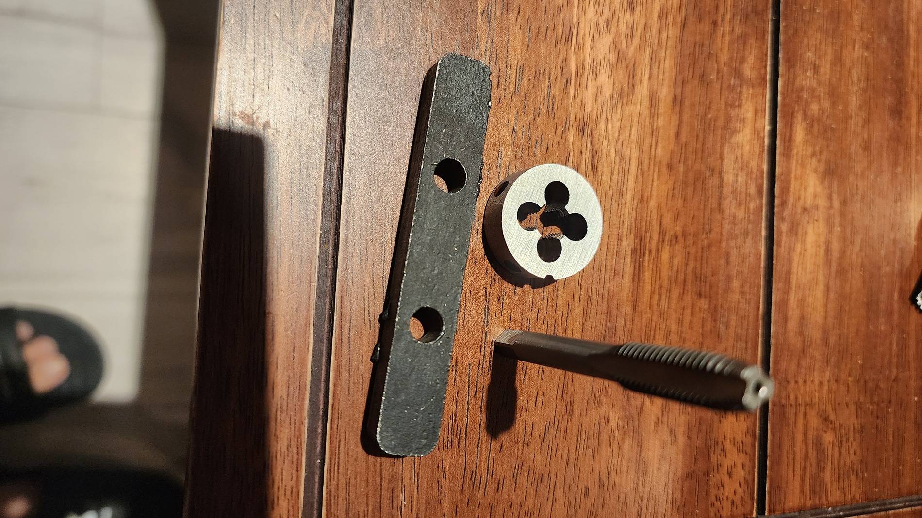

I recieved a roofrack, and one of the parts (connects 2 rails together) arrived unfinished. It's missing threads.
I got a full refund, so it's basically a free (actually got paid for it as I paid 50%), so would like to correct it myself.
I purchased a thread tapper (made sure it has the same threads as the bolt that's suppose to go into this piece, and disntance between the threading), but unsure of how to actually do it.
Not even sure what the circle object with the 5 holes in it with threading is.
All the videos I've found show different tools, which i do not have.
I'm assuming I'll need some kind of vice to hold it as well, which i don't have.

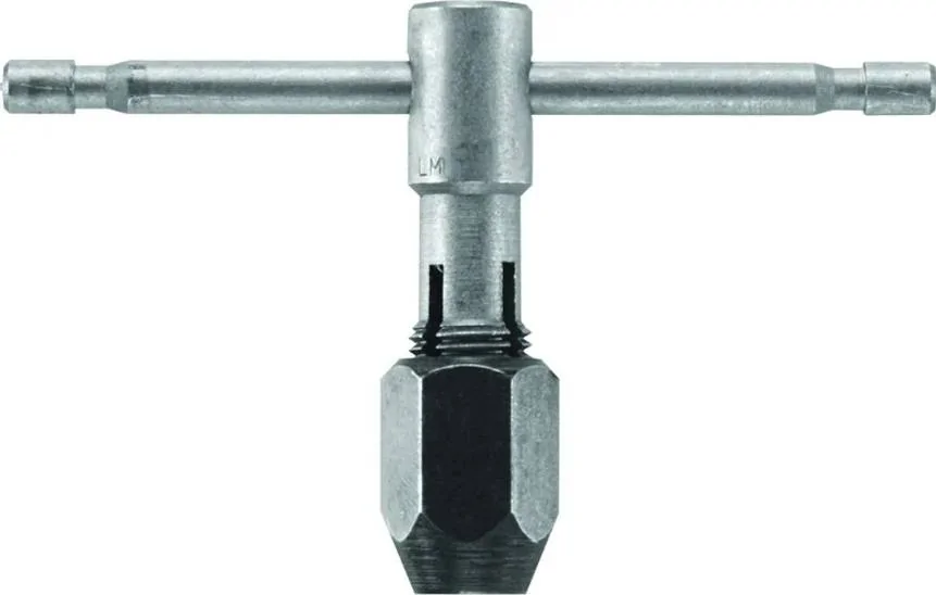

The "circle object" is a die, for cutting screw/bolt threads. It's unnecessary for your project.
You need a wrench/handle for the tap, likely 1/4".
Oh ok, so don't use a drill/driver? Haha!

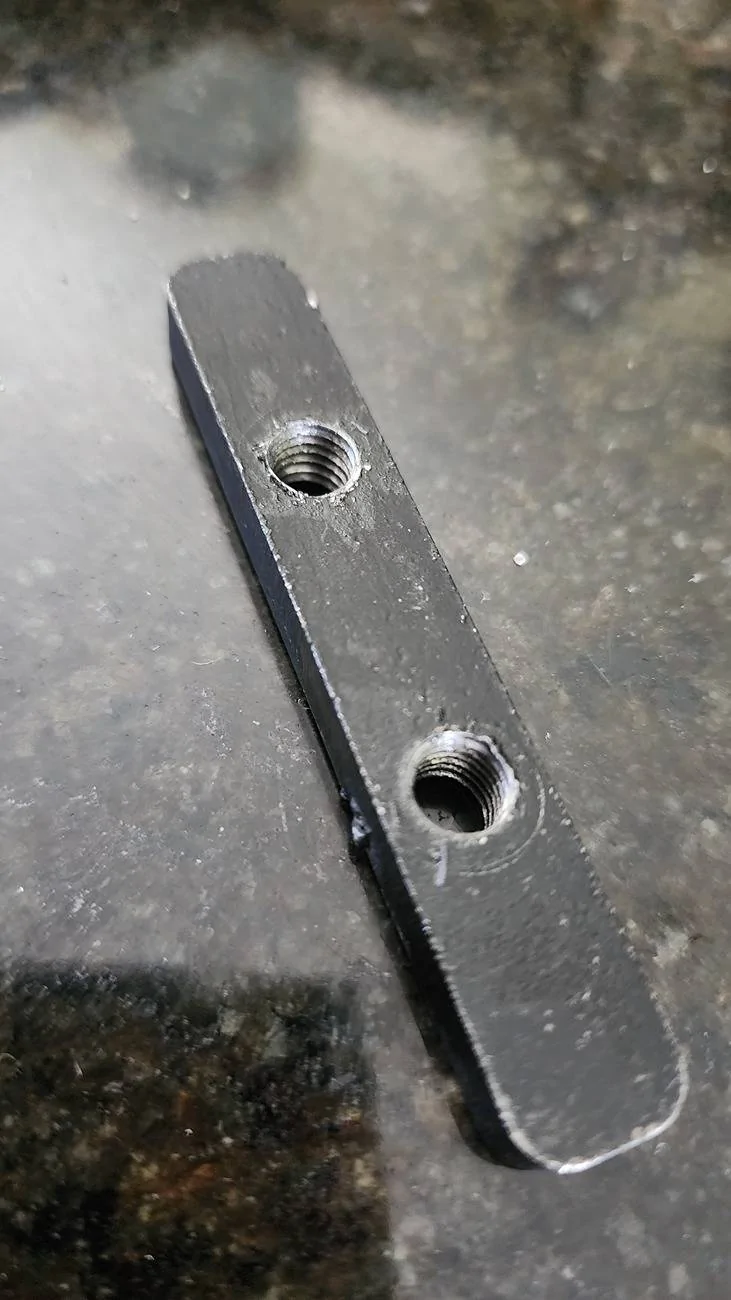

Got my T handle and drilled into the bar.
Took a few minutes, used wd40.
The bar is magnetic, so do I spray something on the freshly made threads?

Nice! Put a little grease on your threads and you should be g2g!
