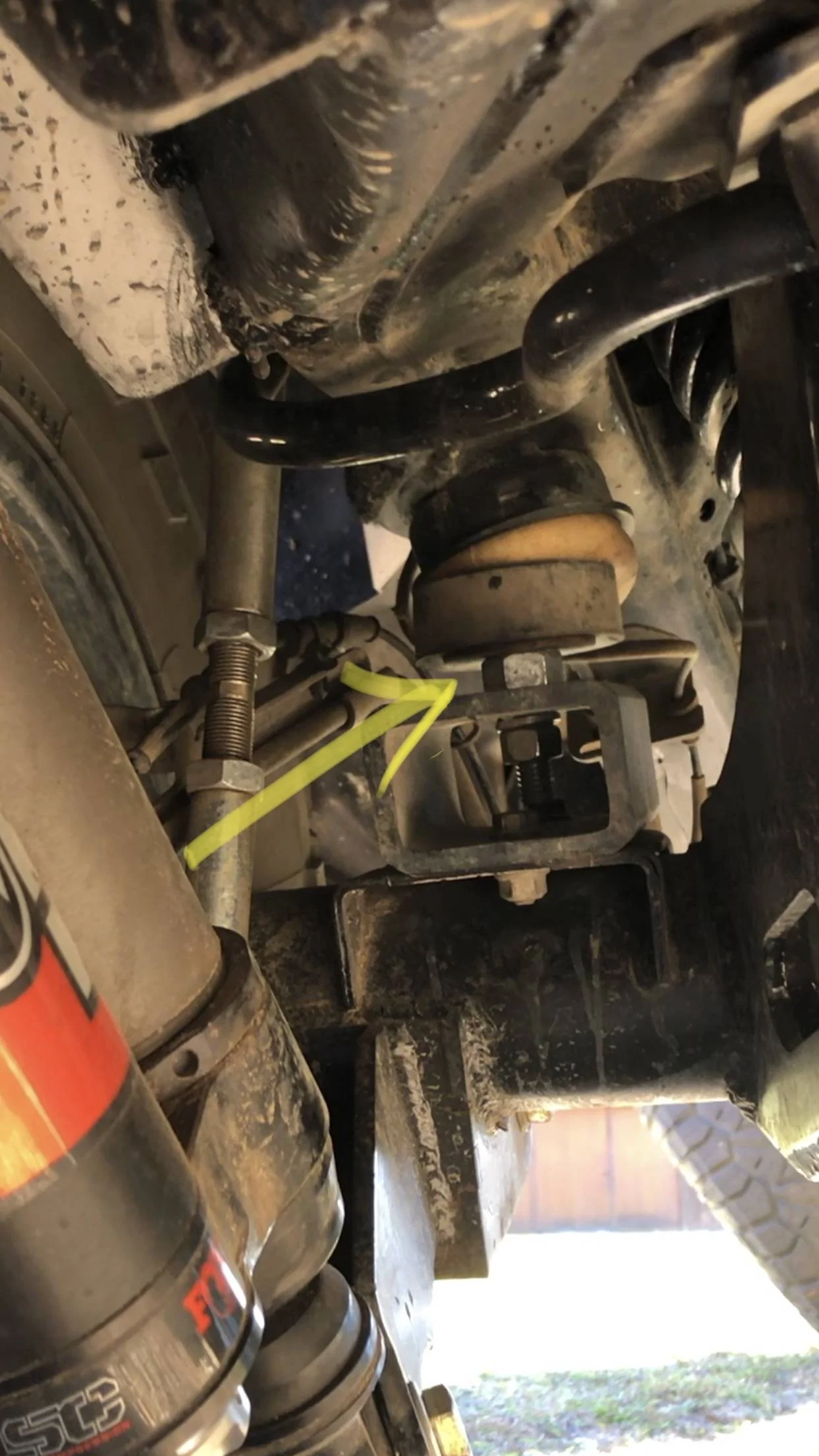

This thread learned me something…..teraflex has 1/2” bumps, I’ll probably snag me a couple, even though my 3/4” nut is exactly a 1/2”…….. you can laugh, I have been for a couple years,…?……you can take the boy out of the country but you can’t take the country out of the boy……...? …… @Tredsdert would be proud…..?

This thread learned me something…..teraflex has 1/2” bumps, I’ll probably snag me a couple, even though my 3/4” nut is exactly a 1/2”…….. you can laugh, I have been for a couple years,…?……you can take boy out of the country but you can’t take the country out of boy……...? …… @Tredsdert would be proud…..?
Shit, looks like it works to me!
I came across that pic when I was researching bump stops. If it works, it works!
