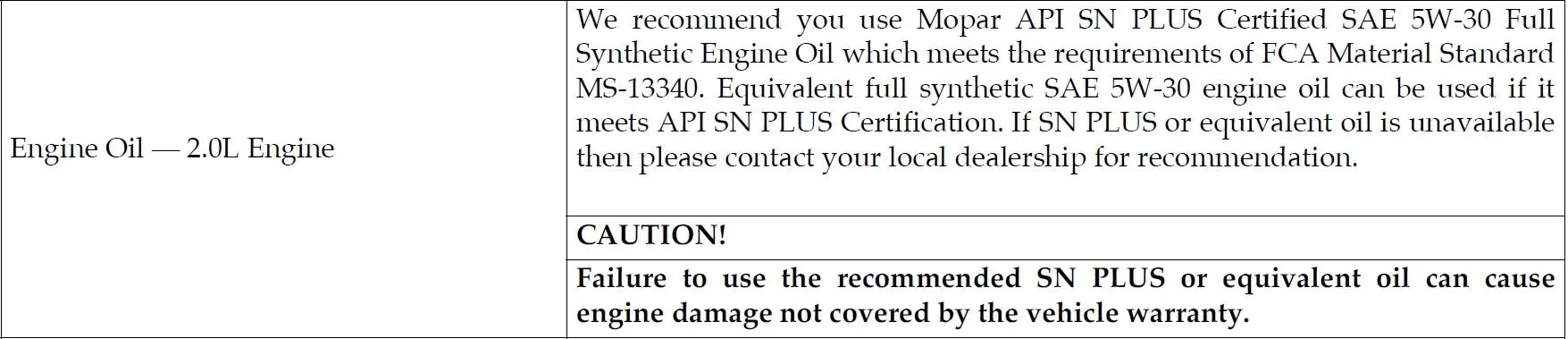

Do you really know the above statement to be a fact? Most of the discussions on this forum that I've seen believe the factory fill is Pennzoil Platinum 5-30.

Just had to pipe in on this one, dig up a old thread. I too went to dealer and was told the tattle on startup as normal, and to be on the record I would never let those fly boys change my oil. They lube the gasket and just screw on the EMPTY filter, I fill them. They claimed to have went out in the lot and started several of these engines and since they all made the same noise punched it's ticket as being normal. Now where going to talk oil filters and drain back. Remember they want SN Plus rated oil and for good reason, the extreme conditions it's subjected to in these engines especially pushing max boost of 28 lbs we got some real hot conditions and the stock filter has a basic rubber drain back valve in it. Coming straight from the dealer I unscrewed the filter and the oil just pored out like it was in a drinking glass, the valve didn't work. We all know silicone rubber stands up against heat way better then plain old rubber so I drained everything and bought the STP extended life S10060XL with the silicone anti drain back valve and Havoline Pro DS rated SN PLUS and the startup noise is almost none existent. The rubber valve in the stock filter isn't up to the task. I've been a auto tech my entire life and bought the shop I worked at for 37 years and the noise sounded like what you would hear during a oil change on the first startup. I have tried all oils in my gas powered toys and cars and the Pro DS by Chevron is what they all like running smoother and quiet.
