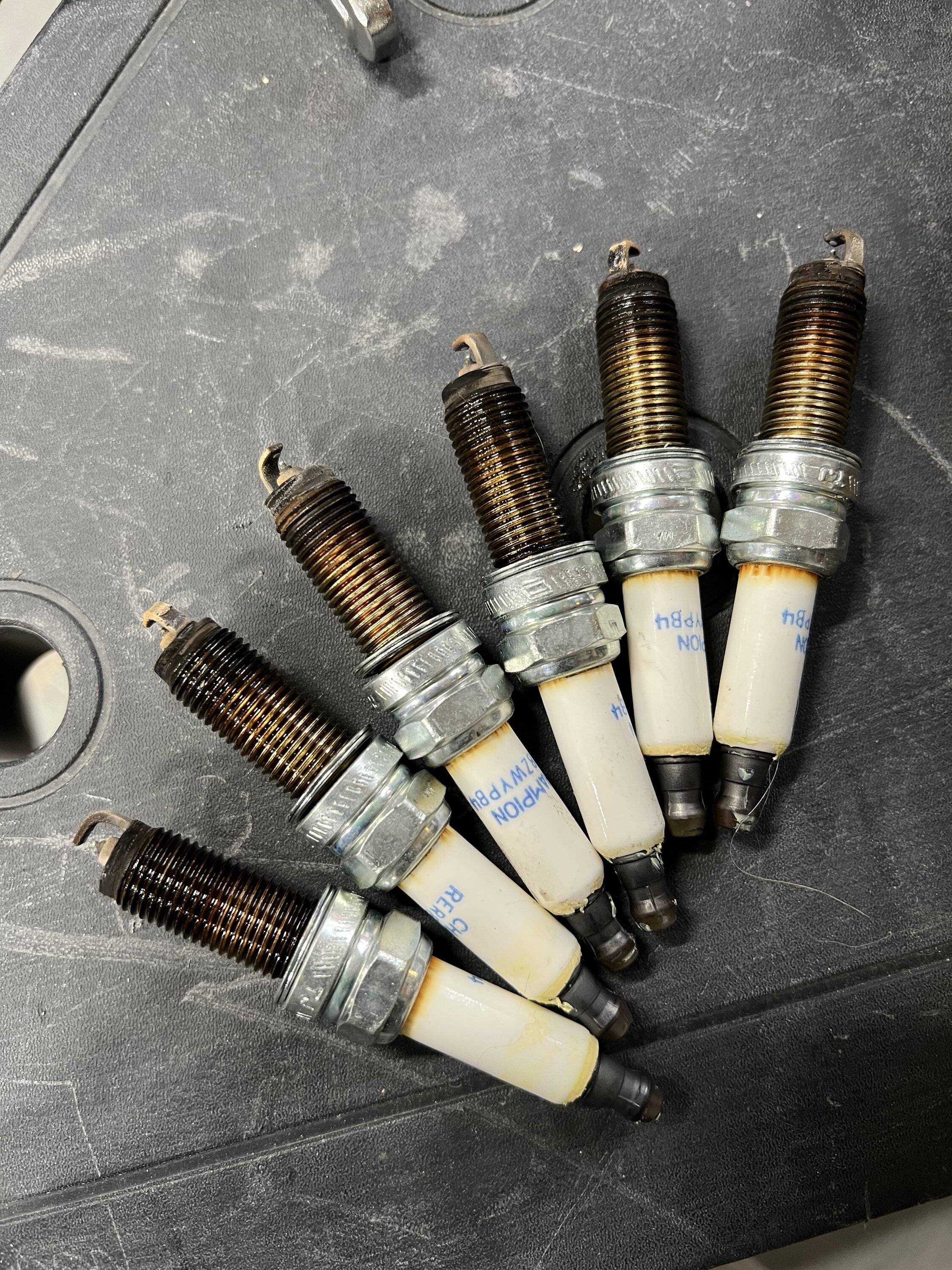

did the oil change less than 1K miles ago. There was a slight glitter look to my oil… but I was essentially turned away from a dealership twice because there wasn’t a smoking gun. Just have a misfire in 5 and of course they didn’t hear a knock or just ignored the fact that I mentioned it. Have a dealer appointment with a different one on Tuesday to have them look at it. Will tell them to open it up regardless if they get the sign off from JEEP or not. Have 2 months left on my powertrain warranty so it’s now or never… hoping for a new engine at this point… if they would’ve done any due diligence or cared they probably could’ve saved my engine… but it’s been 3+ months now and I drive it daily.
I had the exact same scenario, glitter in the oil , noisy on start up ignored by 1 dealer completely and after a cam replacement at another dealer too "fix" the problem
it's in for a complete engine replacement with 13000km . Good luck and don't give up I ended up recording every time I stared it for evidence. A real pain in the ass but that's ultimately what got me a engine replacement.
Thanks and that’s great that you’re getting a new engine.
I am hopeful since they looked slightly concerned when I had shown them a picture of my spark plugs. The other dealership was like “oh… okay” and proceeded to not really care. Here is a pic of my oil fouled spark plugs at 42k.
