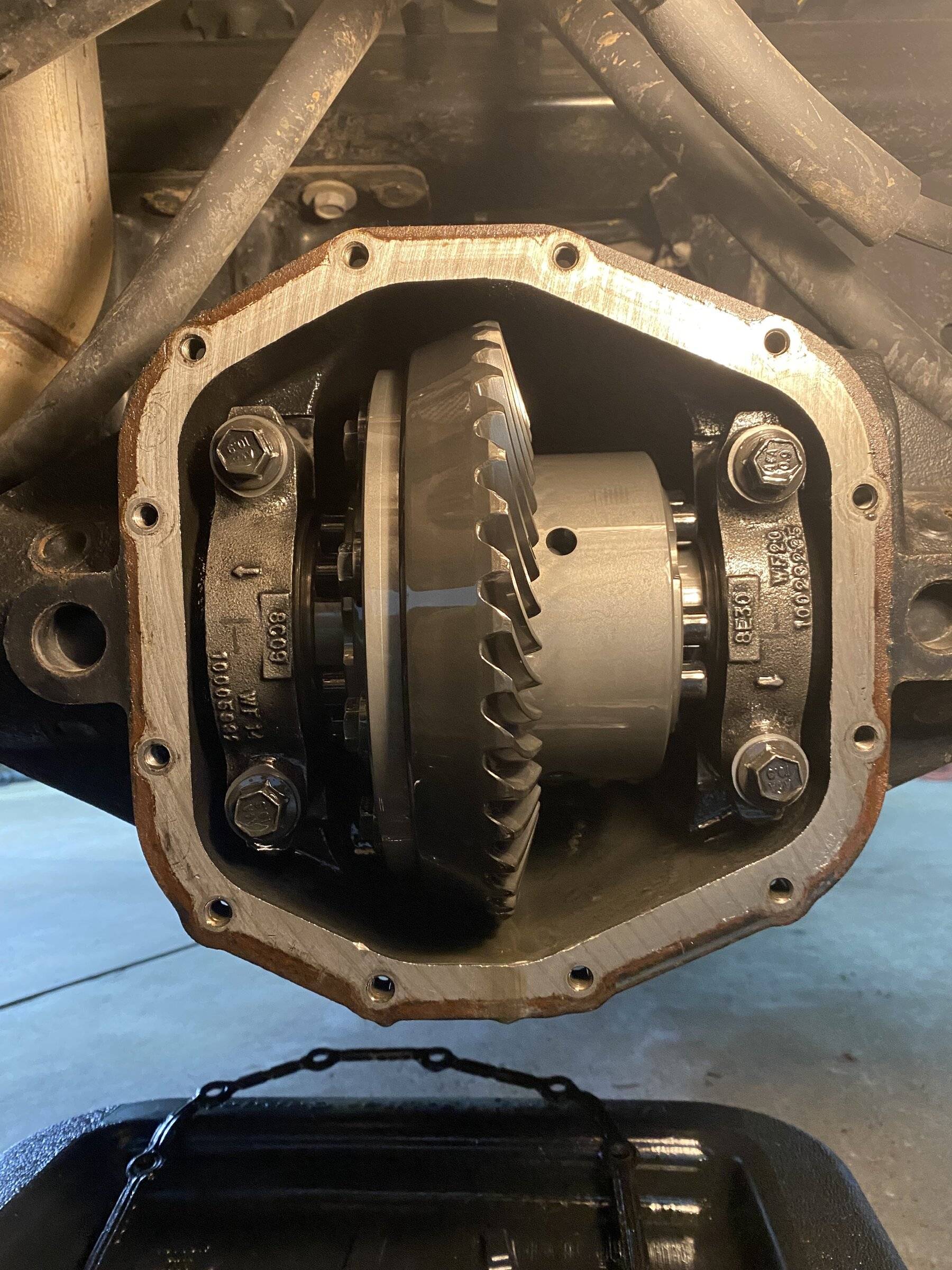

Two years and 30k miles later, it still works well. The difference is noticeable especially in the mud. When I changed diff fluid after about 10k miles it was very clean. Least year I also added manual OX locker to the front axle.
I would do exact same setup if I was doing it again.

Yes I have M186 in the front. I have Rusty's adjustable track bar which I added after installing 2 inch Mopar lift. I did not see any interference.

Aha, thanks! I'm stock height so the OEM track bar would hit. Looks like Rusty's is curved, which probably makes the difference.
