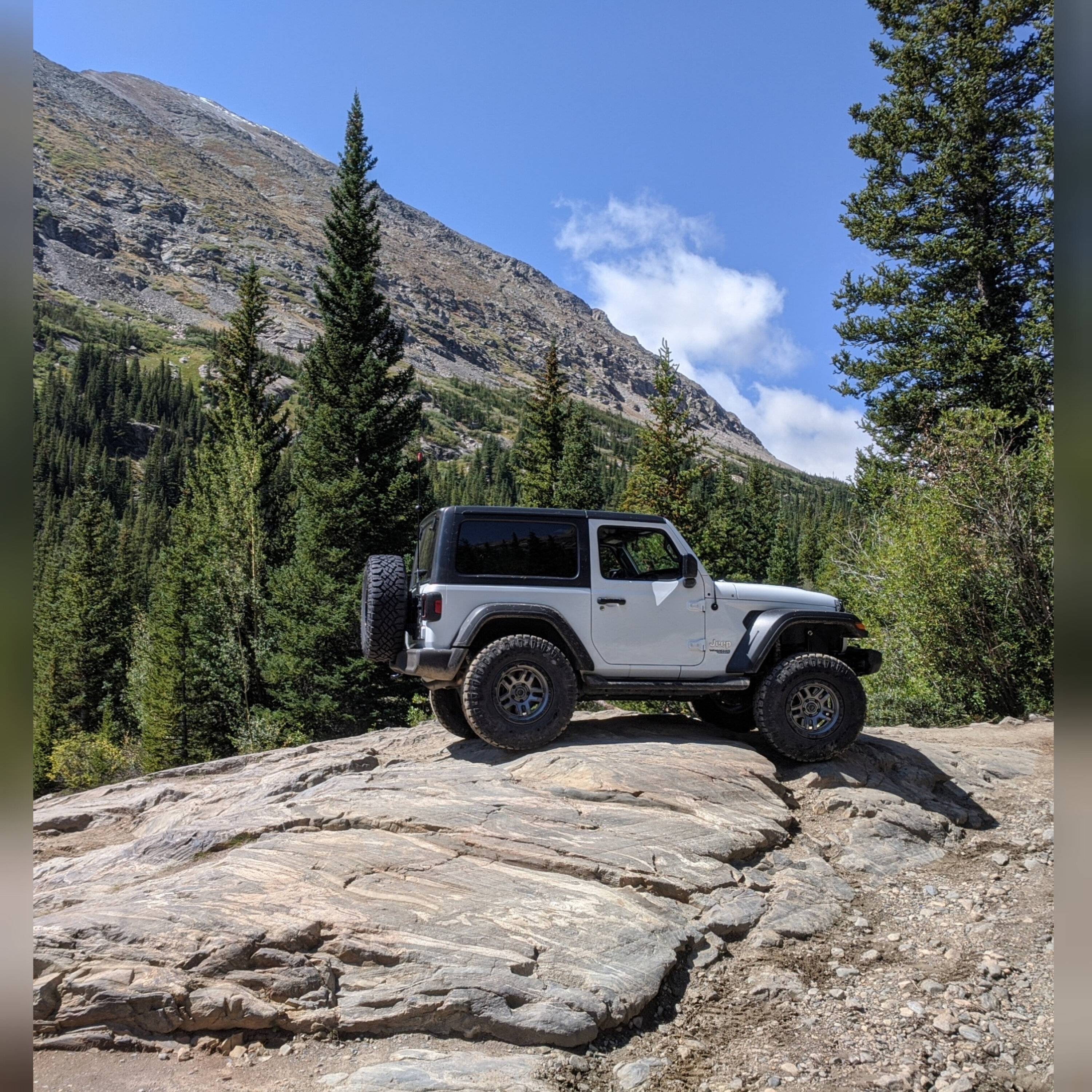

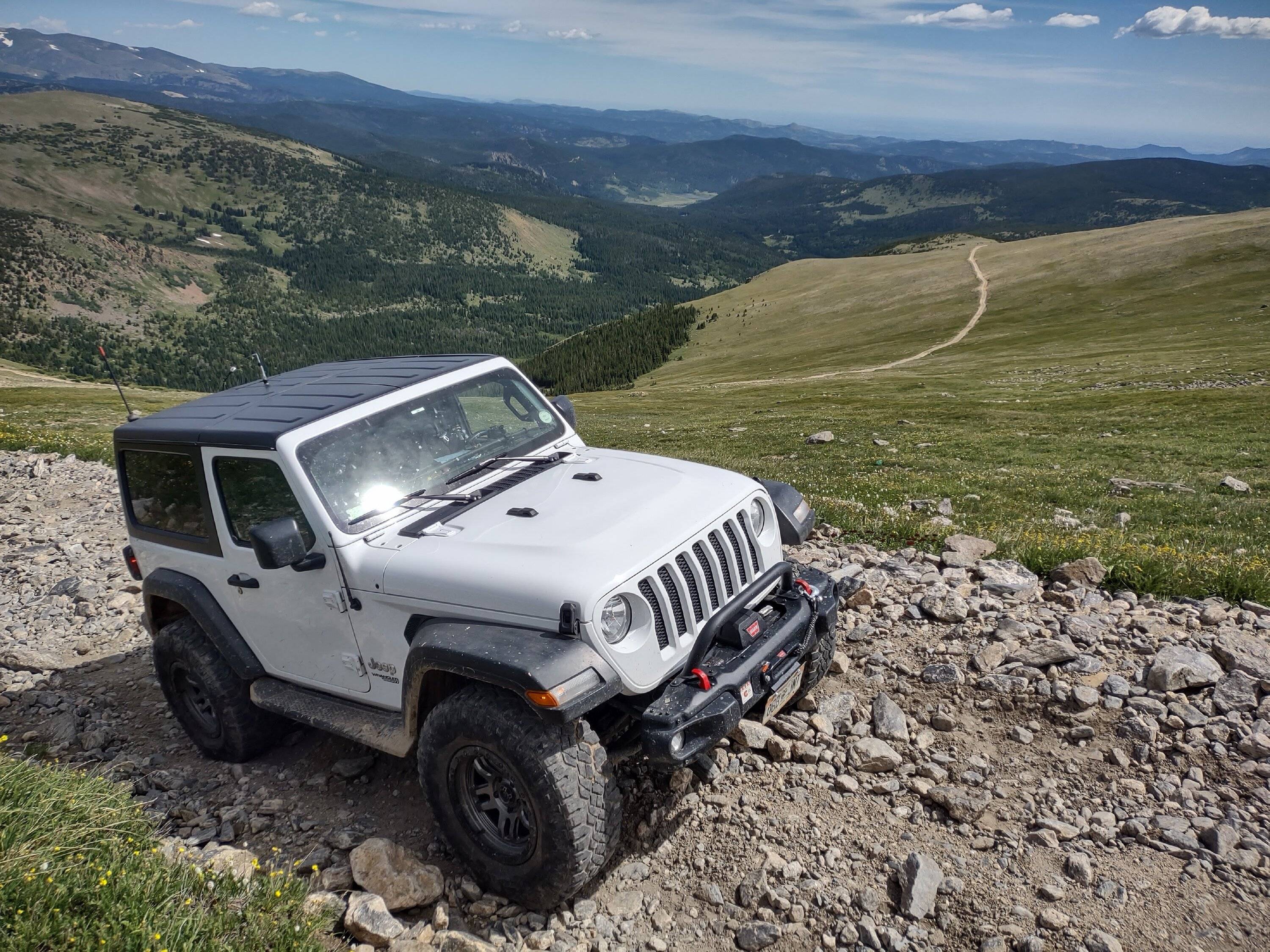

Jeep Wrangler JL Newbie questions about lifting IMG_20230526_121300793_HDR
Jeep Wrangler JL Newbie questions about lifting IMG_20230325_082957415_HDR
Jeep Wrangler JL Newbie questions about lifting IMG_20230727_110720633_HDR
Jeep Wrangler JL Newbie questions about lifting InShot_20221126_102151914

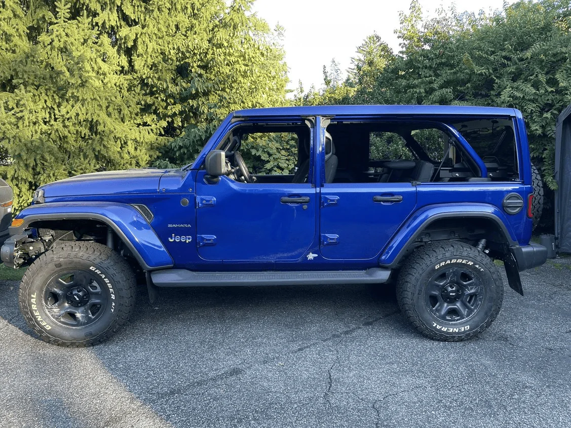

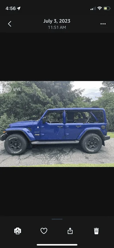

I did something similar to my own Sahara - 2.5 lift with Rubi-sized wheels and tires.
Oh, and that price is ridiculous... run away from that place and never look back. Seriously.
Here is a before and after the lift of my Sahara, so you can decide if you want it:

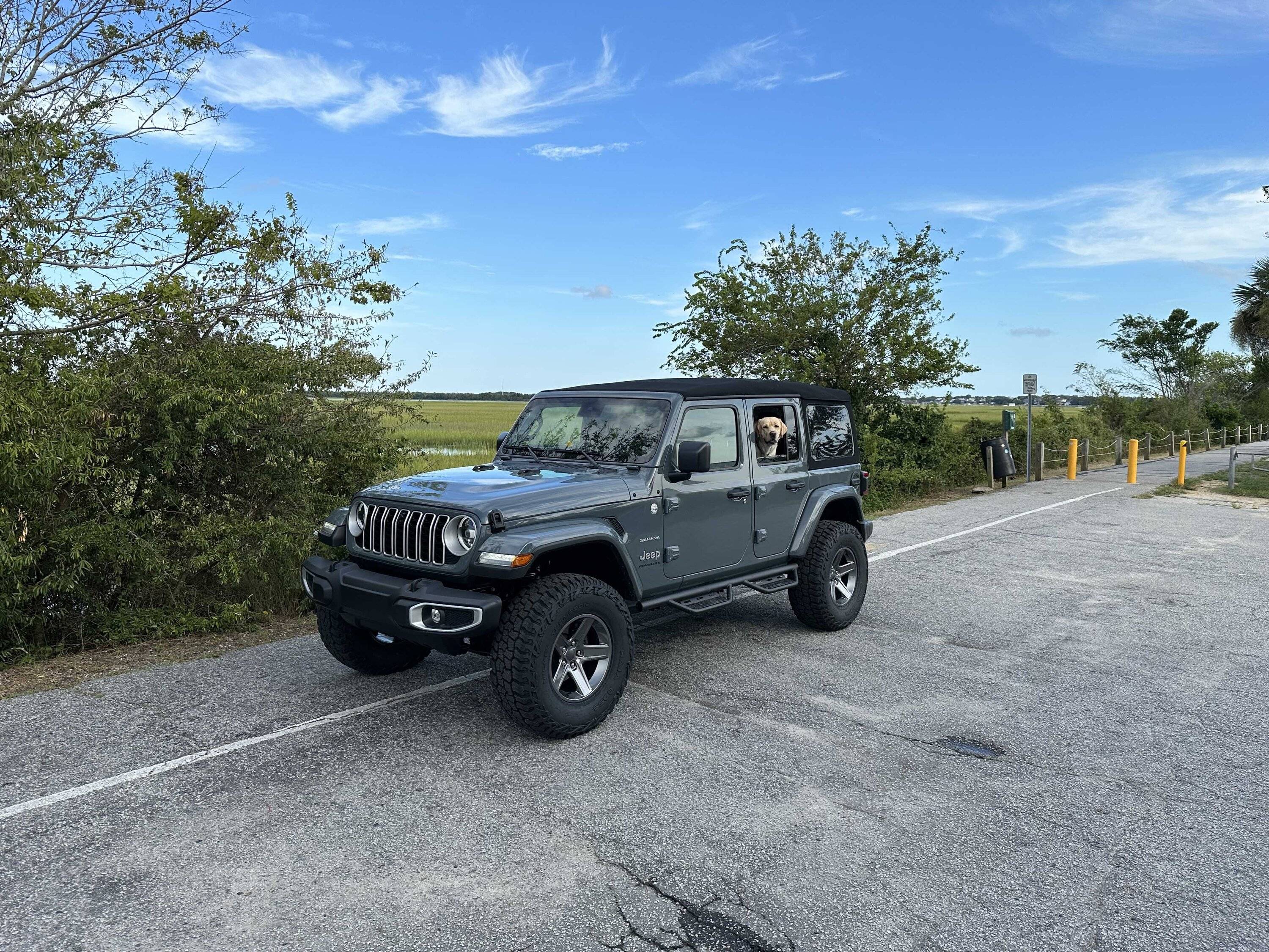

Here is a pic of my 24 JLR-X with my 35 Duratracs.
