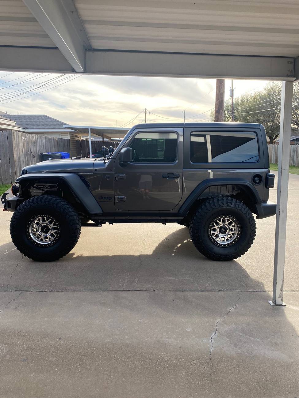

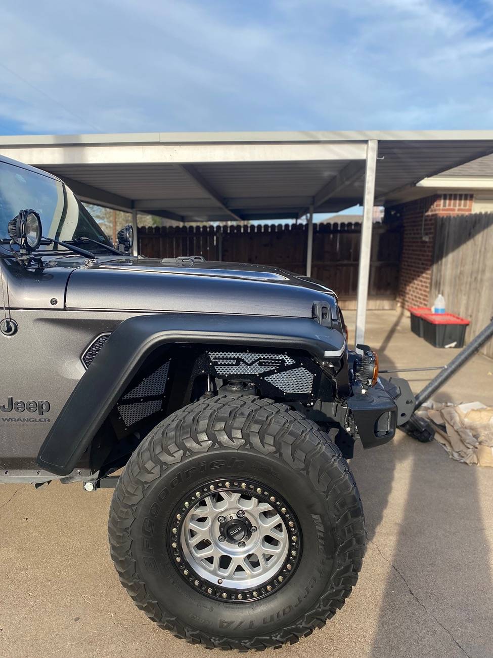

This build is a 2022 Jeep Sport two door. I just picked it up three weeks ago and it has a beautiful build on it already.

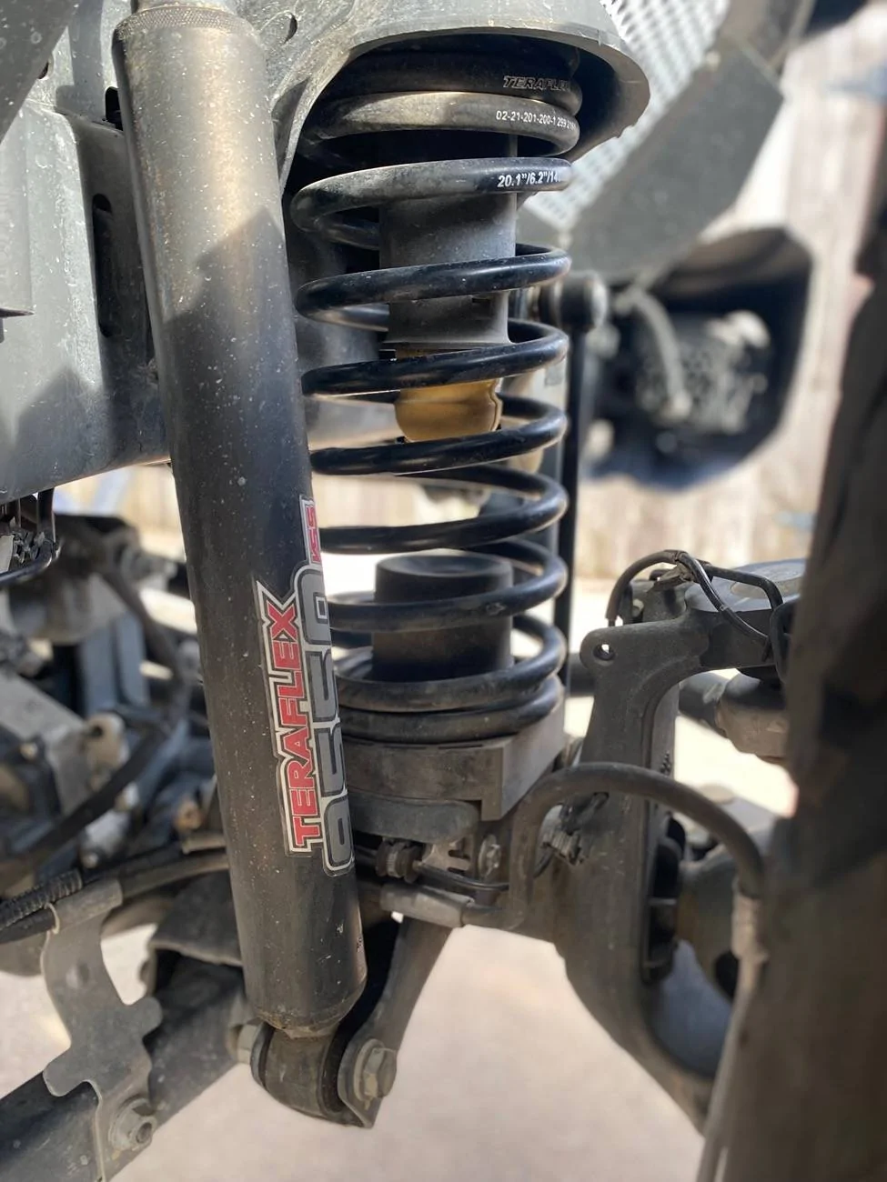

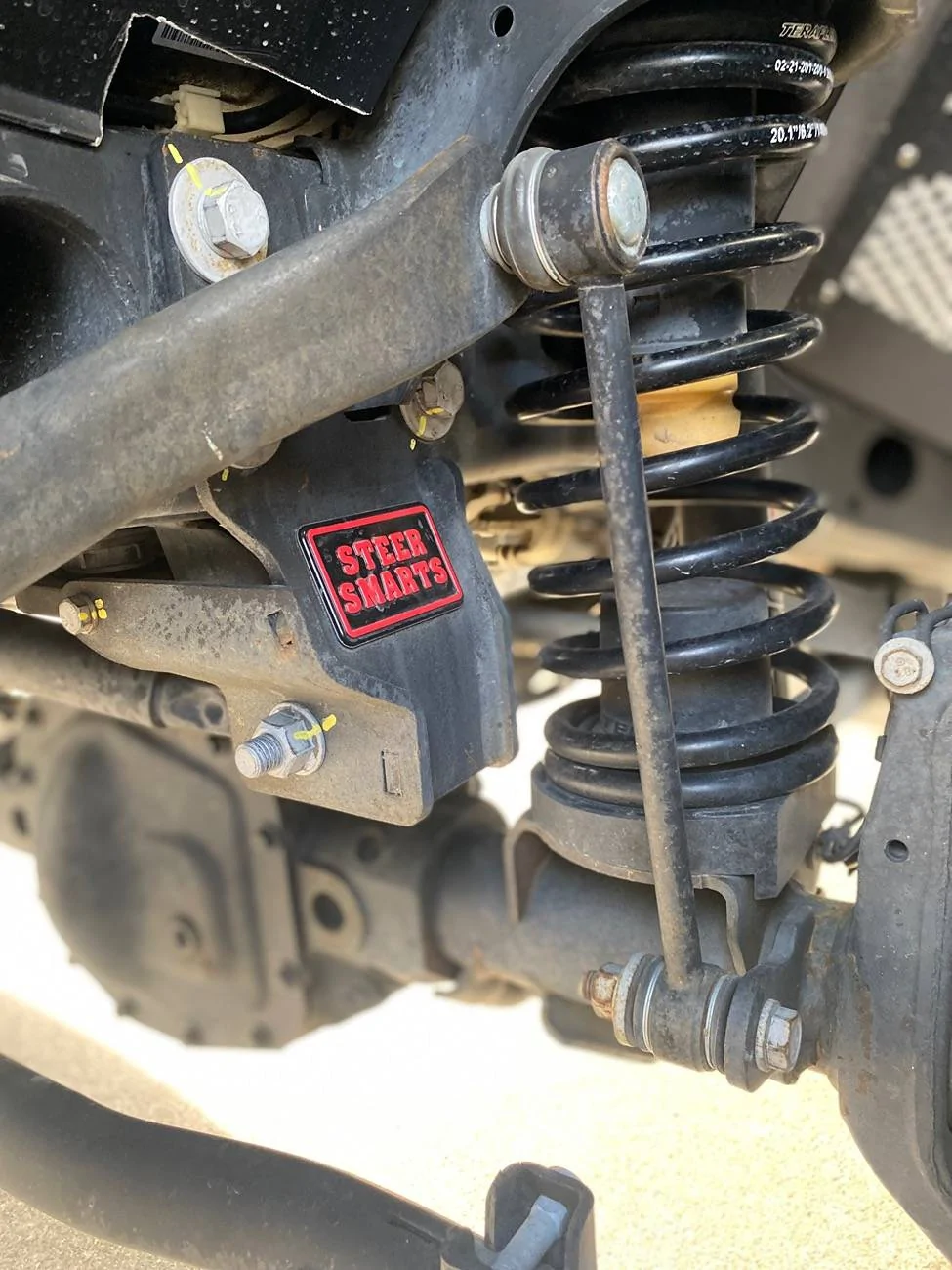

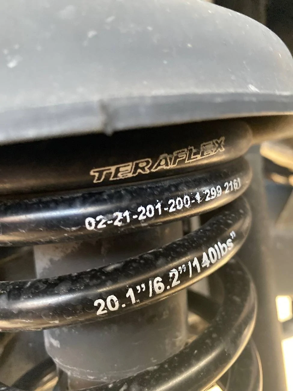

I was wondering if I could get some help identifying the height of my lift kit. I know it’s a Teraflex according to the springs and shocks. Just having a hard time finding online the height that I have on this kit. I have searched the part numbers, no luck.
If anyone with veteran eyes is willing to help a newbie, I’ve thrown some pictures on here to show you my jeep and the lift.

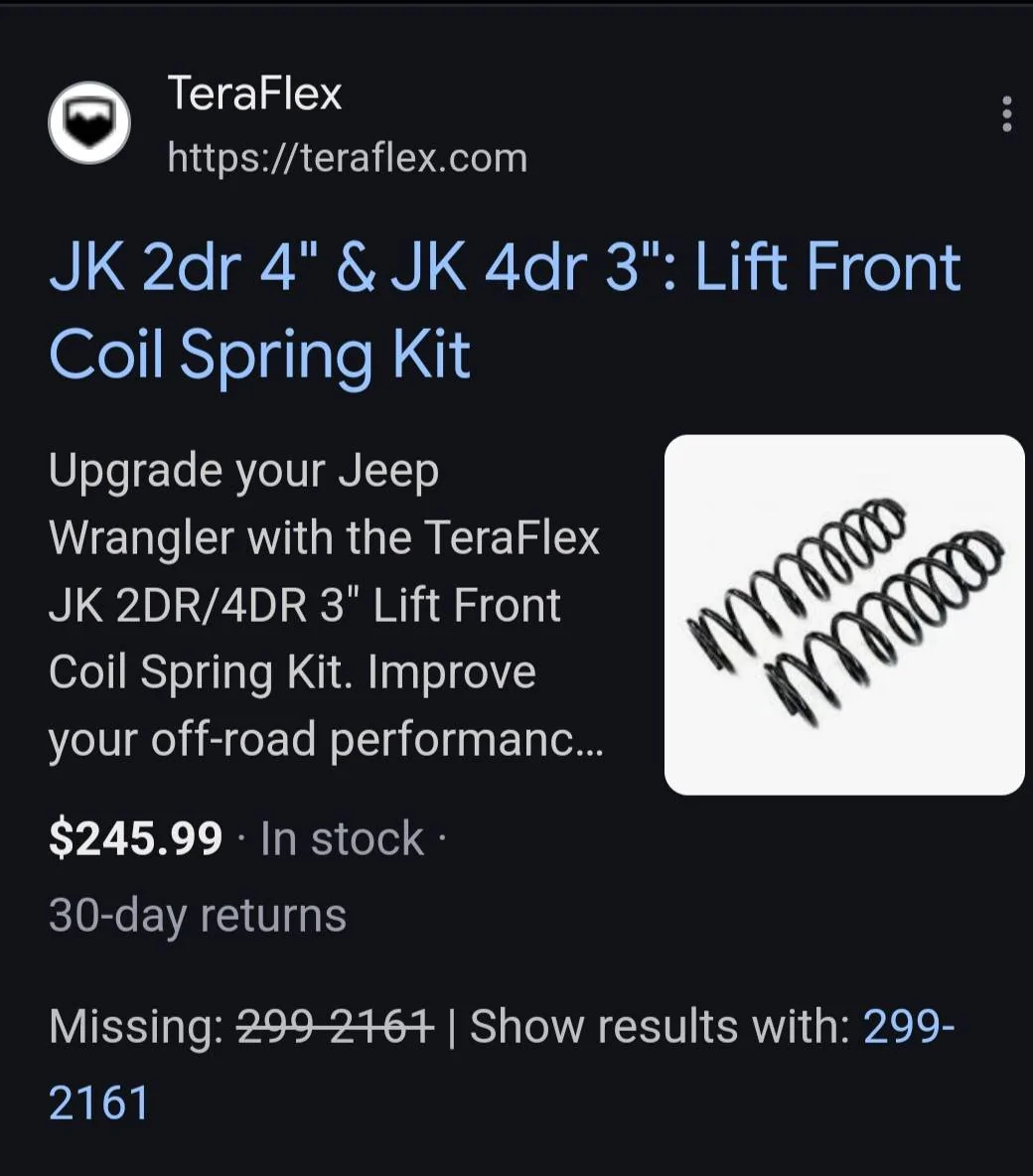

Welcome to the forum. That's a nice looking jeep.

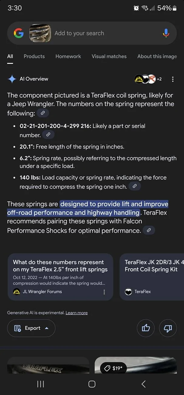

Everytime I run the numbers I keep getting JK info. No help, sorry.

According to TeraFlex, the numbers are the coil free length/full compressed length/and spring rate.
You have a 20.1" spring that compresses to 6.2
Mine is a 21" that compresses to 7.2
Difference of .9" and 1"
The weight of a 2dr vs a 4dr might play into it but considering that mine is a 2.5" lift, I would guess that you have a 1.5" lift. Then again, I have never heard of a TeraFlex 1.5" coil lift kit for a JL.

Here is the chart for 2.5" lift coil springs. My 4dr is the 250-1 and you have the 2dr 200-1 , so I go back on what I said before about 1.5" and now I am pretty sure that you have a 2.5" lift.
