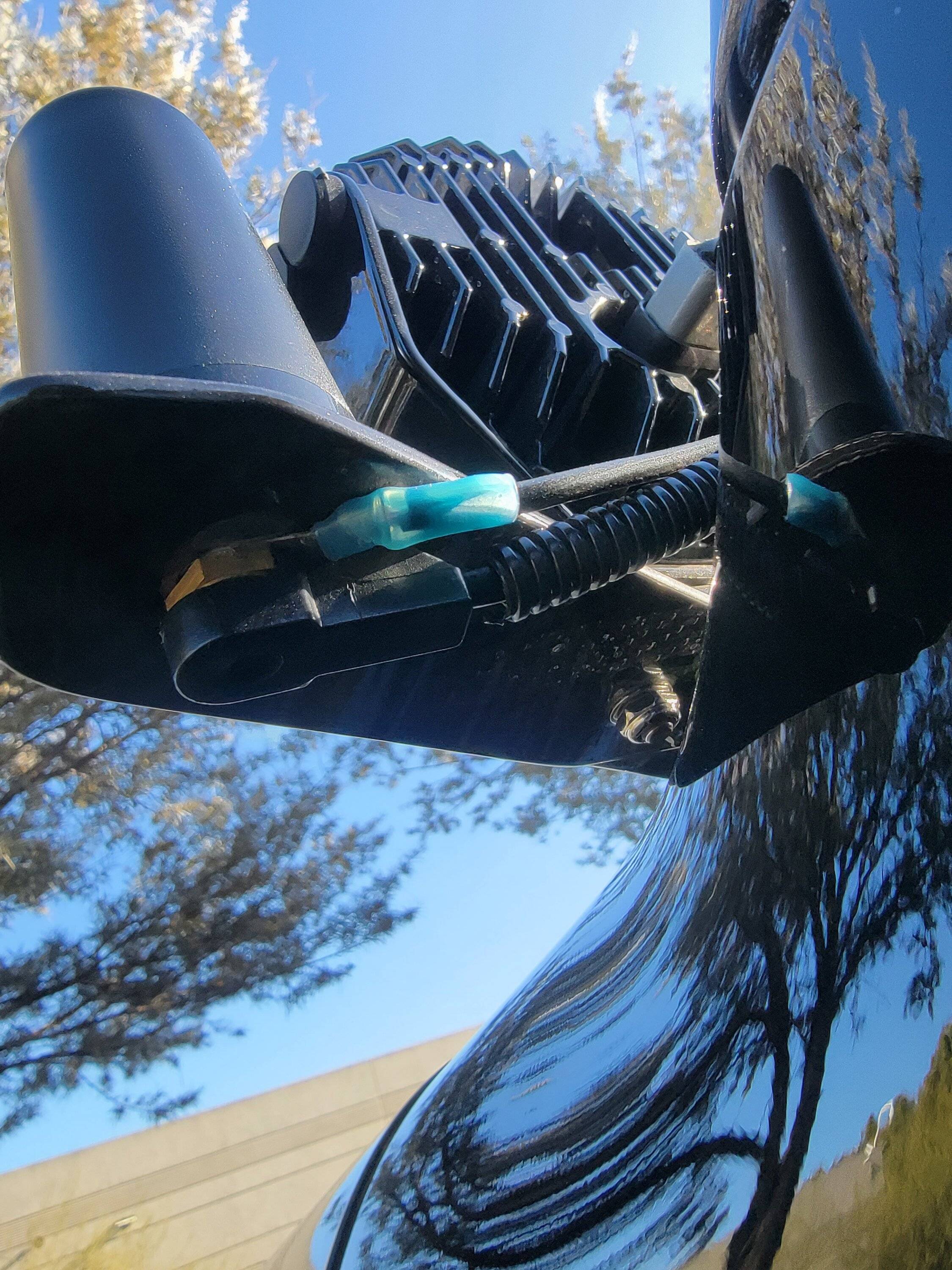

From your description I doubt your antenna has any ground. I am not a gmrs antenna pro but Googling the subject the top reply was "Your antenna mount needs to be properly grounded for your antenna to function correctly. Without a solid ground, you're bound to get high SWR levels and extremely poor performance." I have the Wouxon KG1000-G paired with a Midland Ghost antenna. The antenna came with a grounding piece that bites into the metal for a ground. Surprised the rep you dealt with did not recommend a ground. Mine is mounted on carbon fiber so I added the ground with a ring terminal to a ground under the cowl, measured less than 1 ohm to hood. I have clear noise free reception and transmission.

Thanks CpT Papa. Just to make sure I'm getting it, since you have a carbon fiber bracket, you didn't make use of the metal "bite" piece that Midland included with the coax, and instead you ran a separate grounding wire ringed to your NMO assembly and your chassis. Right?
In my case, my antenna mount is powder-coated aluminum which bolts into two factory cowl holes. Not sure if I should use the "bite" piece to grab into the aluminum bracket, or run a ground wire as you did, or both?
That is correct. You can remove the powder coat and any other paint or coating on the bolts to get a good ground. You could also use star washers/grounding washers that bite into the coated surface. Having a multimeter to check continuity from NMO mount to ground would be a plus. Look for less than 1 ohm, same on the chassis ground. Hope that helps.
