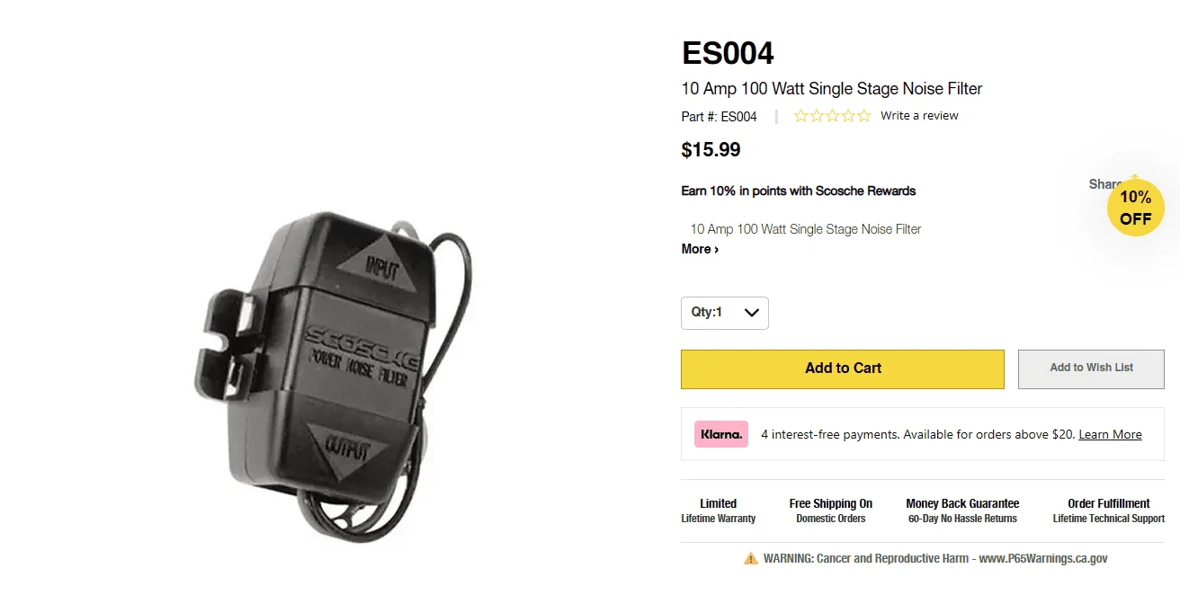

Some internet crawling and I found threads pertaining to this same noise being from the throttle body. So If I know thats the source of the interference is there somehting I can do to limit it here? Should I just be looking a shielding the power wires?

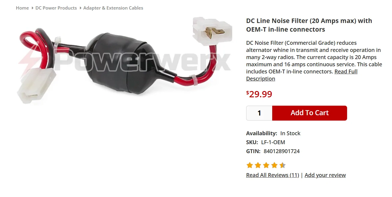

This seems to have corrected the issue. I know its best to insulate source of interference but in this case I dont know how to insulate the throttle body.

I hope this fixes mine. Reception is fine.
Transmit however:
Key OFF fine
Key ACC fine
Key RUN BUZZ
Engine running BUZZ.
I've tried this filter
Jeep Wrangler JL Electric interference with GMRS 1758202124720-9f
Ferrite beds, RFI shielding. Power to the Aux always on line and grounded to the frame on the passenger side, to routing power to the battery with a ground at the frame or the battery neg.
