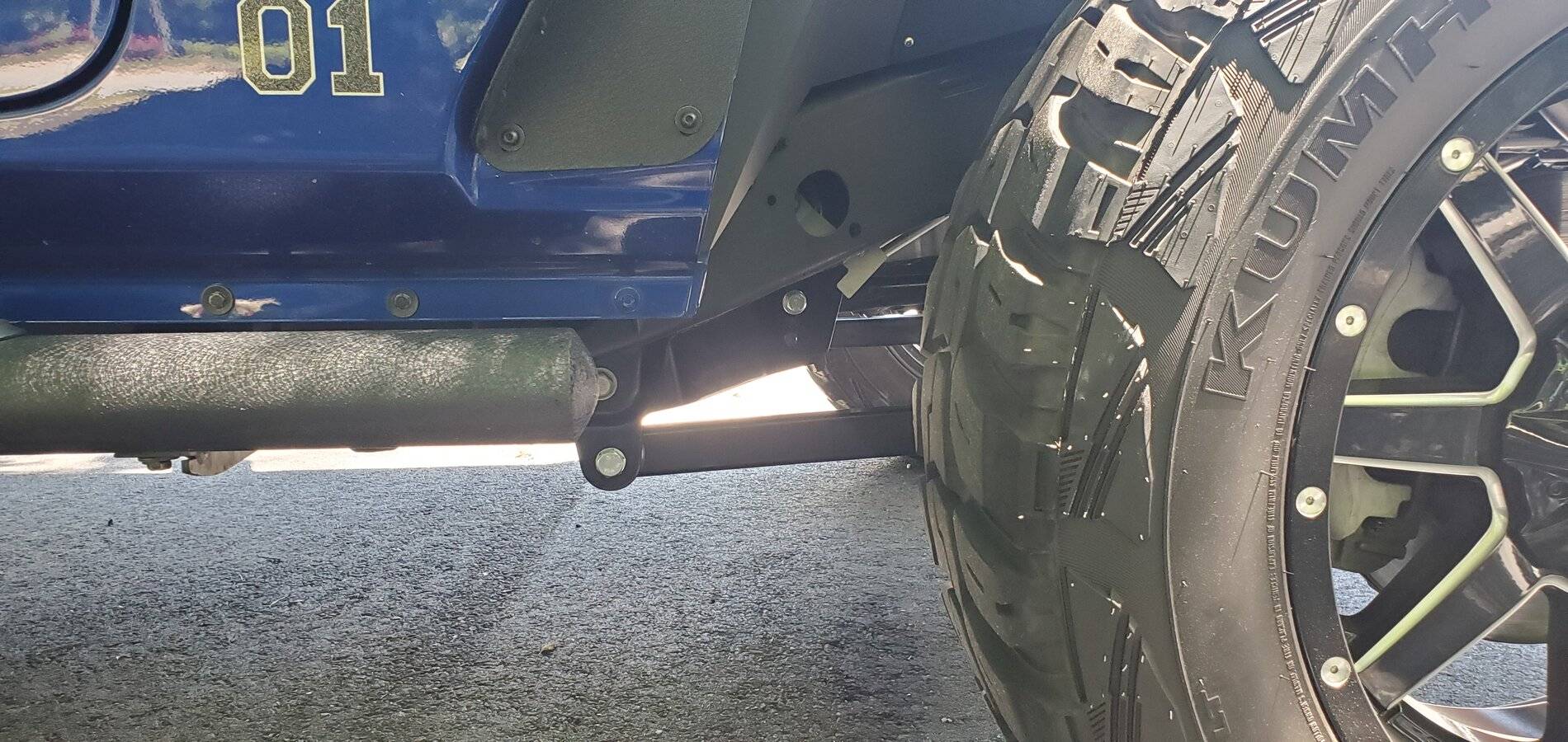

Hey Rancho... I realize I am late to the party but I just install these on my 2019 JLU sport. I have a 2.5" lift installed. Top arm in the top hole. Mr lower arms are now less than parallel and lower in the rear than at the axle. Is this normal? I am wondering if this is going to cause issues. Thanks.

Got a pic by chance?
And not late to the party at all.
We sell a ton of these for the JL/JT!
And yes the lower arm will hang about an inch or so below than before.

Totally normal. That helps keep the "angle of the dangle" in spec and keep the ride feel nice.
So i had my alignment checked. While wander at hwy speed is better, Caster is at 7.5° with the top arms in the top hole. That is way out of your spec and even past the "magic" 6°?? I think these are just too much change for the RC 2.5" lift. I am guessing just a lower bar is the way to go...
