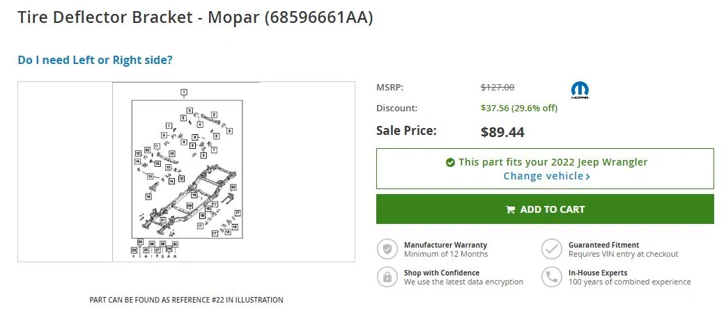

Well I'll be darned... I also found this.
Jeep Wrangler JL New frame brackets are for crash protection? 1718748780197-id
It still doesn't make sense it's only one side. Your guess to get 1 better star and save a buck is sounding pretty plausible.

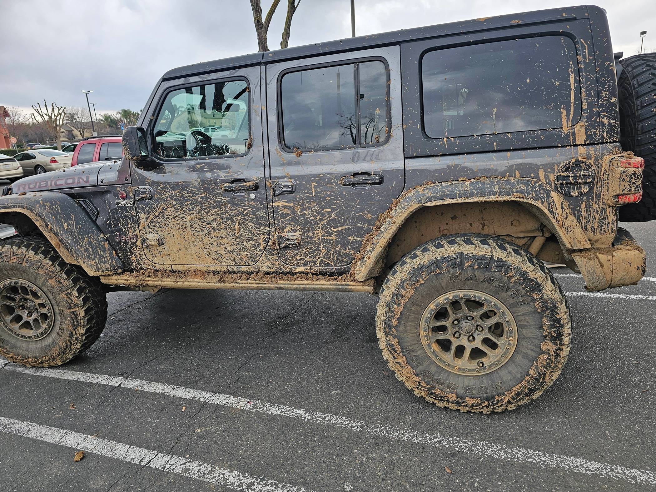

I mean if we are being real most people that run anything bigger are just building mall crawlers and will never get dirtier than after a rain.
The 39s on the wife's have never been to the mall... it is dirty in the costco parking lot often
