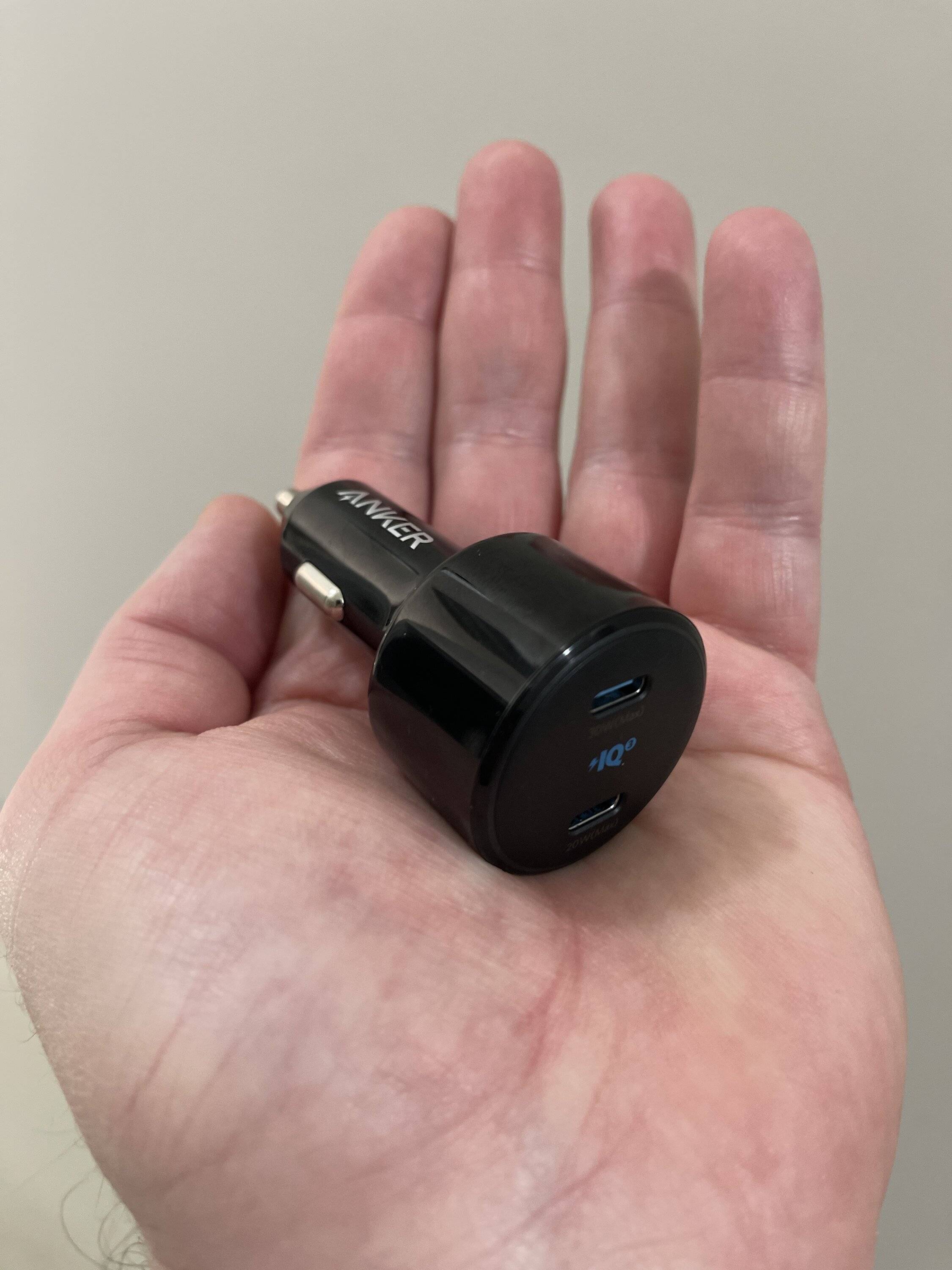

Hello,
I installed Oracle headlights a while back, and it required me to patch into my cigarette lighter fuse (20A) to utilize the halos. Now I cannot use the cigarette lighter for any accessories. It’s not the accessory because it works fine on the rear port. Do I need to up the fuse or something? The attached picture is the accessory I’m trying to use. Thanks for any help!

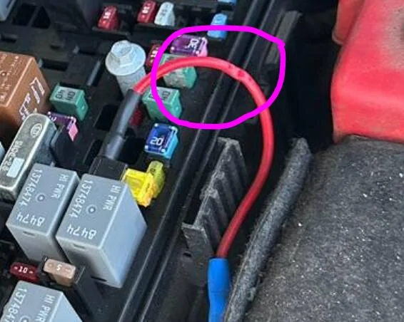

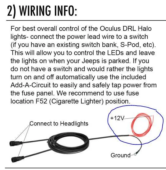

my other issue was the red wire (circled in blue) isn't actually that long.
It's provided at the same length as the grounding lug wire.
I had to splice in a length to avoid crushing it with the fuse box cover like
OreoJeep appears to have done (circled in magenta). I ran mine behind the fuse box at the firewall.
