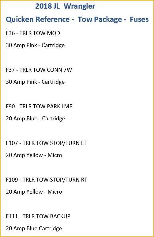

Installed cube lights in my rear bumper and wanted to connect to reverse light. There are several threads walking through this. I followed those and tapped the white/orange wire but there’s no power. In fact there is no power to any of the tow hitch wires.
Any suggestions on how to debug?
