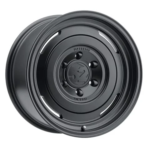

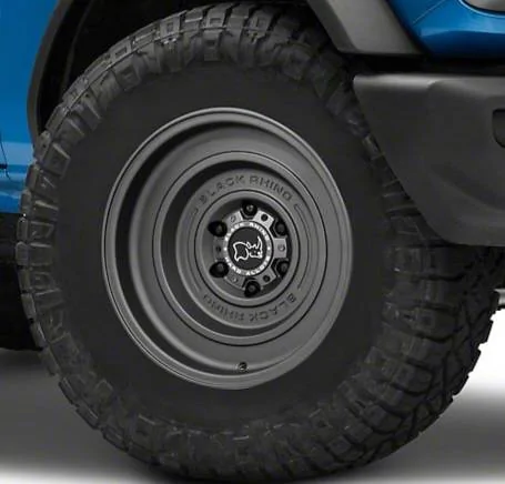

These two?
Jeep Wrangler JL Narrowed down the wheel choice but question about offset and width FB13597G21-2157619060
Jeep Wrangler JL Narrowed down the wheel choice but question about offset and width th-3032078568

Those are them! Any experiences with either?
Nope.

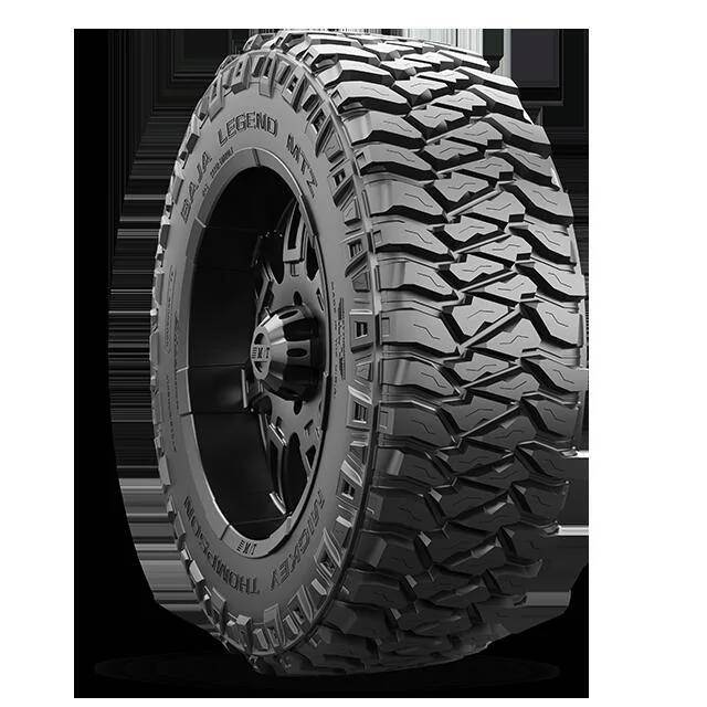

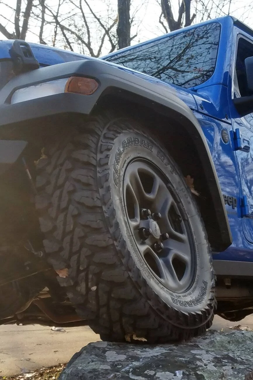

As much as I absolutely love both of those wheels especially the black Rhino. And as much as I want this šŸ‘‡ MT tire. I just can't seem to bring myself to going wide. I can't quite put my finger on it. Maybe its a Military or old school look, the way they tuck right up there. I don't know, but there is just something about tall & skinny that I'm drawn too.
I look forward to seeing your setup when your finshed. šŸ‘
