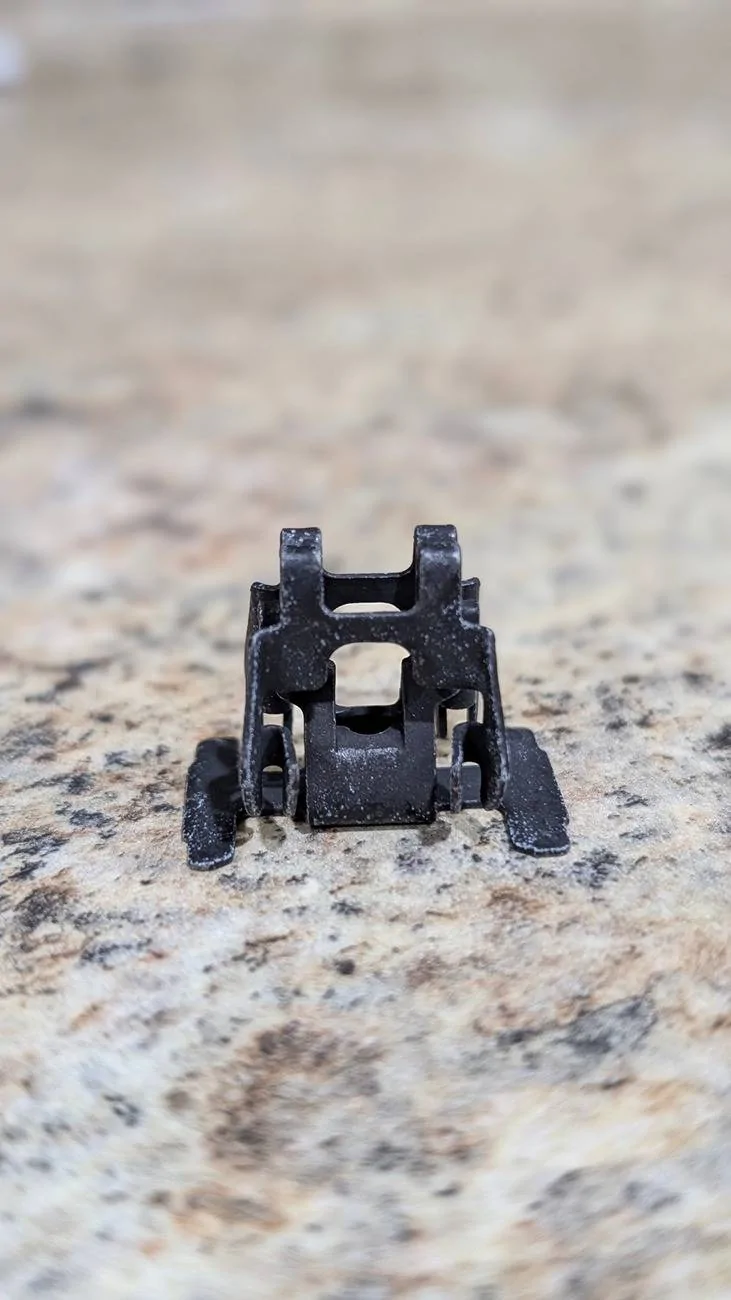

Does anyone know what this may be? Found it on the floorboard behind the driver's seat today. We have a 2023 Sahara 4xe. Thanks!
Jeep Wrangler JL Mysterious Interior Piece? PXL_20241113_002524870.PORTRAIT
Jeep Wrangler JL Mysterious Interior Piece? PXL_20241113_002528080.PORTRAIT
LSUjeep
Jul 15, 2020
80
Louisiana
Jeep Gladiator 80th Anniversary Edition and Jeep Wrangler High Altitude
I'm thinking something with wires maybe. Just not sure where it would have come from.

Kinda looks like a metal clip that holds a kick panel or some other panel in place. It should clip over a tab on a panel, line the panel up and then you give it a good whack with your hand to pop it into place.
Did you or someone else recently remove a panel?

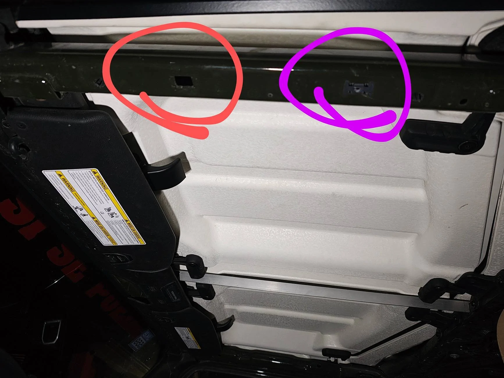

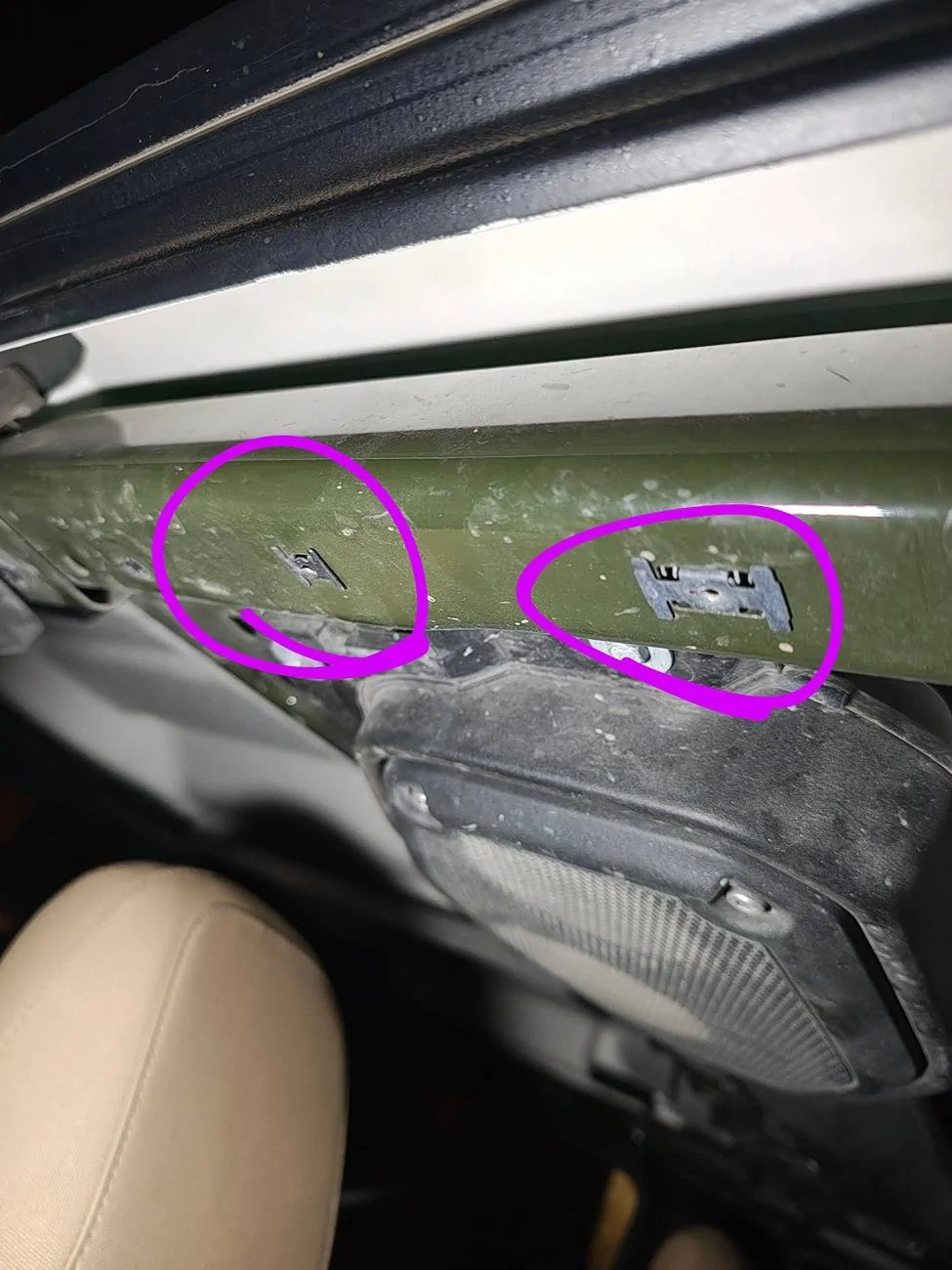

@LSUjeep
I know exactly what that is.
It helps that I've already removed most of my trim, which is what hides these pieces that you found.
Jeep Wrangler JL Mysterious Interior Piece? 1000005041
If you remove the trim on your "roll" cage, You got all these clips in there that your trim screws screw into. They're not alligator clips, they're something else. I don't have an exact name for them, I do know that if you happen to take one out as circled in red below, you'll never be able to get it back in. :headbang:
Jeep Wrangler JL Mysterious Interior Piece? 1000005049

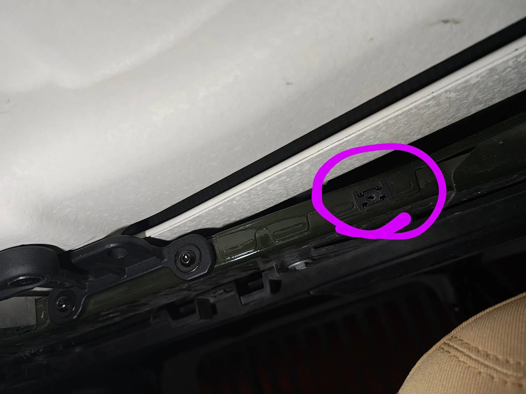

Here's the close-up of that one on the driver side door roll bar that I haven't removed yet. The one circled in purple in the photo above is the same one circled in purple below.
Jeep Wrangler JL Mysterious Interior Piece? 1000005048

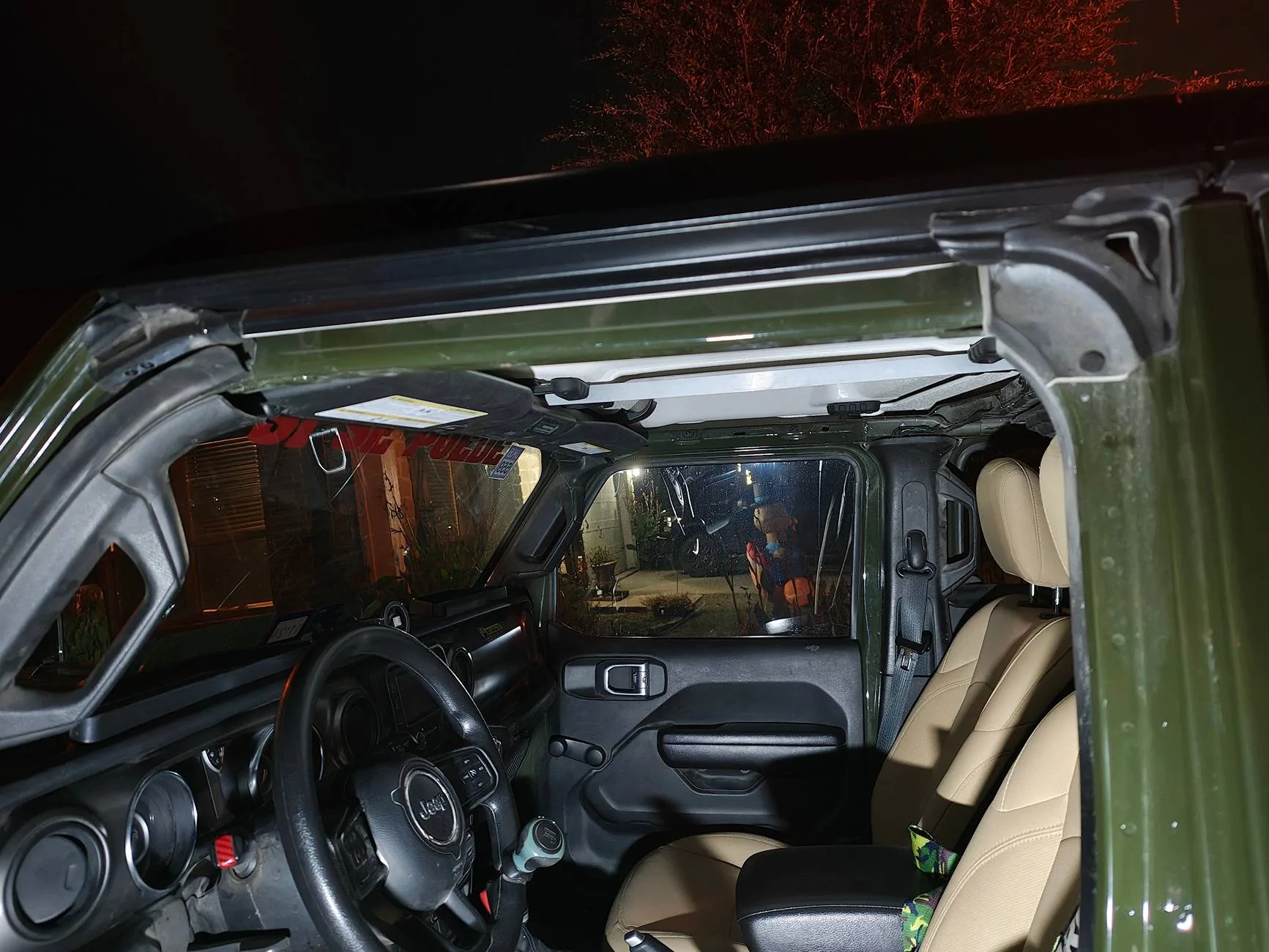

The b pillar crossbar that your soundbar mounts behind, and your front overhead lights mount to has at least three. One below behind the driver seat.
Jeep Wrangler JL Mysterious Interior Piece? 1000005050
Then he got two here, one in the middle one behind the passenger seat.
Jeep Wrangler JL Mysterious Interior Piece? 1000005051
If you haven't noticed already, some of these are bigger ones, and some of them are slightly smaller, but in the end they're all equally difficult to get out. You going to need some needle nose pliers and a pry tool and it's going to be a bitch to get it out, but once you do, you might as well throw it away like I did because you're never going to get it back in. :facepalm:
Jeep Wrangler JL Mysterious Interior Piece? 1000005052

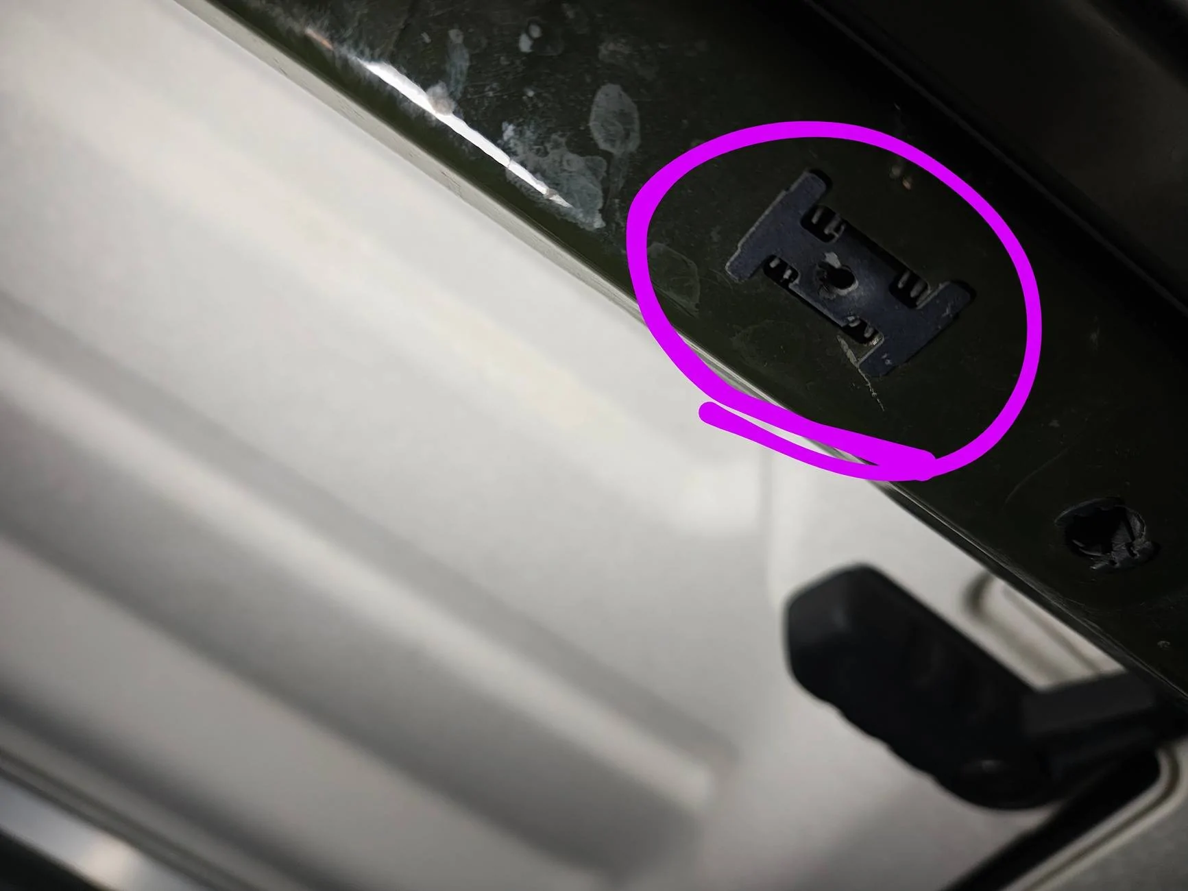

Here's the sport bar / roll bar on the driver side rear door... Another big one and a small one.
If yours was sitting underneath the driver seat or behind it, chances are it fell from the driver side roll bar. It might also be an extra one. I mean maybe the guy who installed them in the factory had One fell out of his hand, he couldn't find it he put another one in and just left it there until you found it. That sort of thing definitely happens. When I got my Jeep, I found a screw underneath my carpet that didn't go to anything. My dad was saying that some guy at the factory probably dropped it couldn't find it, put another screw in and left it for me to find. 🤷‍♂️
Should be easy enough to figure out if one of your trim screws isn't actually attached to anything. Look at all your trim pieces in the roof area, see if any of them are missing a screw. If none of them are missing a screw, grab you the right size torx bit, and tighten them all, if any of them are loose and spin clockwise forever, there's probably no clip in there.

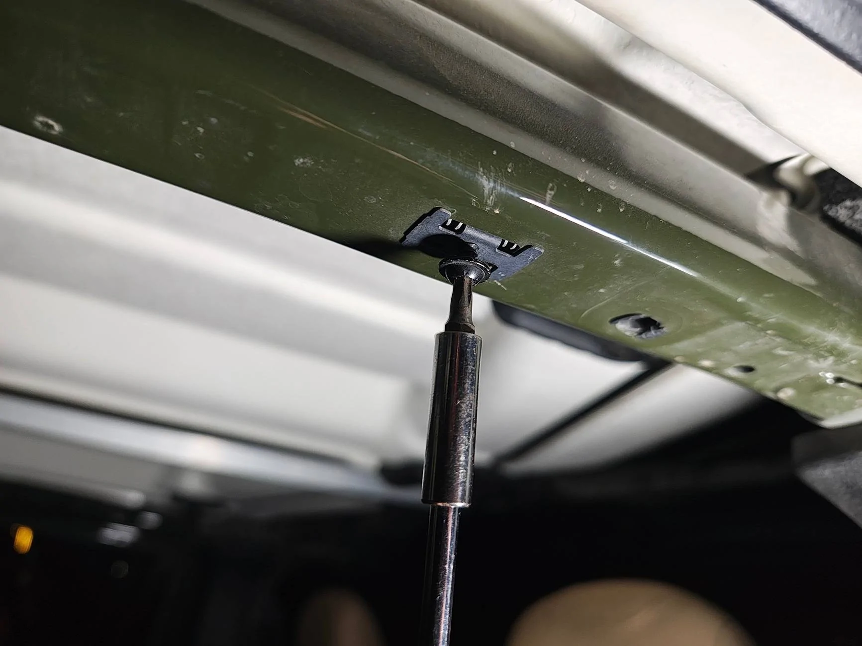

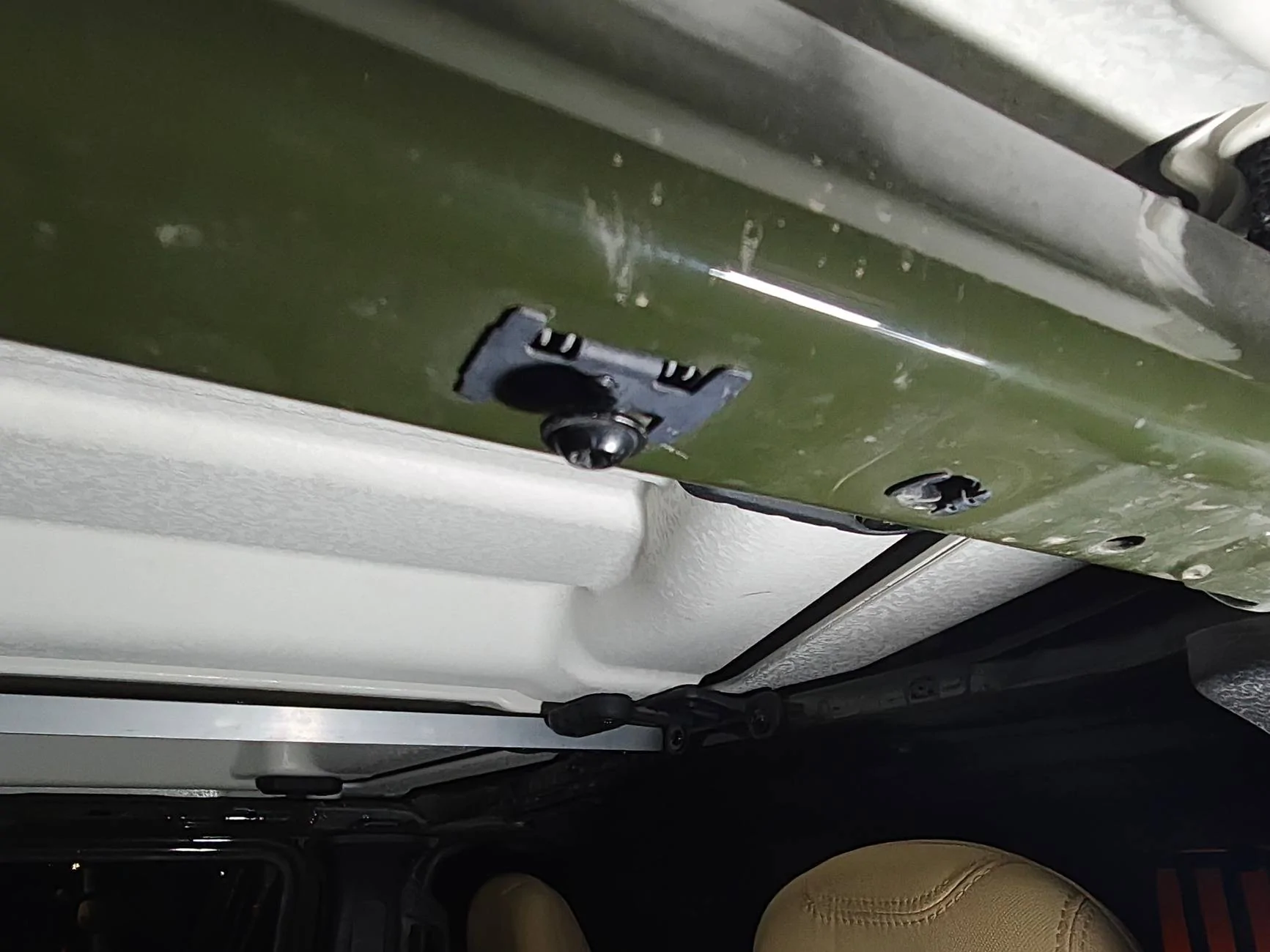

Decided to put in a trim screw for you.
Jeep Wrangler JL Mysterious Interior Piece? 1000005057
What you're looking at is a T25 torx bit. ;)
Jeep Wrangler JL Mysterious Interior Piece? 1000005059
