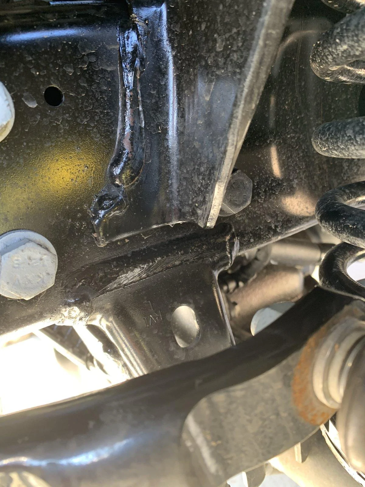

So basically all new JL's have some porosity, and the jeep you had with the issues was over and above the accepted level or standards.....
I would say that you are going to find some due to the type of metal and welding process. My 18 was far more than I was willing to accept as it looked like swiss cheese with 85 percent of its weld having large amounts of slag. My 19 has cleaner welds with far less porosity. No porosity is good (I would never allow it on my own welding projects but in mass production there is going to be some. Slag...should be addressed at frame factory before electroplating. All it takes is a wire brush wheel and a drill. I would say my 19 has 95 percent less slag than my 18. I think its the best I am going to get.

So no porous welds at all or minimal and up to standards vs the non-stop porosity we saw on your 18?
I can’t speak for him, but the welds on my 19 compared to my 18 are far and away better. Honestly, it looks like the process was completely revamped.

Glad it's better but does that mean no holes or just acceptable levels.
There are holes but for instance where I had dozens in a 6 in weld on my 2018 with some very large, I might have 1 to 3 small ones now on the 2019. They still shouldn't be there but in mass production where speed is a priority I think it's the best I am going to get and acceptable imho. Also when I have a hole (porosity)on the 19 there isn't another right next to it. On my 18 they were right next together in strongs almost like a pearl necklace of holes.
Ok good info. Mine is in the norm given your description.
