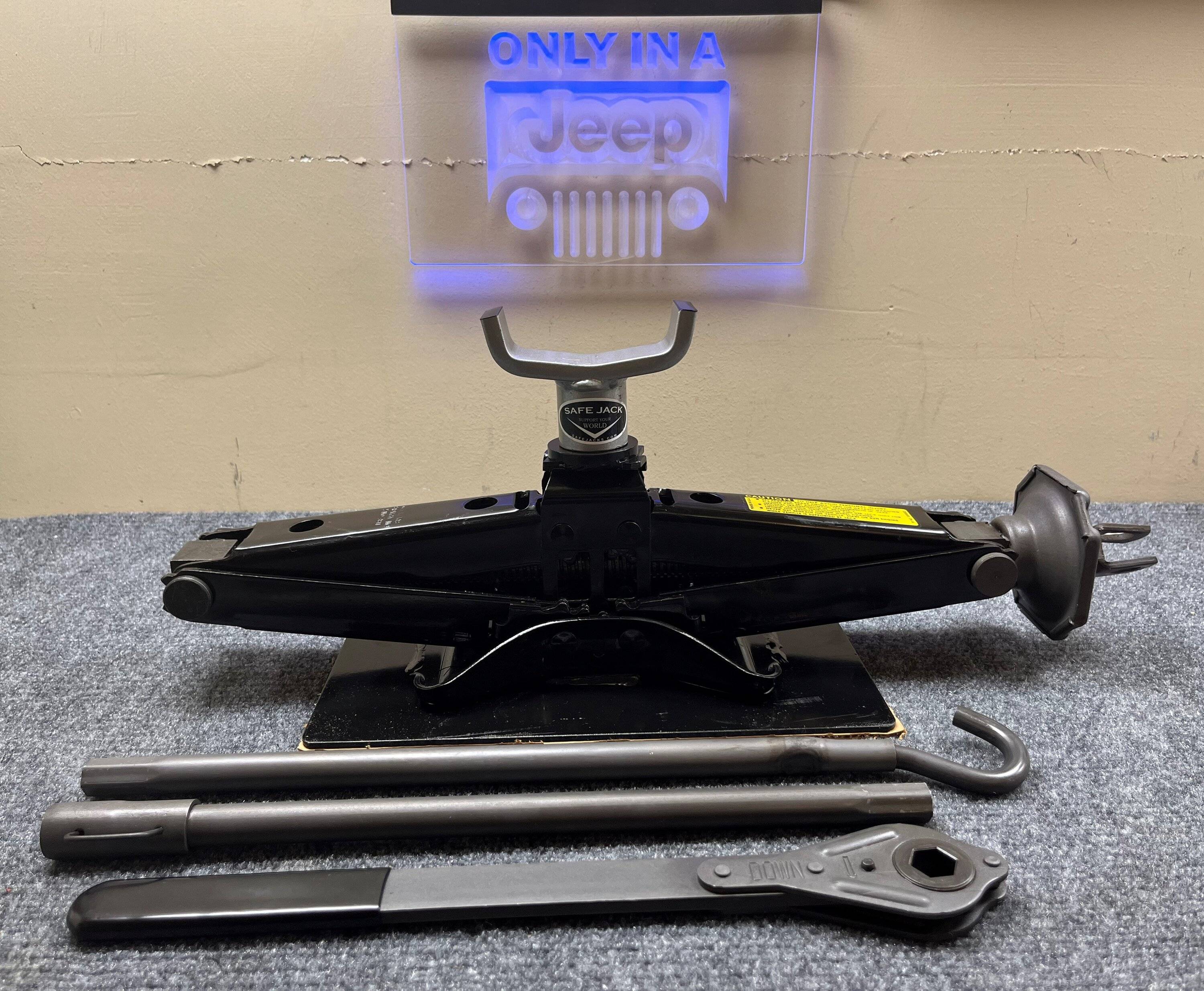

I will probably order up the following heavy-duty scissor jack from Agile Offroad:
https://agileoffroad.com/product/heavy-duty-scissor-jack-by-agile-offroad/
But I'll also have to order the Safe Jack axle adapter mentioned above for the tight space at the front axle, and add the sleeve as well. Too bad Agile Offroad didn't think of that.
The only thing is it looks like the shaft of the AO adapter may be too short for the SJ adapter.

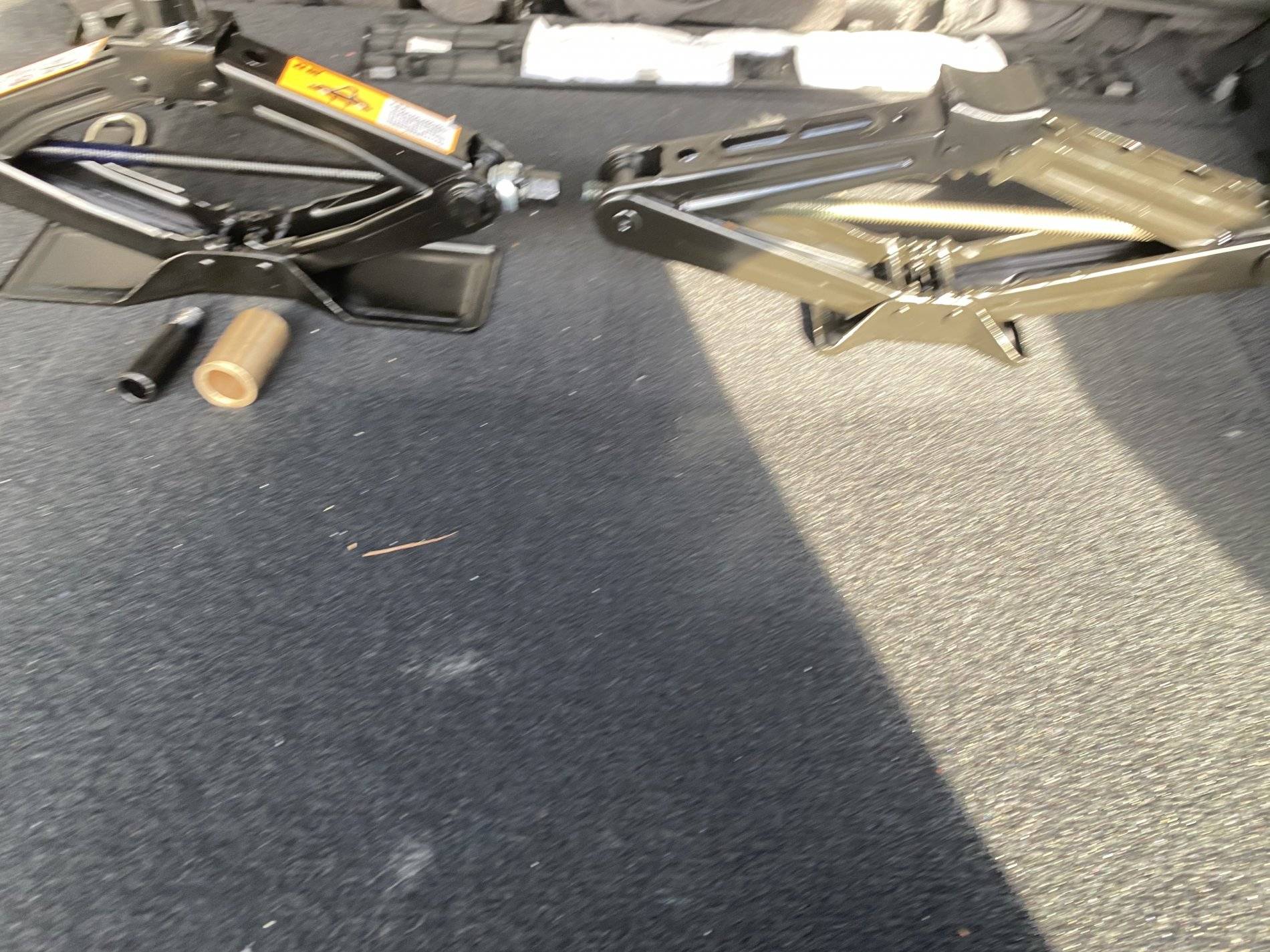

I have two of the HMMWV scissor jacks that I bought for around $100 each in new condition quite a few years ago. Sadly, unless you have a source you can share, they were recently around $250 shipped in good condition on eBay. Then you still need some sort of adapter. I have a couple of the Agile off-road adapters which work well on my wider XR axle. I also carry a Hilift in a Dominion mount as a very last resort as I don’t enjoy unplanned dental work should something go awry.
I bought mine a couple years ago on eBay for around $100, and there were nice used ones for much less, probably between $60 and $75. I haven't been jack-shopping since then, so perhaps the supply has dried up? Adapting the jack for our Jeeps was cheap and easy, and you can see the configuration earlier in this thread.

To complete my HMMWV jack saga above (if you really are still interested), I ordered a jack pad from Safe Jack, which worked out much better than the AO adaptor because it is only 1.5 inches wide and fits perfectly at both jacking points on the front axle; rear axle has plenty of room. Only modification I made on the Safe Jack pad, was to cut down both ends by 1/2", to avoid contact with the other suspension components along each axle. The setup works great, but the diameter of the jack pad's receiver is approximately .10-inch wider than the jack's ram, so it is much looser that the AO adaptor. To mitigate this, I will try to find a metal sleeve that is big enough to fit over the ram, and small enough to fit inside the jack pad's receiver. If that's not possible, a couple wraps of duct tape around the ram will fill the void and keep the jack pad snug but still moveable.
Luckily, after all my time driving HMMWVs in the military I never had to use one of these jacks, but they are great for Jeep use, thanks to their robust construction and wide 12"x7" base plate. Bottle jacks are great, but a quality scissor jack will never leak and is pretty much indestructible if used properly. Pretty clear why these were standard issue in the first place.
Hope this helps others who are interested in this jack setup and glad to answer any questions. Happy (and safe) Jeepin'!
Is that the 3” wide jack pad or the 5”?
I don't have access to it at the moment, but I'm pretty sure it is 5". Even if it was 3", it would still be way better than the stock jack. No matter what jack I use, I still carry a 12"x12" plywood square when I go offroad, just in case I need the extra stability.
Based on the image, it's the 3". The 5" is gusseted.

I don't see why the 5" wouldn't work, and the larger size makes it more versatile. But, I have the 3" and it's a pretty good fit for the axle tubes.

Duh, sorry...I thought were asking about the jack base. But yes, the pad is probably 3" because anything larger would have been impossible to fit at the ends of the front axle, especially on the driver's side. As it is, I still had to trim the ends back a little bit so I'd have a little wiggle room, but you can read my write up in more detail if needed. In any case, it is a great set-up and I don't go offroad without it.
The 5” is still 1.5” wide, so I guess I’ll find out soon enough, or I’ll have both in my tool bog😊. I did read this thread, and thanks for steering me in the right direction.
