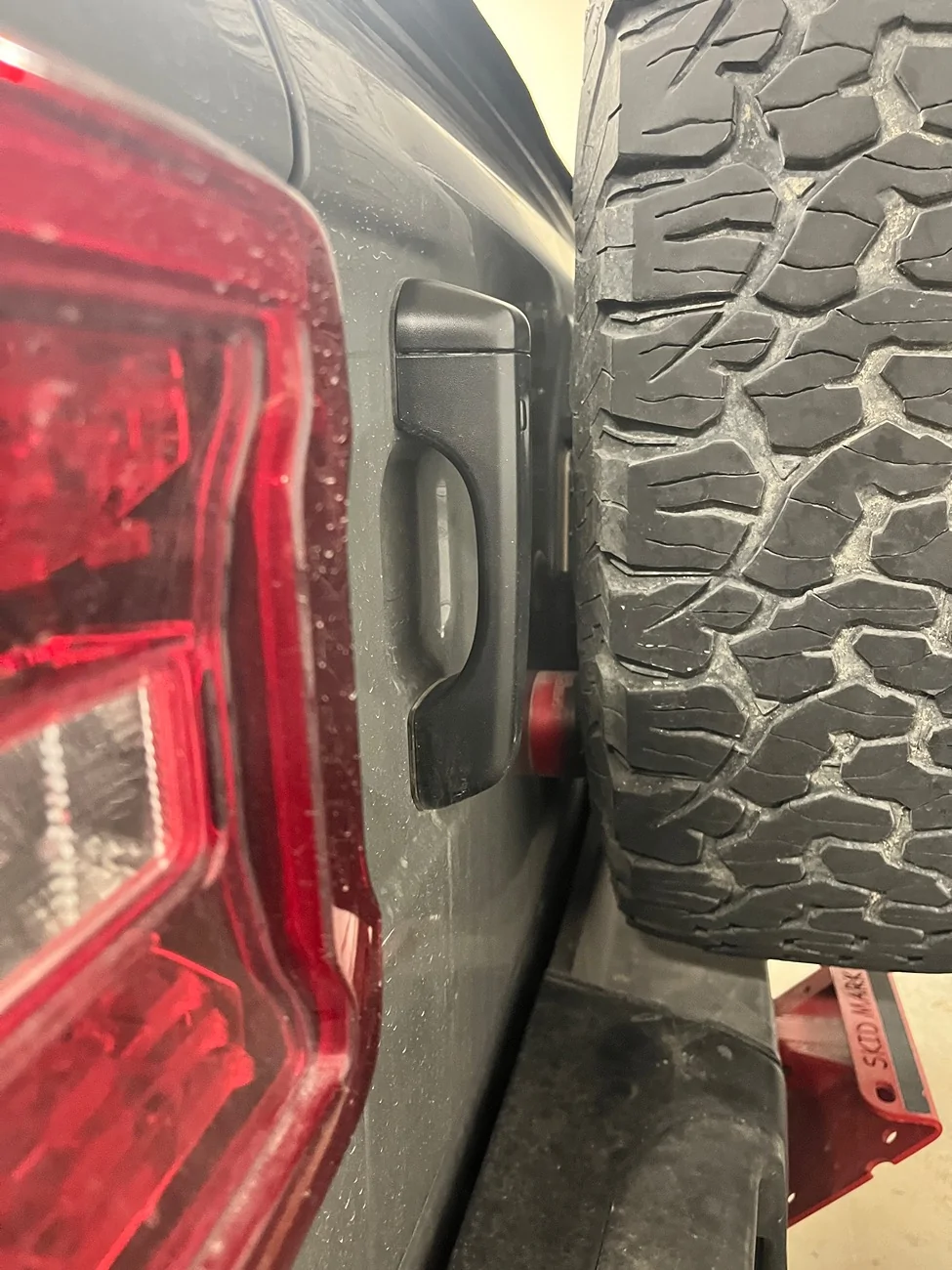

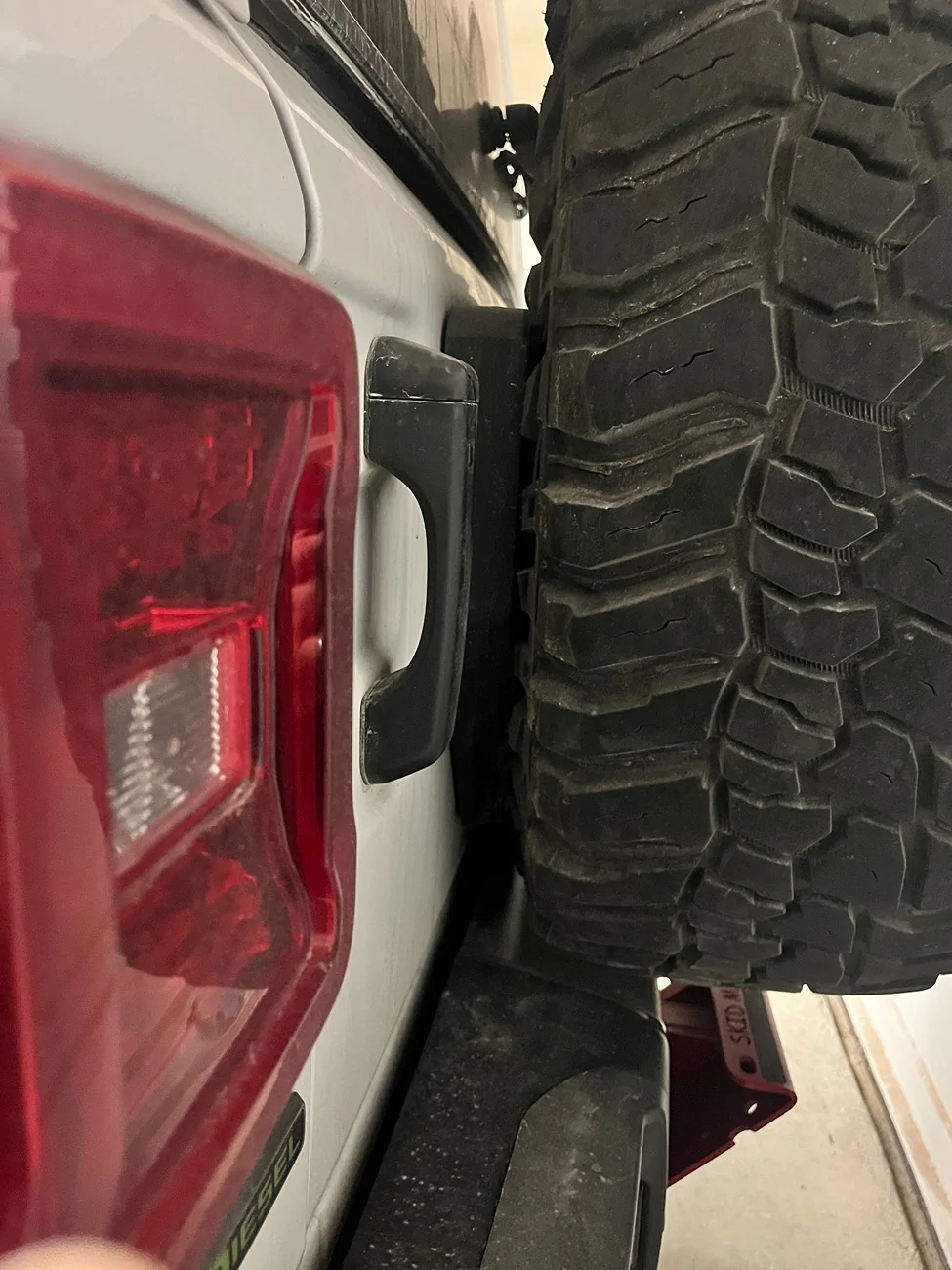

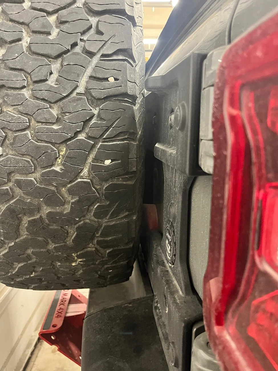

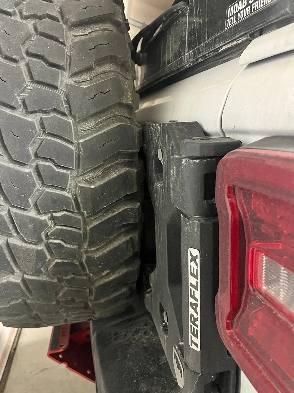

Teraflex carrier, Mopar hinge gate reinforcement. Rubber bumpers cut down to about 1”
Jeep Wrangler JL Moving Teraflex Alpha carrier INWARD? IMG_4610
Jeep Wrangler JL Moving Teraflex Alpha carrier INWARD? IMG_4611
Spring for the Teraflex hinge replacement too and you don’t need rubber bumpers.

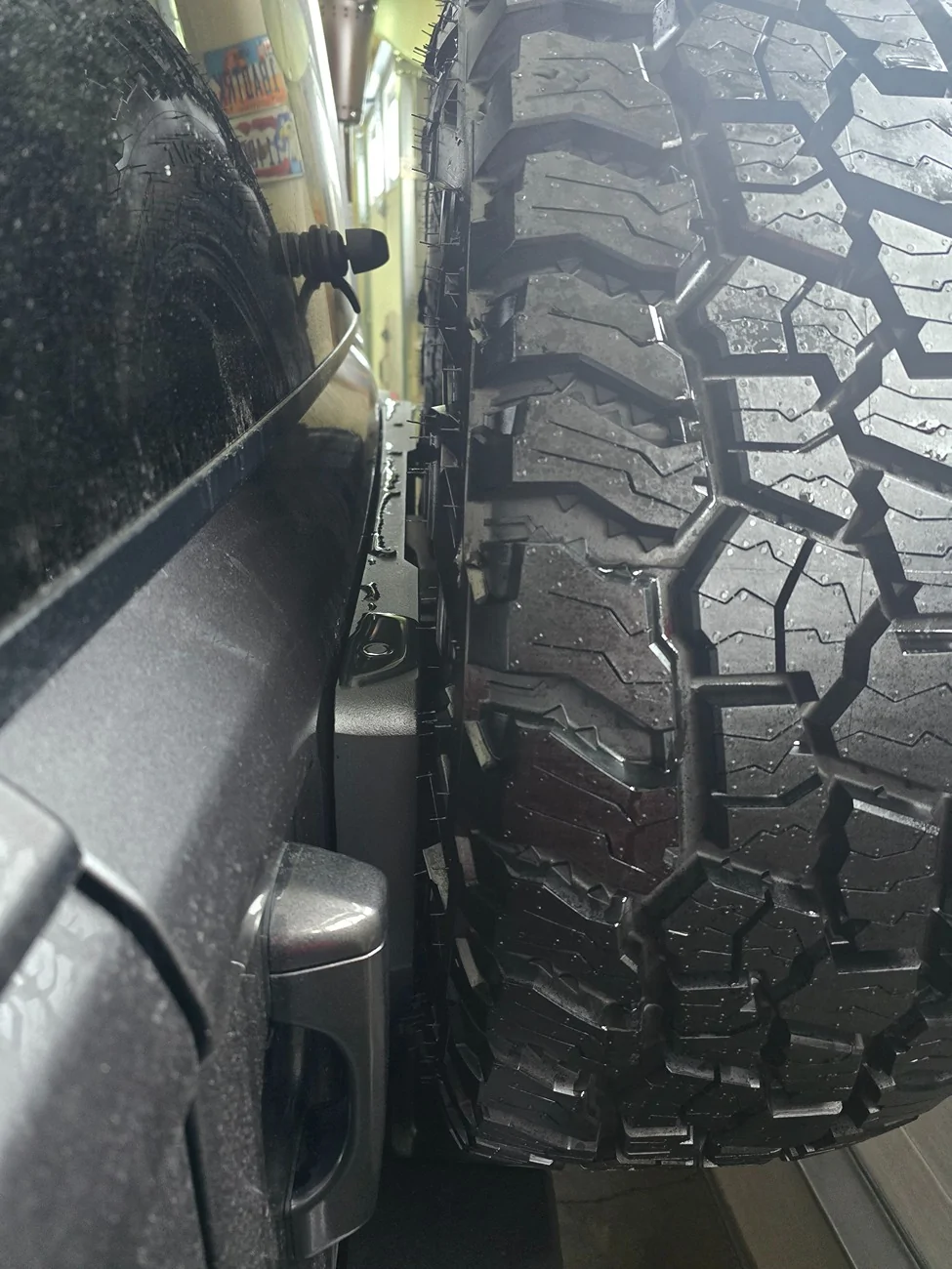

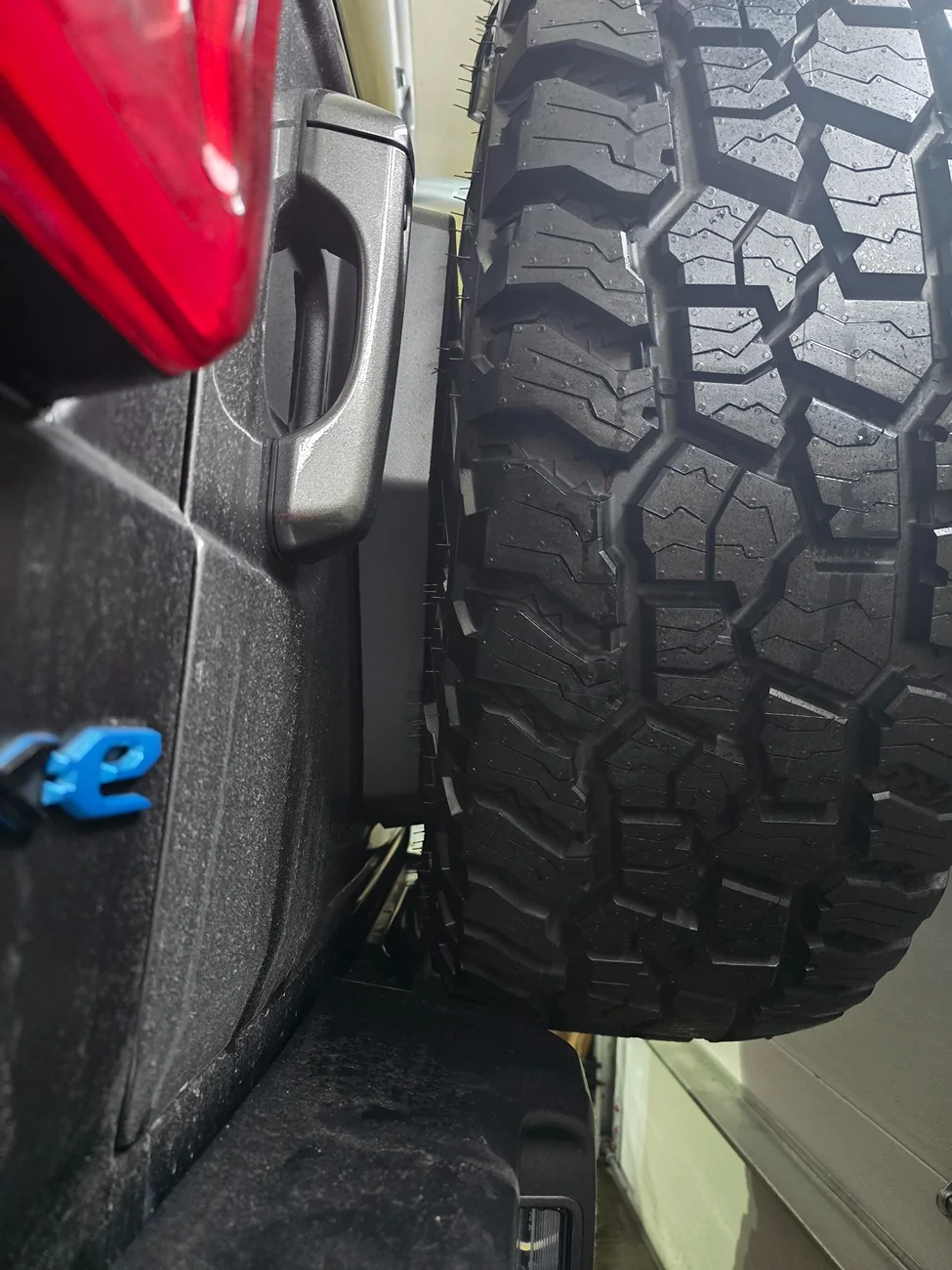

I have the same issue on mine. Running 37x12.5x20 Baja Boss AT's. I have Fuel Coupler wheels with dual stems at 12 and 6 - sensor is on the inside (window side) of the top 12:00 position.
I continually get the rear park sense error. The tire is mounted at the top of the mount and flush against the Alpha- no additional bump stops.
Im curious to hear how others have avoided this sensor issue. I've repositioned the mount and stems. Feeling the sensor issue is either bc of the Alpha itself or having a 20" wheel on it.
Curious to hear solutions here too.
On one hand it seems like your wheel size is the probity on the other, it’s only 1.5” closer to anything than a 17” wheel.
You need to borrow a spare on a 17” wheel to see if the problem goes away.
Now that I think of it, I had the factory 20" on a 34x11.5x20 BB AT on the Alpha mount for a couple of weeks until the new setup came. It was mounted on a lower setting and I don't recall a sensor issue

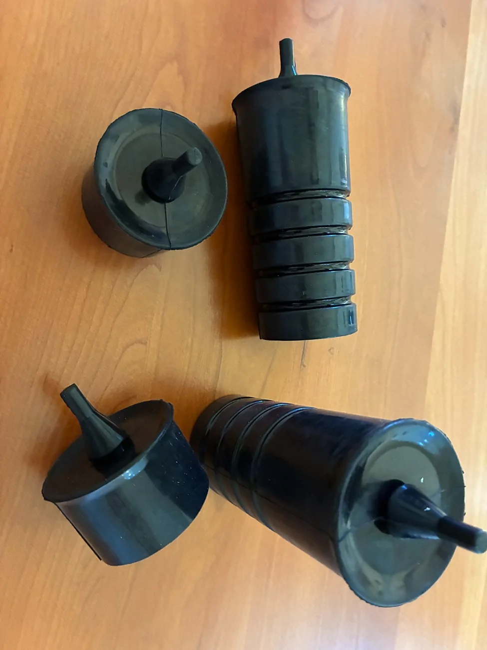

Follow-up by OP:
Success! I ended up buying these (https://www.amazon.com/dp/B0FLPCFMCQ?ref=ppx_yo2ov_dt_b_fed_asin_title) from Amazon. I had originally planned on going with the Quadratechs, but several reviewers mentioned they were overly “squishy,” so I opted for these instead. They’re definitely nice and firm.
My package arrived yesterday, and I did some major surgery this morning before getting them installed this afternoon. As a reminder, I recently upgraded to 37s, and the extra size interfered with my backup alert signal. I aligned the tire stem to the “noon” position to put more distance between the TPMS signal and the backup alert sensor, which solved about two-thirds of the issue. After trimming the aftermarket bump stops to half an inch shorter than the OEMs, bringing the spare in tighter to the tailgate, the remaining interference was eliminated.
As you can see from the attachment, I had to cut the new ones down quite a bit. I used masking tape as a guide, then used a utility knife with a fresh blade, and it cut cleanly through the material on the second pass around. And...you get a total of four bump stops in case you mess up the first pair.
