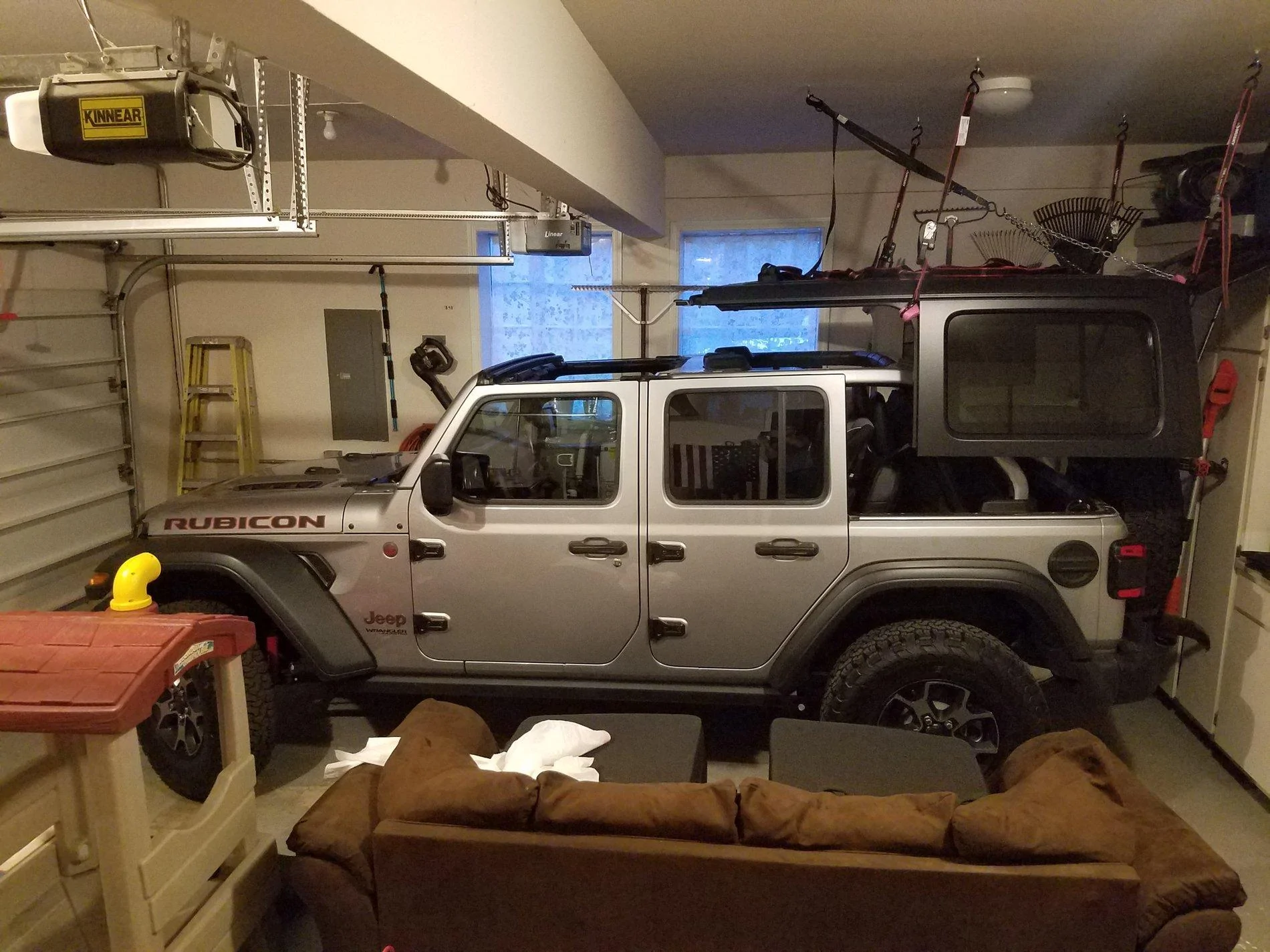

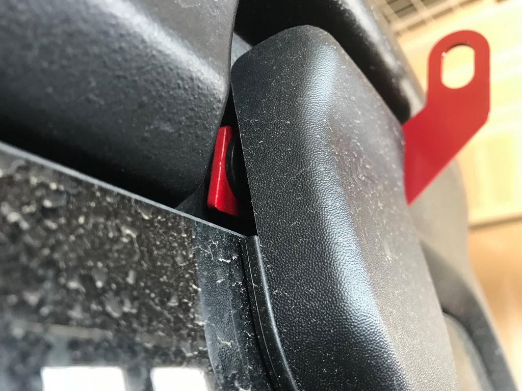

Forward most points should be at angle in front of rear window, fairly intuitive. Rear points should be your Topsy brackets ;-)

Look for my post on 07/12-13/2019. My pictures show the 2 straps on the left side (front left and rear left) hook to each other inside the top. The 2 straps on the right (front right and rear right) hook to each other inside the top as well. I used a 12.5" piece of "pool noodle" to cushion each of the 4 corners. I was afraid just hooking the end of the ratchet strap to each corner would snap the corner off.
