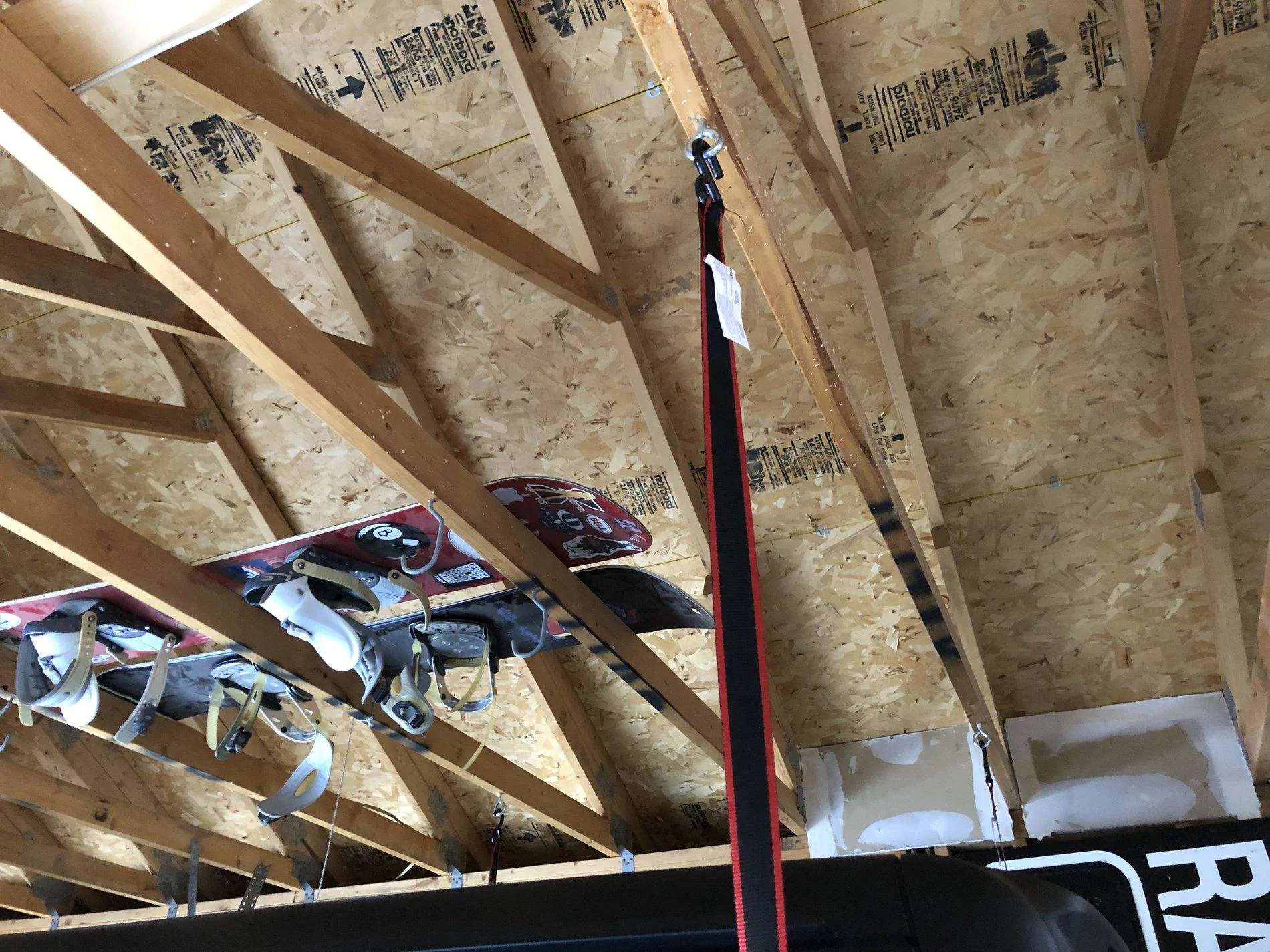

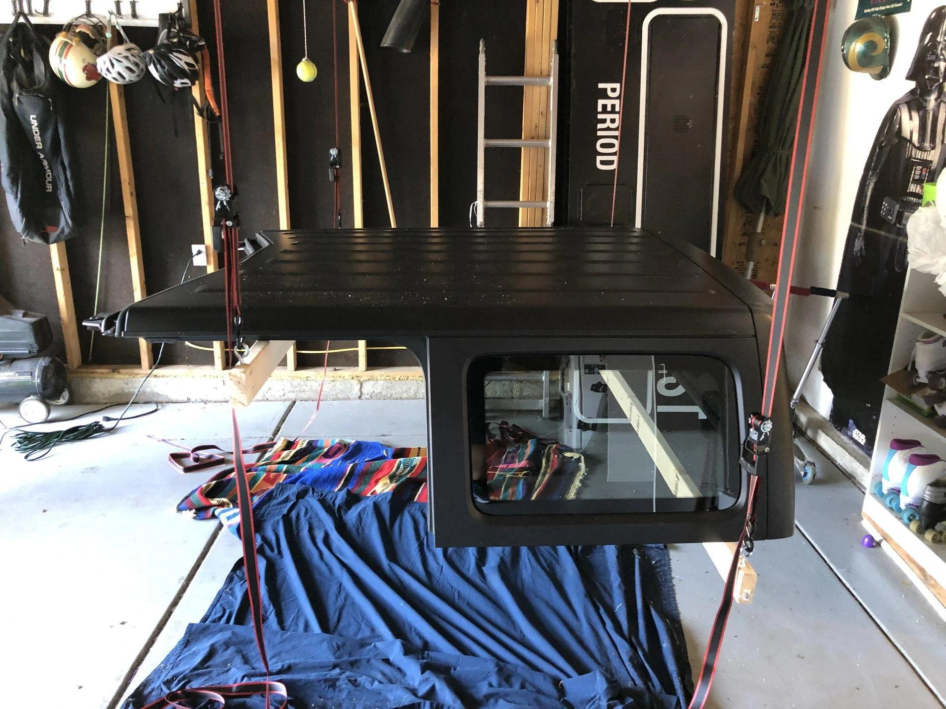

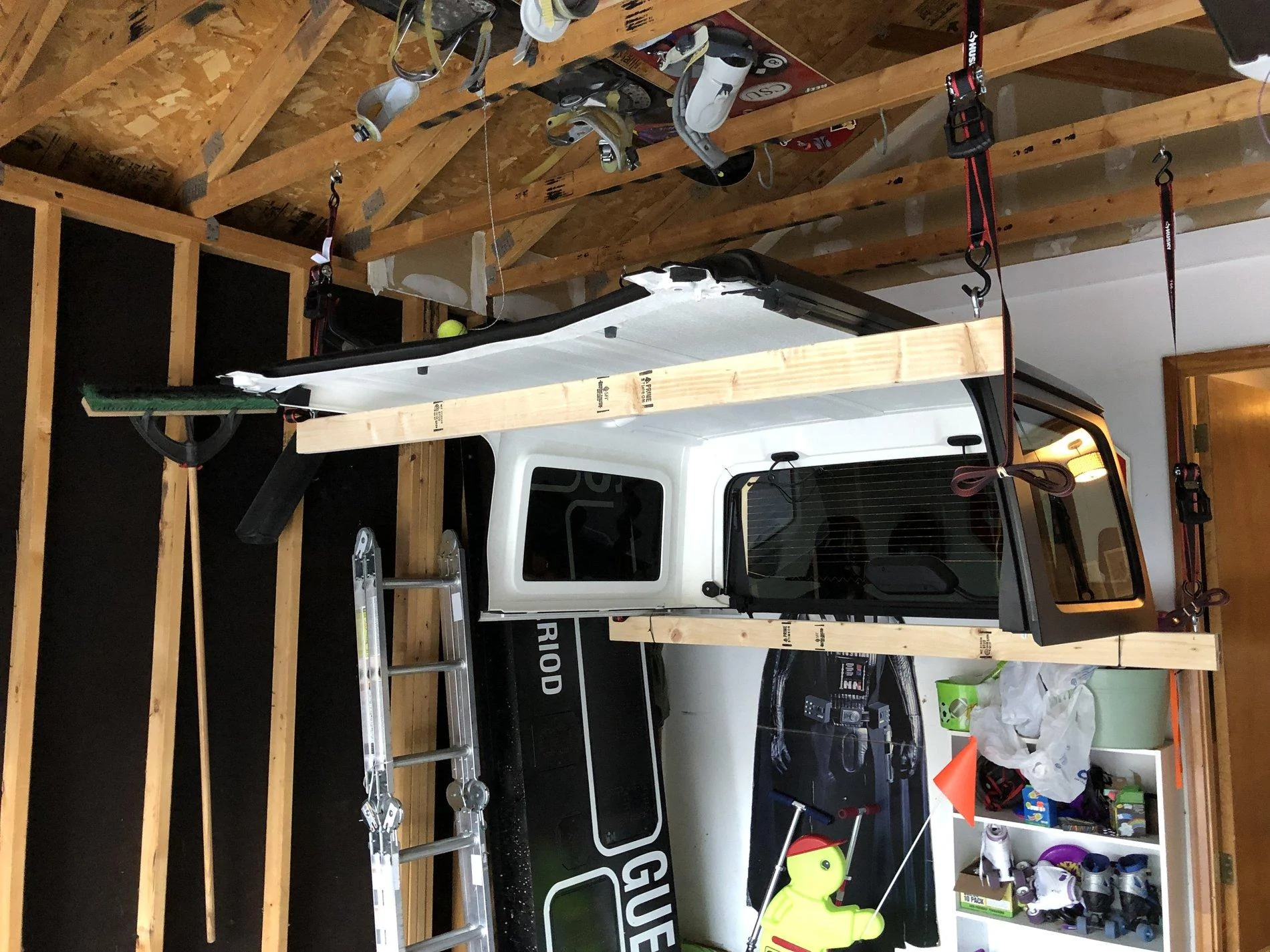

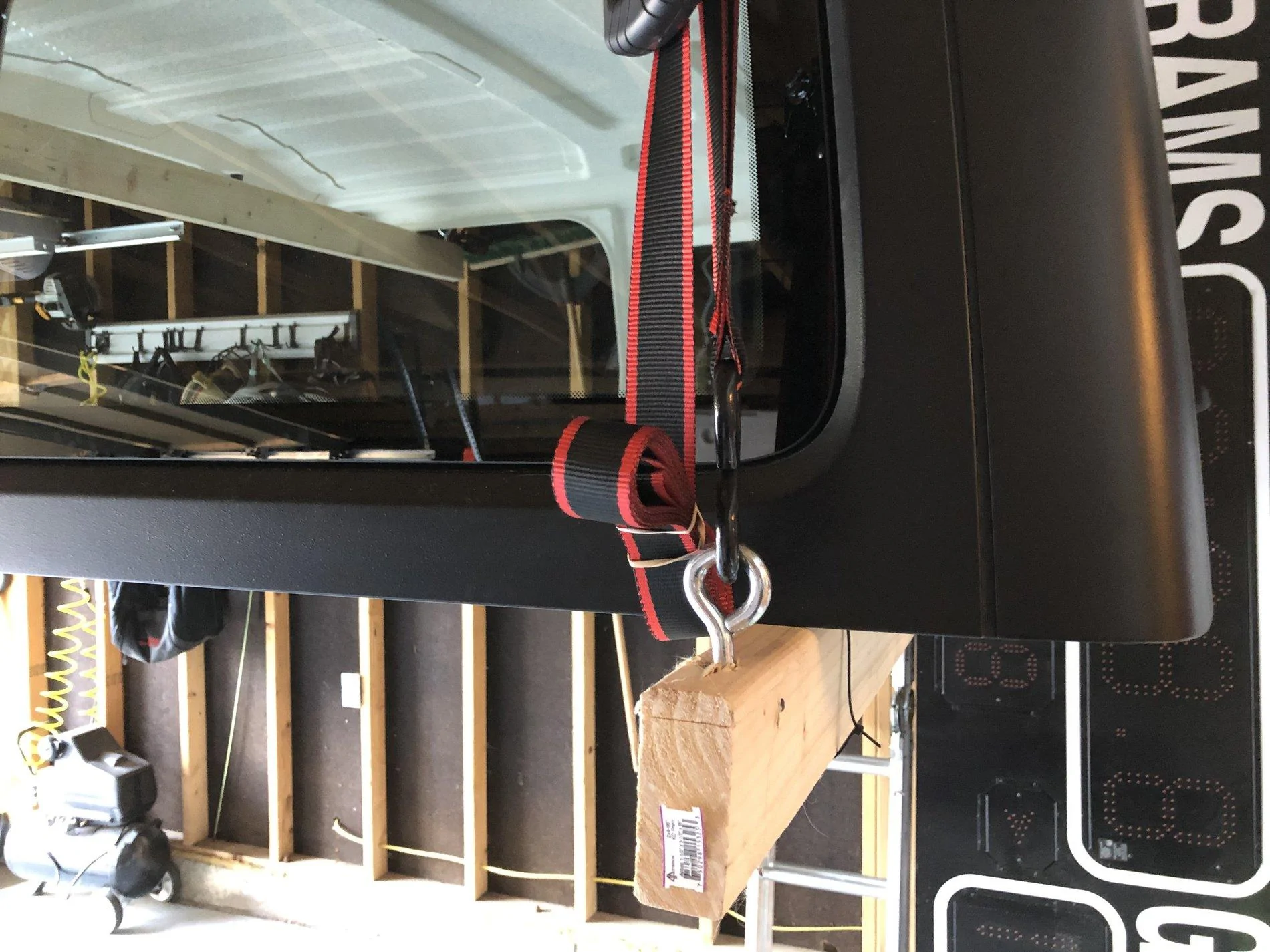

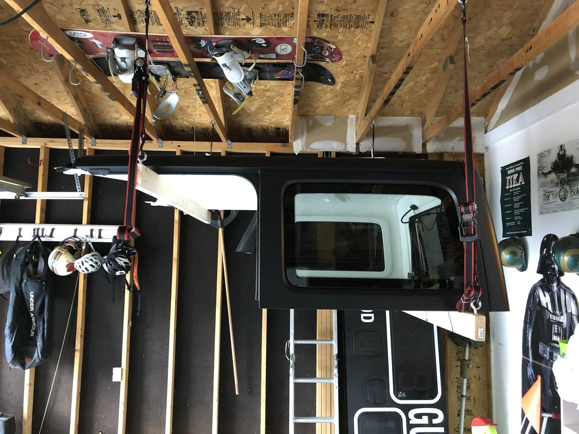

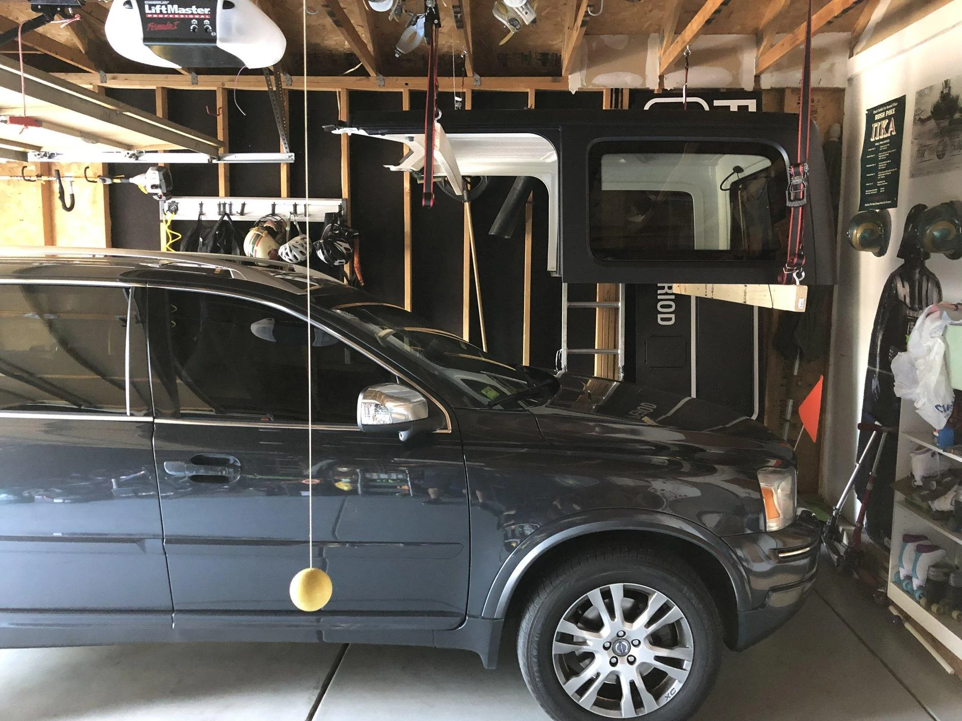

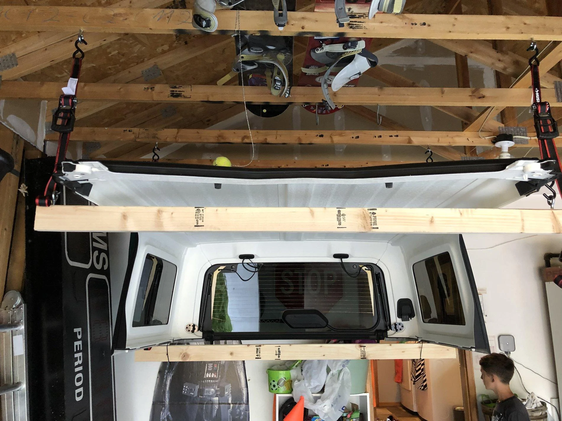

Hey all,
Thought I would share my DIY hard top hoist. Similar in construction to other ratchet hoists on here. Used 4 800 lb capacity ratcheting tie downs (nothing like overkill), 8 stainless eye hooks, 2 2x4’s. All told less than $30 from Home Depot.
Only took about and hour and a half to put together and get it up. I hoisted the roof from the garage floor so took a little longer. Easy peasy. Looks good and I’m happy with it. Some pics included. BTW, I park my wife’s Volvo under it just in case something goes wrong at least the Jeep will be okay.
