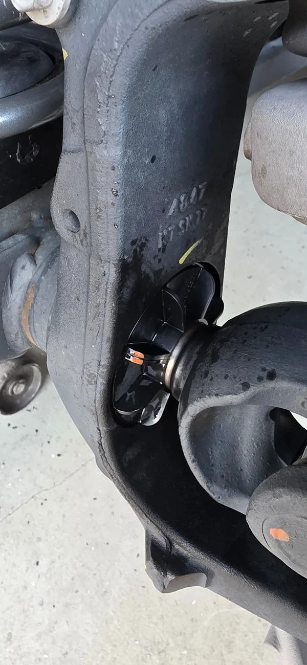

I was having the same problem and also took my 2021 Jeep JL Wrangler to the dealer, with no luck. They said it's normal. I ended up pulling the wheel off and found out where it was coming from. On the outerside of each axle there is a hard plastic fin dust cover that spins freely and keeps the dust from getting into the axle. When I first spun it, it actually made a squeaking noise....tada, that's it. I ened up putting silicone spray on both Divers and passenger side. Drove it at low speeds with success and no more squeaking. Hopefully this solves your problem as well. Attached is a photo of the finned dust cover and a video after putting silicone on it.
