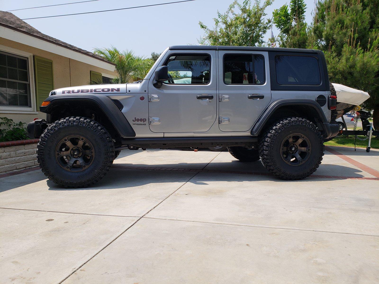

I have the RE kit. I talked to them about it while at the LB off-road show. They said the springs are 5% stiffer than stock, helping with extra weight (winch, big spare tire). I drove it a while with shock extensions and OEM shocks as the RE shocks weren't available. it worked pretty well. I ended up finding Mopar Fox shocks and that firmed up the ride nicely. I have since gone from stock wheels with 35's to fuels with 37s and couldn't be happier. I also talked to the Fox people while at the show, they said the Mopar shocks are not the same as the off the shelf 2.0s. They have many hours of R&D time in the Mopar shock, and the body is steel, not aluminum like the Mopar, and the piston diameter is 1/2" smaller.
I would guess they perform very similarly if the Mopar shocks were used.
Jeep Wrangler JL Mopar lift compared to Rubicon Express 20180811_124635
Jeep Wrangler JL Mopar lift compared to Rubicon Express 20180811_195933
Jeep Wrangler JL Mopar lift compared to Rubicon Express 20180812_080336

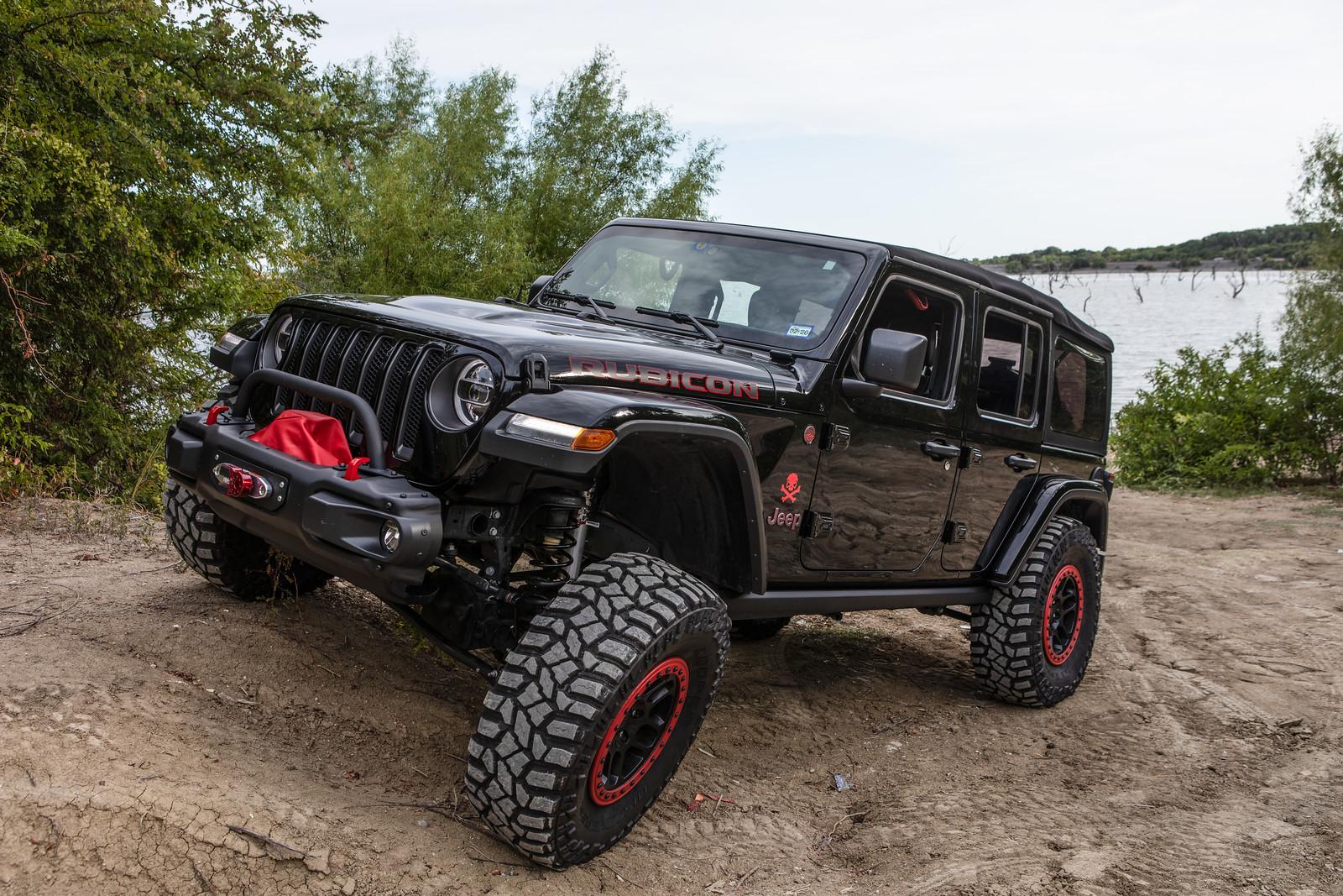

The shocks that come with the RE kit are not the same shocks as the Mopar kit. They are the smaller shocks that are available everywhere. The Fox shocks that come with the Mopar kit are ONLY in the Mopar kit. They are considerably larger diameter than the other Fox shocks.

Is it just me or does it look like the front is considerably taller than the back?
Did you measure to both fender flares before and after the lift?

I didn't, but it does appear a little higher, likely because of the expected weight of steel bumper and winch. maybe the front bumpers are higher?

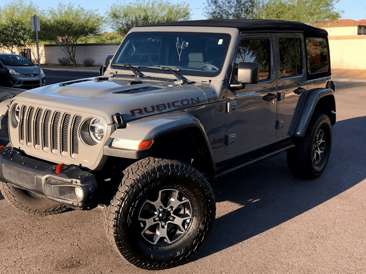

I just installed the Mopar 2" and I'm running 35s - I have a JLUR. My 35s look like the stock 33s again... and the ride still feels stock.
Also found it on Amazon for $1,100 - 24 month finance and NO TAX - can it get any better than that? Nope.
Jeep Wrangler JL Mopar lift compared to Rubicon Express upload_2018-9-5_13-19-20
