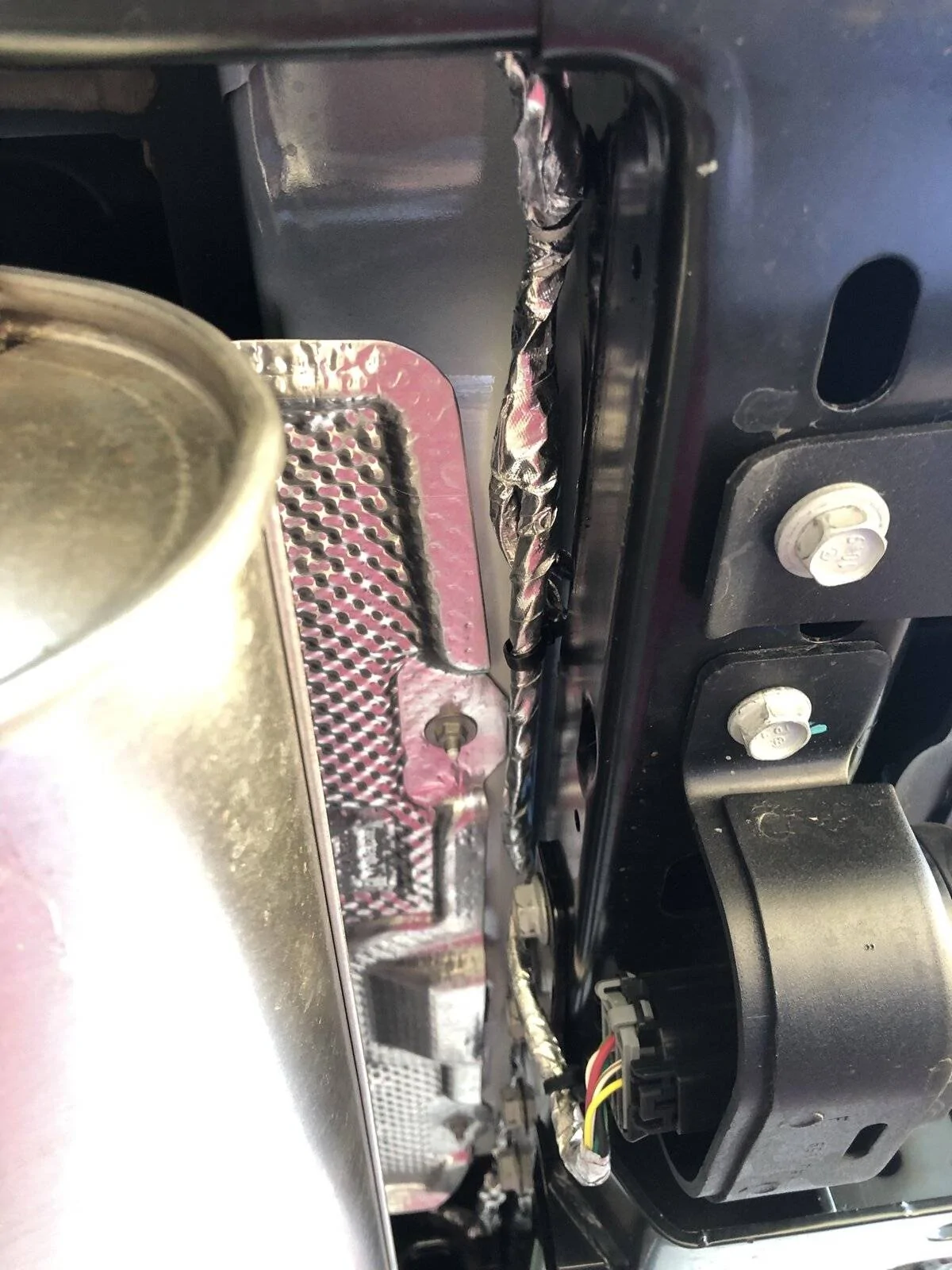

Sorry for the slow reply. I didn't use any of the heat shield tape in the engine compartment since the existing harness I followed up from the firewall did have any on it. I only used it for the rear section that ties the taillights together that runs close to the muffler. Here's a picture for the rear section. I hope that helps if you haven't completed the install yet.

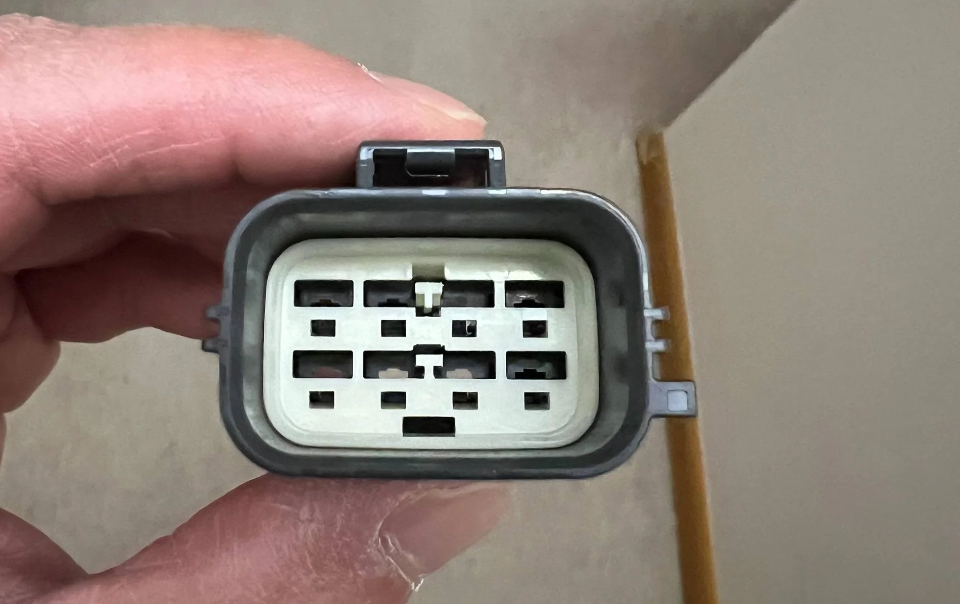

Has anyone been able to get the white lock out of the plug on harness A?
I just had the same issue, doinking around with that connector for an hour, I finally figured out put a small screw driver in the large slot inside the connector and pry up, it will pop right back up. It does not come all the way out like the picture in the instructions. Also I did not have to remove all of the parts like the instructions show I was able to fish the cables along the paths with a snake. And was still able to secure the cable in many locations. Really expensive harness but it is a Mopar Part made for the JL.

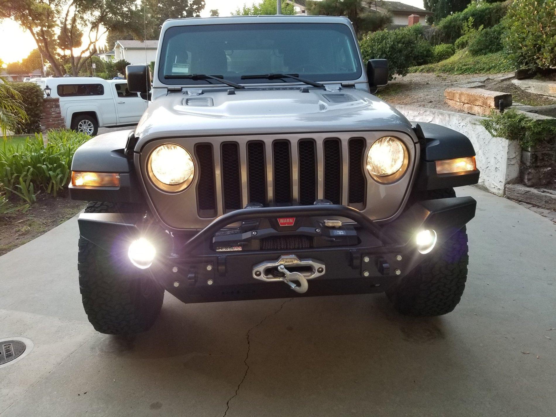

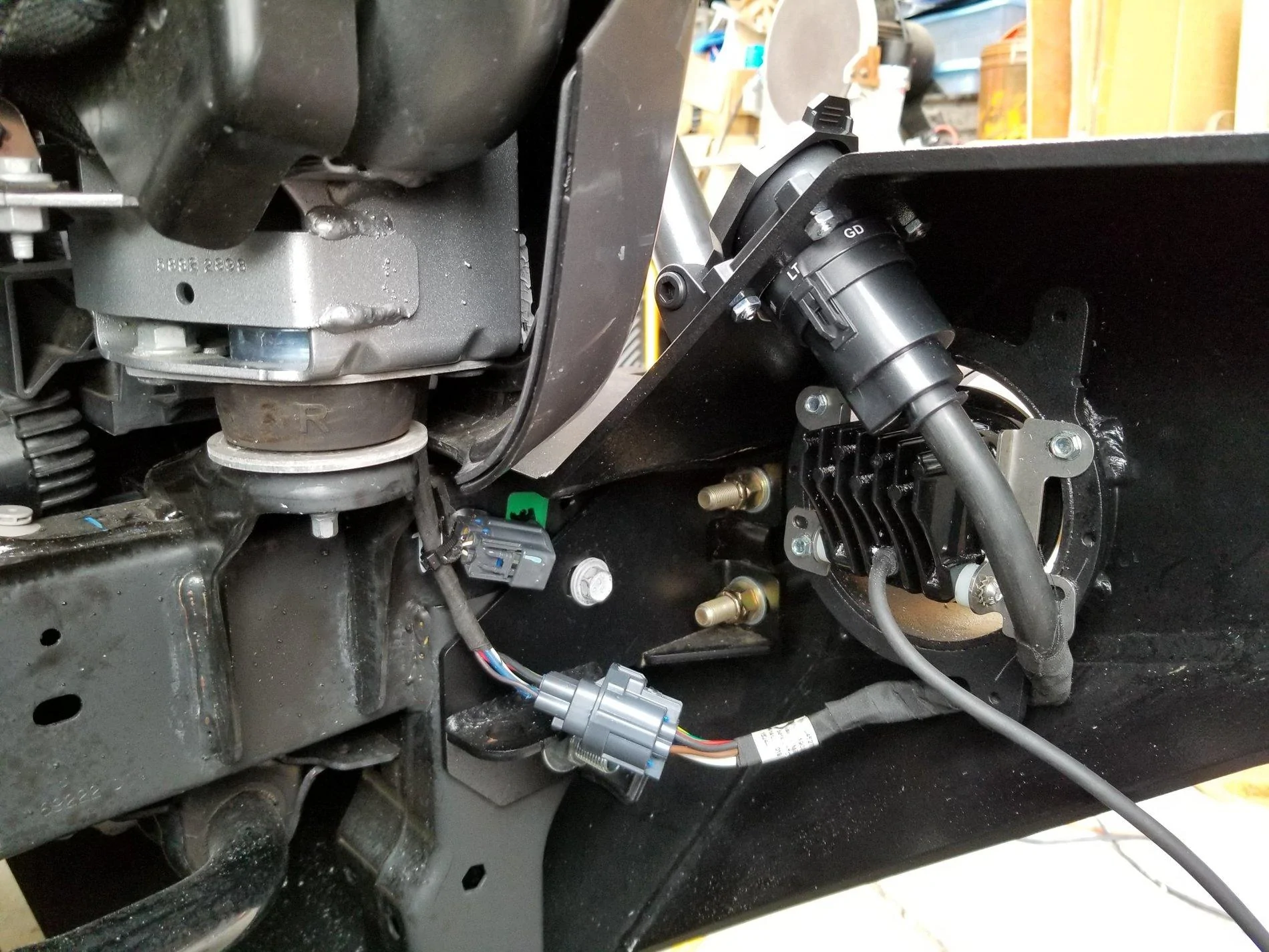

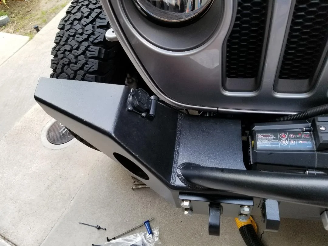

I finally got the parts to install the socket in the bumper. The bumper is aluminum, but it still was a chore to cut a 2" hole in it. I'm satisfied with the way it came out. I debated putting the socket in another location, like outboard of the fog light or below it. I took the tow vehicle to toad cable supplied with the Mopar kit and cut the end off that had the Mopar proprietary connector and hooked it behind the socket I bought. That allows me to unplug it if I remove the bumper.
While I was doing this I took the time to install some Baja Designs Squadron Pro combination beam lights with 4500 lumens each. Lots of light.
PapaRubi, could you please share which slot you are referring to in the pic below, and which side is up when you say, "pry up."
