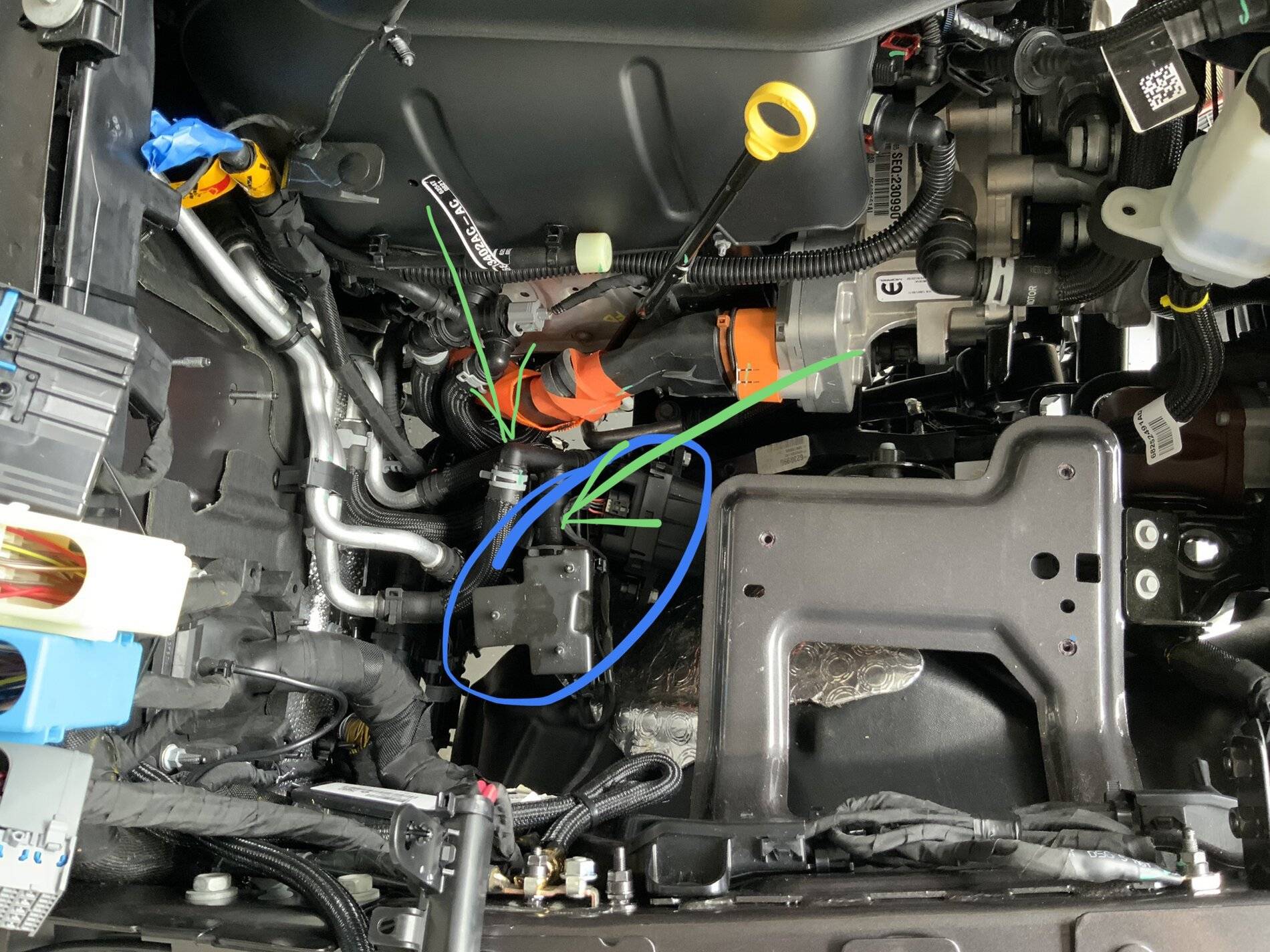

@Senrusho, I’m not sure that this approach will work:
Based on my understanding so far, I think you can just use some heavy duty zip ties to secure that loose piece up to the bottom side of our new battery tray.
When I had mine apart, with the OEM battery tray and fuse panel removed, those coolant parts (circled in blue in picture below) that are looking for a place to mount to, are connected to coolant lines (see green arrows in pic below). There isn’t much play in those coolant lines. My original plan was to simply drill 3 holes in the bottom of the Genesis tray, and bolt the parts to the bottom of the Genesis tray, using some bolts with low-profile heads. But when I pulled on those coolant parts to lift it up to the height of the Genesis tray, it was placing too much strain on the coolant lines. That little coolant pump (or whatever that thing is), naturally wants to sit a few inches below the Genesis tray. That’s why my solution involved bending that DIY bracket a couple of times to create a space between the Genesis tray, and the coolant parts that I was supporting.
So, I don’t think you’d be able to snug up a heavy duty zip tie to bring the coolant parts up to the bottom of the Genesis battery tray. And while a large, heavy-duty zip tie could certainly support the weight of those parts as a temporary fix, I wouldn’t want them bouncing around as a permanent solution.
That having been said, maybe there’s another spot that I didn’t see - where you could secure those parts.
Here’s that pic:
Here’s that pic:
Great info, thank you for the clarification!

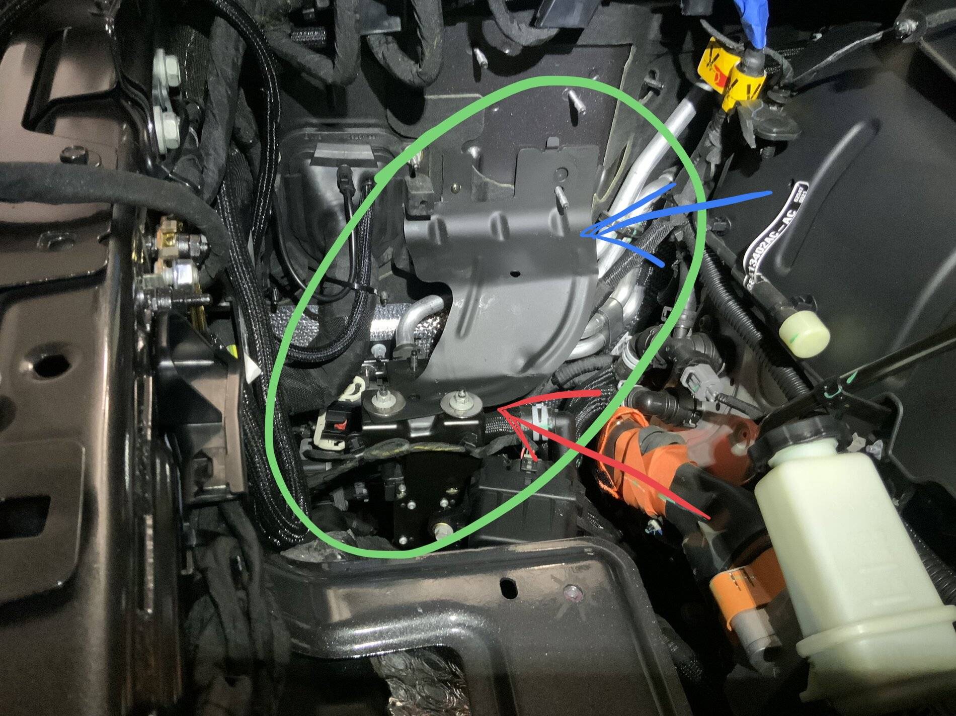

Here’s another pic that shows the height differential. This is the DIY bracket, with coolant parts mounted, just prior to me putting the Genesis tray in. I’ve marked the height of the bottom of the Genesis tray with a blue arrow, and the height of the coolant parts with a red arrow. I can’t recall exactly, but I’d guess it was a 3β€œ or 4” difference in height.
That's a lot lower in there than I was thinking. I was picturing it just barely below the tray. Thanks again!
You’re welcome.
Yeah, I thought the same thing. I was all convinced I could secure it to the bottom of the tray, then when the coolant lines didn’t reach, I had to go to plan β€œB” with that bracket.
The deceiving thing is those coolant parts mount to the bottom of the OEM battery tray - so logically, one thinks the Genesis tray should be roughly the same height. But I think the issue is Jeep uses the same battery tray in the 4xe, that they use in the non 4xe Wranglers that have a small auxiliary battery under the main battery. That small aux battery resides in a recessed area of that tray that sits a few inches lower than the base where the main battery sits. Even though the 4xe doesn’t have a small aux battery under the hood, it does have the same OEM battery tray with that recessed area in it, and that’s why those coolant parts have to sit a few inches lower than the Genesis tray.

Jeeperz Kreeperz,
I installed my kit today and did exactly what you outlined to do with that leftover bracket. It worked perfectly and my kit is in, with the coolant lines (the pedestrian warning speaker is also attached to that bracket those coolant lines are on for some reason) supported. Thank you so much for your help, and very thorough documentation.

I probably should have tagged Genesis so they see it. My only concern on the mod that @Jeeperz Kreeperz did is that it looks like it is only supported on that one side? I am sure the metal is strong enough to hold it, but didn't know if it was held up on the other side or not.
Seems like an "easy" thing to have three holes or mounts included on the battery tray so that part can screw in. If you don't have a 4xe then you wouldn't have to mess with it, but I am no engineer.
Slate
Jun 24, 2022
445
398
Kentucky
'ΜΆ9ΜΆΜΆ7ΜΆΜΆ ΜΆWΜΆΜΆrΜΆΜΆaΜΆΜΆnΜΆΜΆgΜΆΜΆlΜΆΜΆeΜΆΜΆrΜΆΜΆ ΜΆSΜΆΜΆpΜΆΜΆoΜΆΜΆrΜΆΜΆtΜΆΜΆ, '21 Willy's, '23 Rubi 4XE
Ok, looking at the photo a little closer, I see two bolts on one side of the "arm" and another on the other side. (That fin-looking piece.) So that looks like the coolant parts are centered, which means it shouldn't flop around or bounce as I had originally suspected.
