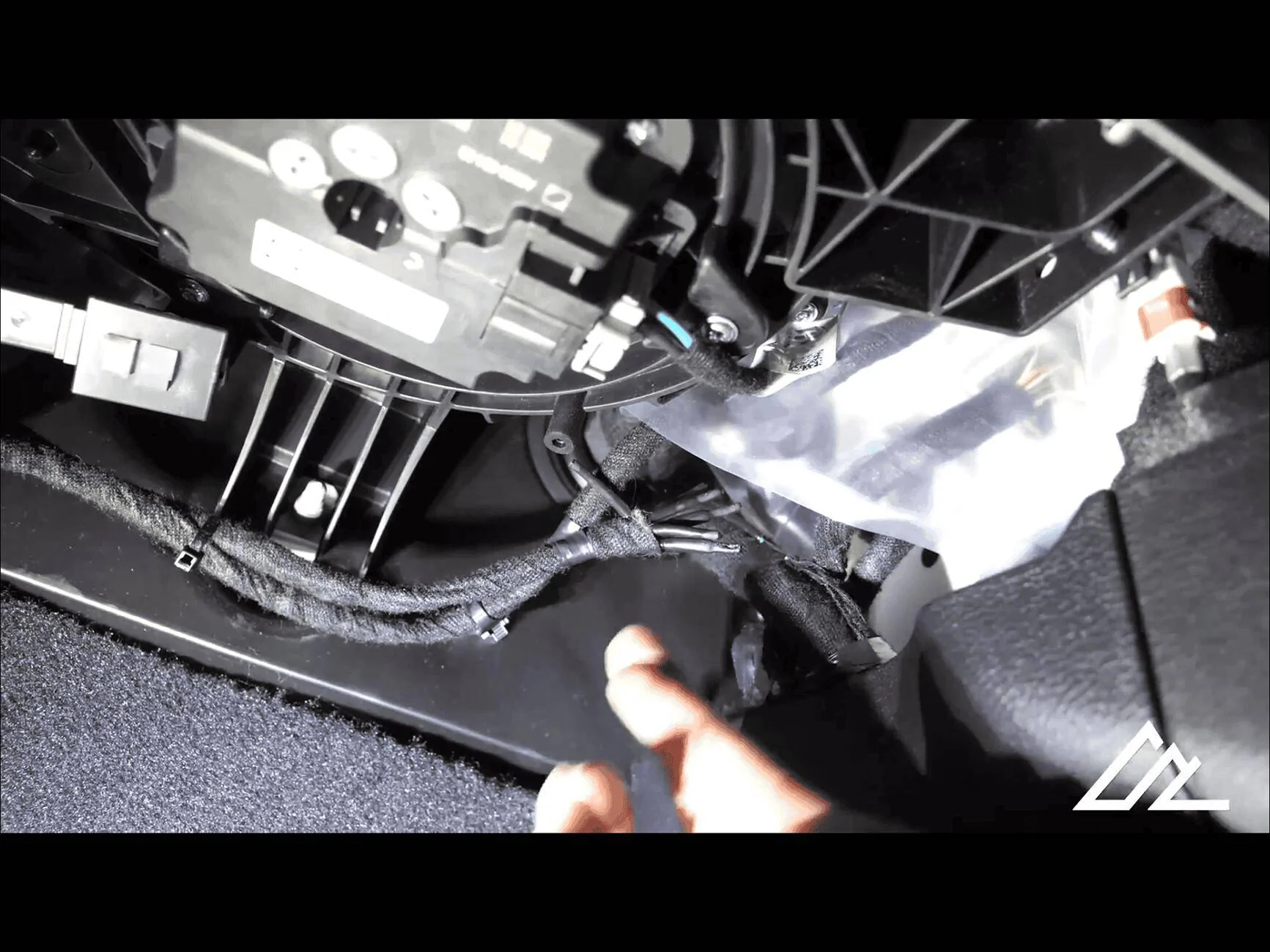

They’re still usable, just shorter I suspect. Check out this video from @Northridge4x4

Here’s a pic of the interior aux wires at the top edge of the carpet under the passenger side dash near the HVAC blower motor. My wiring bundle was folded over and terminated closer to the center console. This bundle also includes a battery positive and ignition positive in addition to aux 1-4
