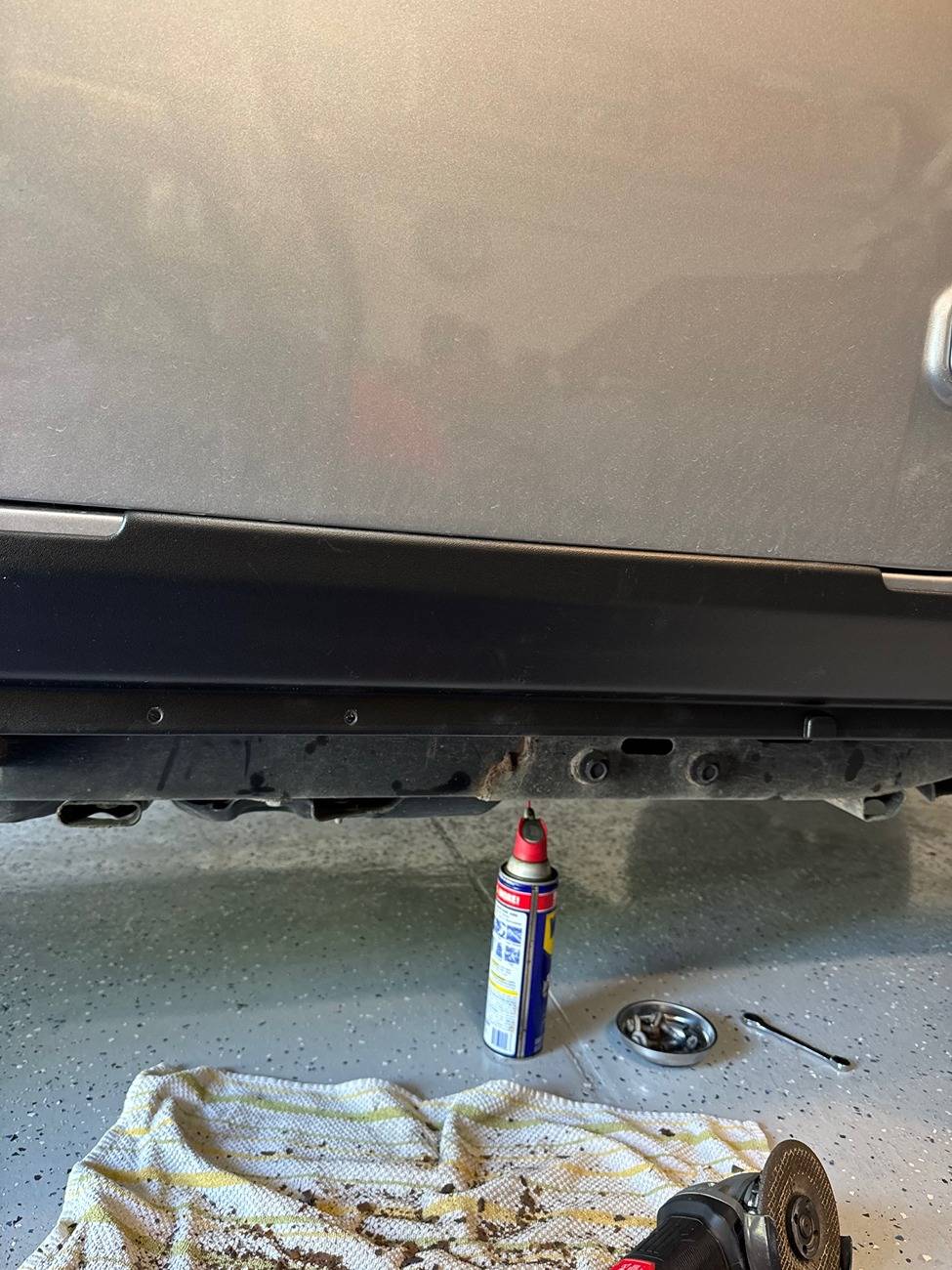

This is my 1st post so hopefully I did it correctly.
Not looking for advice, just sharing what a see is going to be a big problem for us JL owners that live in the Rust Belt area.
2018 Jeep Wrangler JL body, 85k miles, Michigan Driven, never off road, washed weekly all winter.
Both front door Sill plates were found to have huge rust areas while doing spring cleanup.
Our last JK was over 12 years old and had no rust at all (other than gas tank shield...).
Amazed that this happen – I called Chrysler customer line, and they told me because I purchased a Chrysler Factory company vehicle, they would not even make a customer care case for me.
Looking at JL’s in local parking lots – I’ve seen a few with same rust pops in same location.
When I called a local dealer body shop – I was told this repair it a huge repair as the metal from this sill plate extended up into the A post, more than $6,000 repair to do it right. Local body shop advised me there are no “clip” panels available yet, we would have to buy complete rocker assembly and then cut out enough to make repair buy cut and splice new part in. less than replace complete rocker but no price quoted. I did not ask either body shop for a complete written estimate at this time as both would require tear down to make a good estimate and by this time, I knew we were not going to sink this kind of money into this problematic vehicle (many, many other repairs have been done already).
I did notice that the area that rusted out did not have drains. The areas that did not rust have drains – design flaw?
My fix – I cut the rusted area out and treated the area with CorrosionX Heavy Duty Anti Rust, then Covered the holes with Rough Country Rocker Sill Plates.

This is probably the best solution I've seen so far. Got a link to those Rocker sill panels?
