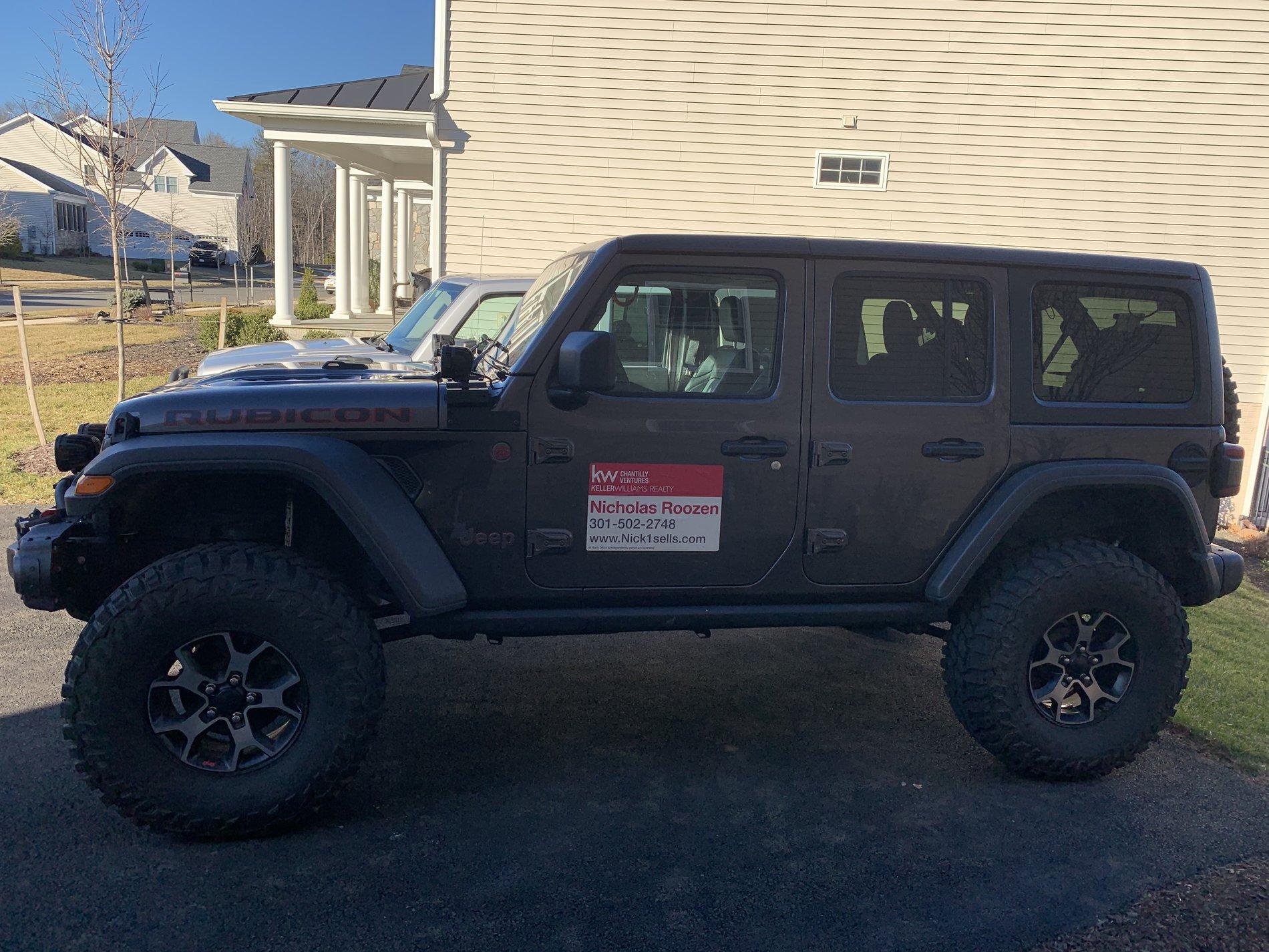

hey. Who made your signs? I’m getting my JLUR next month (hopefully lol) on order and my realtor magnet signs from the JKU aren’t gonna work.Metalcloak 3.5 Installed so far so good I won’t have a chance to off-road it for a month or so but for a big lift and large tires it still drives really well.
