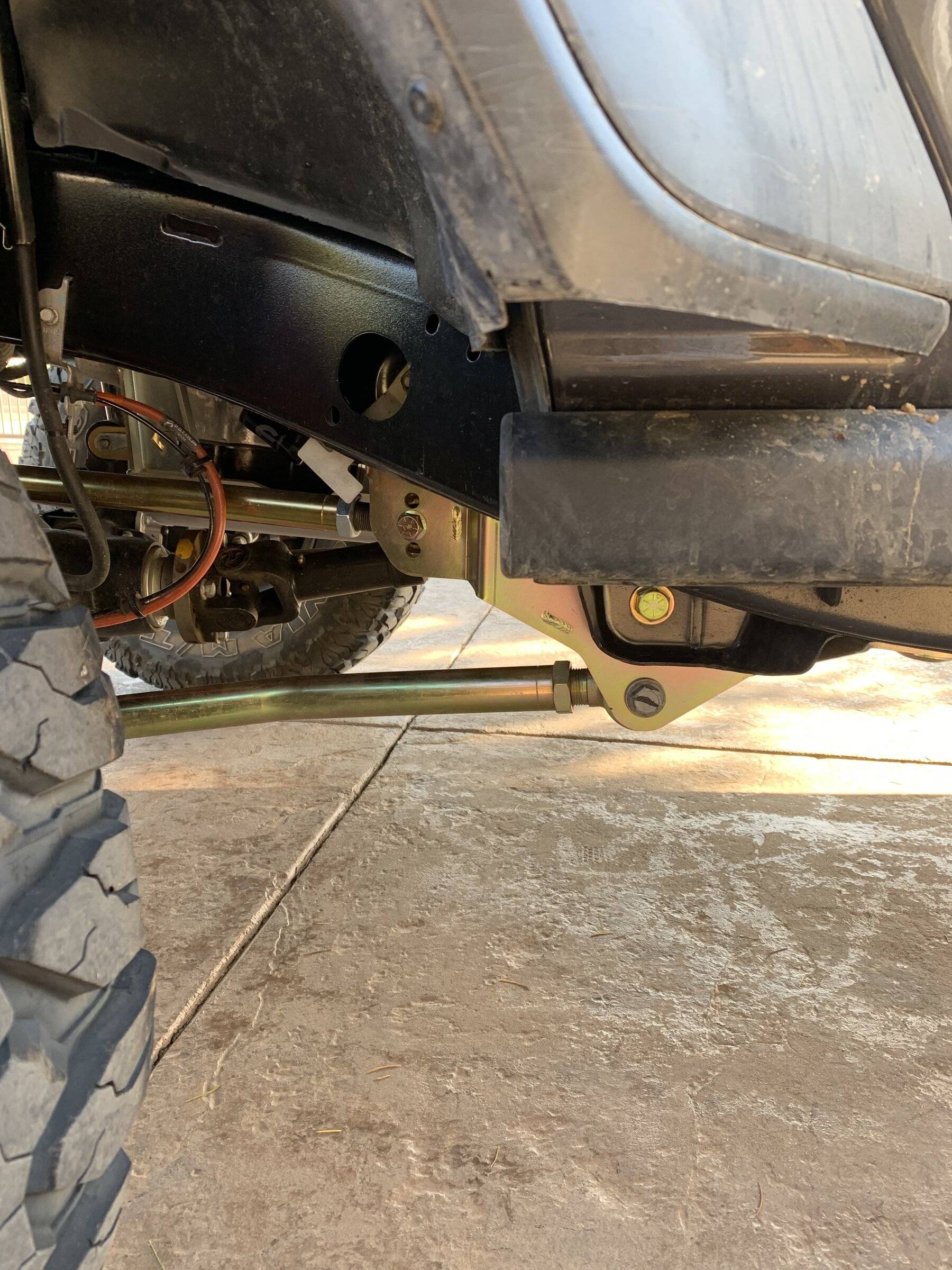

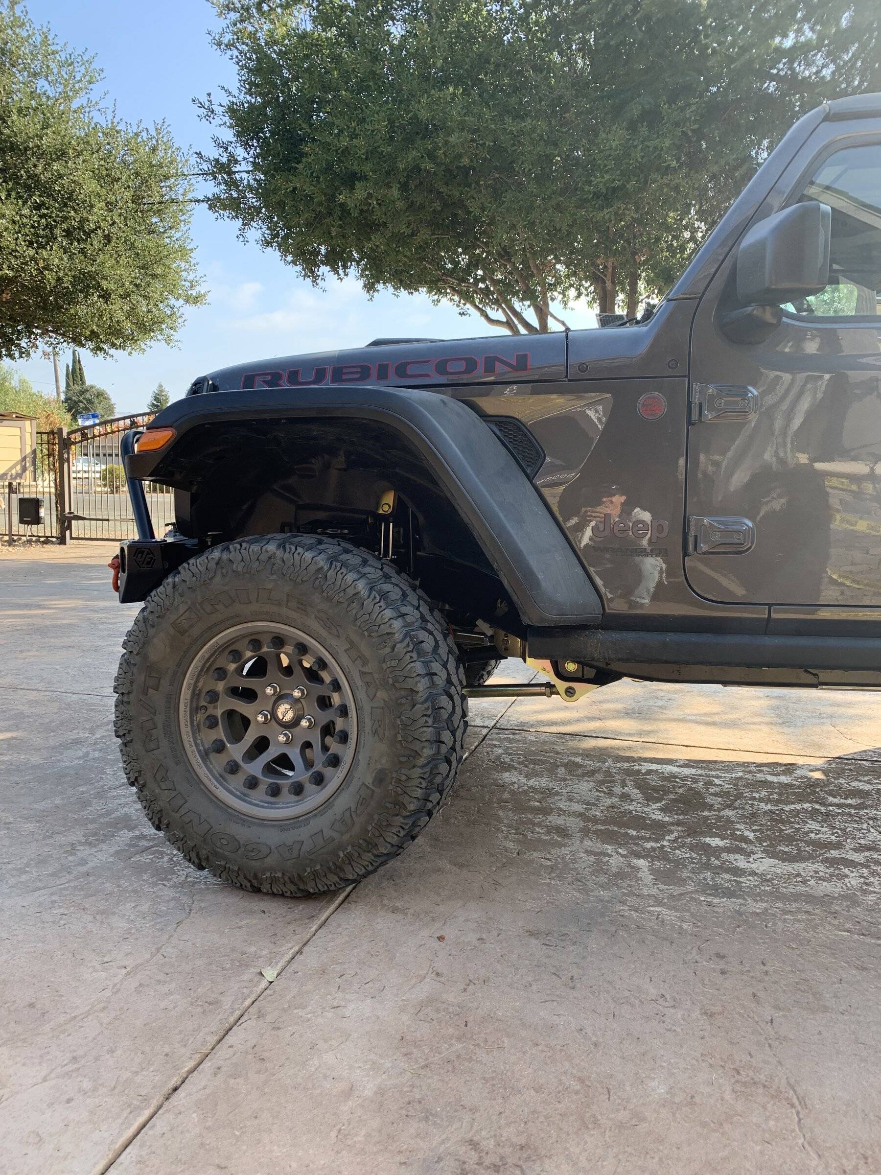

I installed the front drop brackets on my JL with a 2.0 turbo and Metal Cloak 3.5" lift. It does drop your clearance by a few inches but I have yet to hit them off-road running 35" tires. The vehicles drives more like it did in stock form on the street and has better control over small bumps and rough sections off-road. I would definitely use them again. I have no knowledge of the rear brackets though.

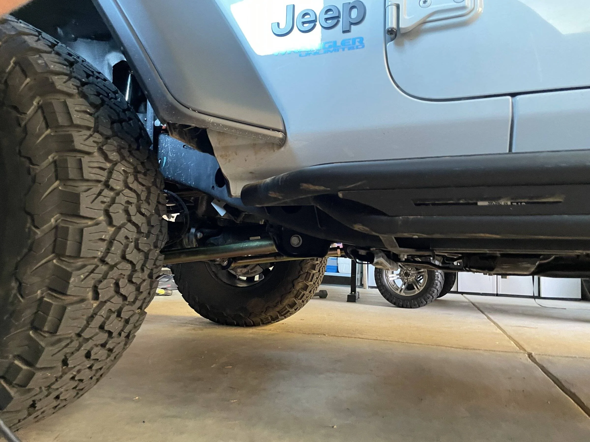

Heres a comparison pick for clearance, smaller lift.
