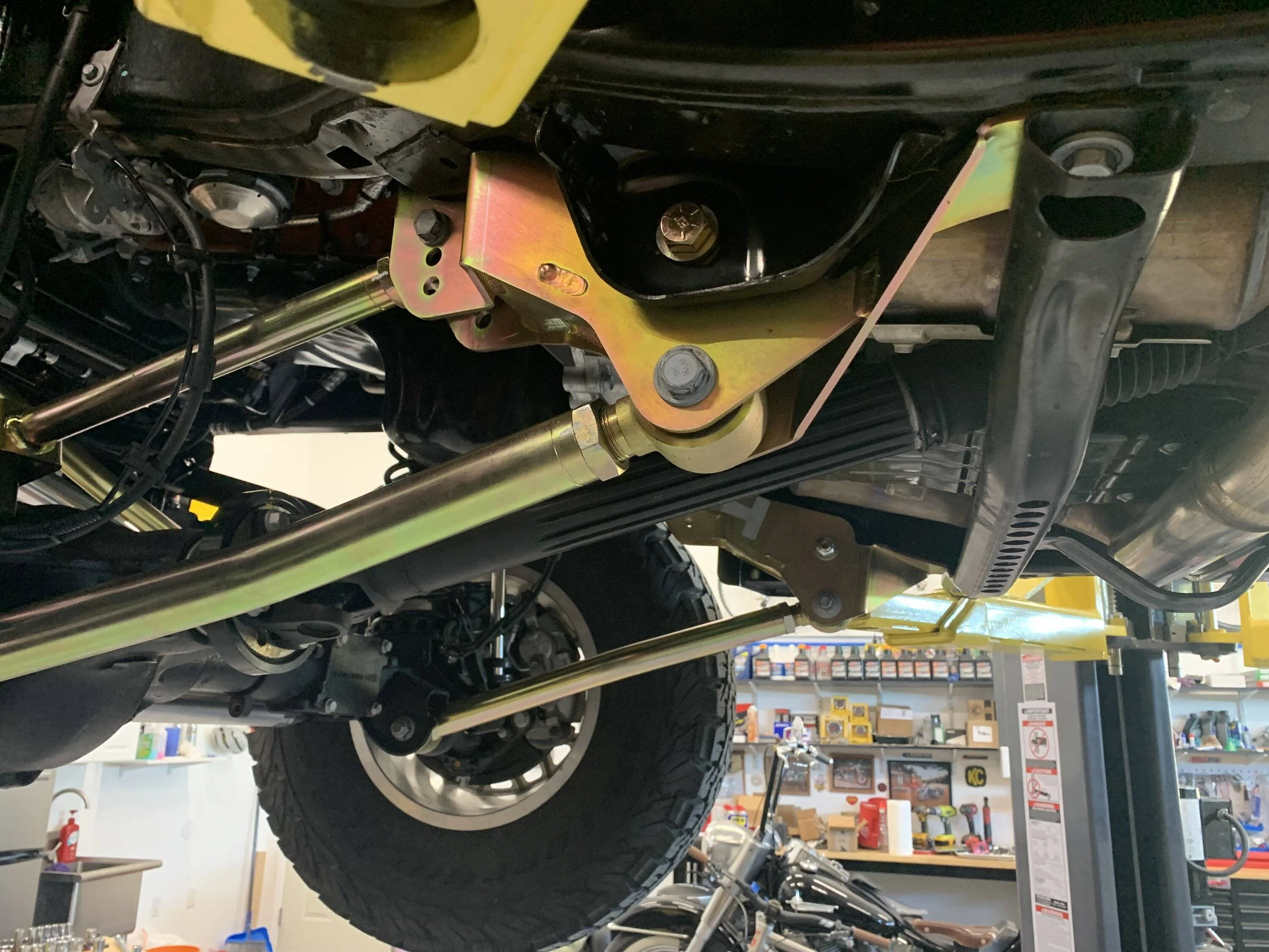

I have my arms at 20"and 24". I have a 2.5 gamechanger. I experimented with a few different lengths upper and lower to see how it would center. This was the best for my set up and gave me 6 degrees of caster.
I highly recommend these brackets to anyone with a lift of 2.5 or more. Improves on and offroad dramatically. I am not always a fan of drop brackets (usually due to being made cheap) but these are very beefy and fit great. Great mod.
