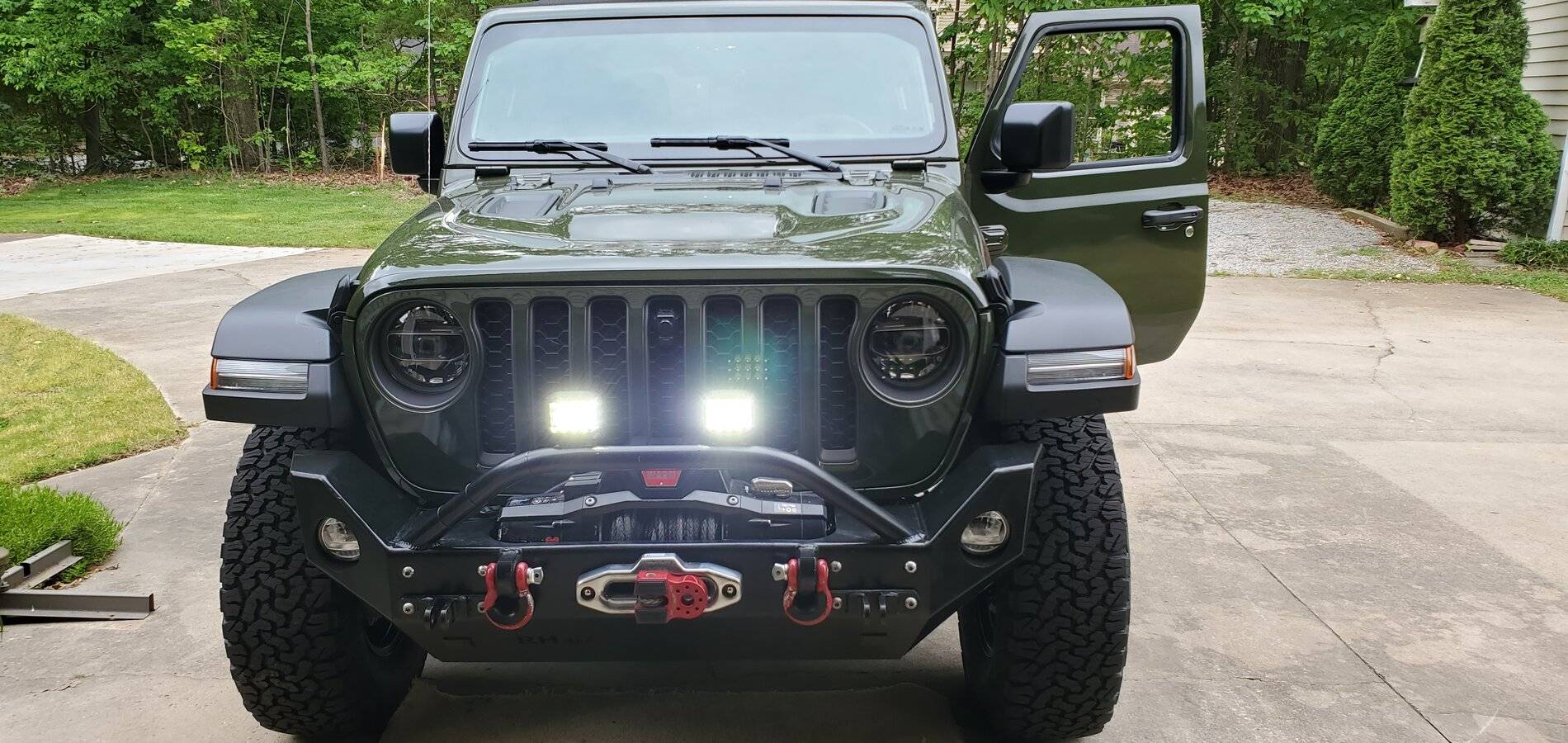

Picked up Friday(ordered 3/22) and took it straight to friends house for him to wrap in clear protective 3m wrap. He's done a number of our vehicles and its saved us a lot of damage. He finished yesterday and got it home where I immediately started with my RockHard aluminum bumper I use to tow behind my RV. Got the bumper and the Warn Zeon winch on last night. This am run the wires, and tighten up all the bolts, etc. Next will be to also install my new 13k lum lights from Rough Country and run wires along side winch wires.

Finished tightening the bumper bolts and mounting the winch. The winch was an absolute "BEAR". Took me about 2hrs as it would not go into the RH mounting plate because of the frame on the 21. Had a hard time with the 2018 but not near what this 21 gave me. Required a lot of grinding and attempts before done. Whew!
The RoughCountry lights were a piece of cake. Folks at RC gave me some insights as to how to hook it up to AUX switch 4. Can't wait til it gets dark so I can really see how the 13.5k lumens shine!
