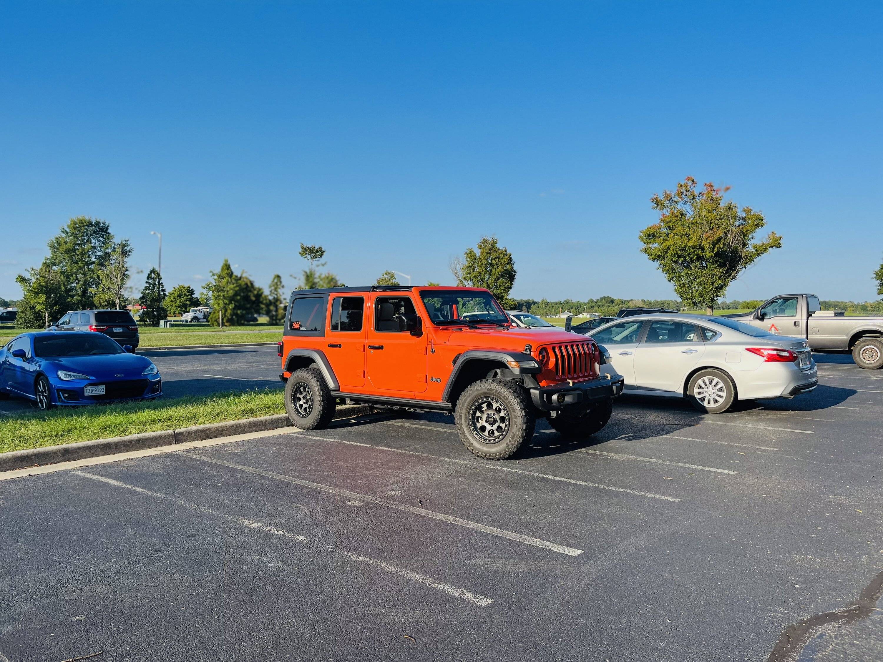

Jks1.5 lift works great for mild trails, reducing body roll, smooth driving
Jeep Wrangler JL MC vs JKS Springs 046F5D7B-D6D5-4E0B-BFEC-ECCD38927BE9
GavinH
GavinH
Gavin
Mar 30, 2023
41
276
139
JLUR
Looks awesome I do love the way this kit looks and about a month after my initial impressions I’ve came around to the lift some more. Other than speed bumps and whoops the kit does handle quite well, its a huge improvement at highway speeds overall just feels tighter and smoother.
Hows your mpg been with this kit? What engine do you have?
JLAFAKASI
Lito
Nov 30, 2020
822
147
Richmond, VA
JlU Sport S 2019
3.6 8 speed Auto 2019 on 33…I figured with a small lift it wouldn’t be a Baja killer haha, but having Fox shocks makes you want drive the Jeep like it is…I can only imaging running the taller springs to give the Jeep more up and down travel…I do plan on running 2.5 springs way down the road… I get 18/19 on highway gearing is 3.45 …from what I read to upgrade just need springs and adjust track bar and bump stops

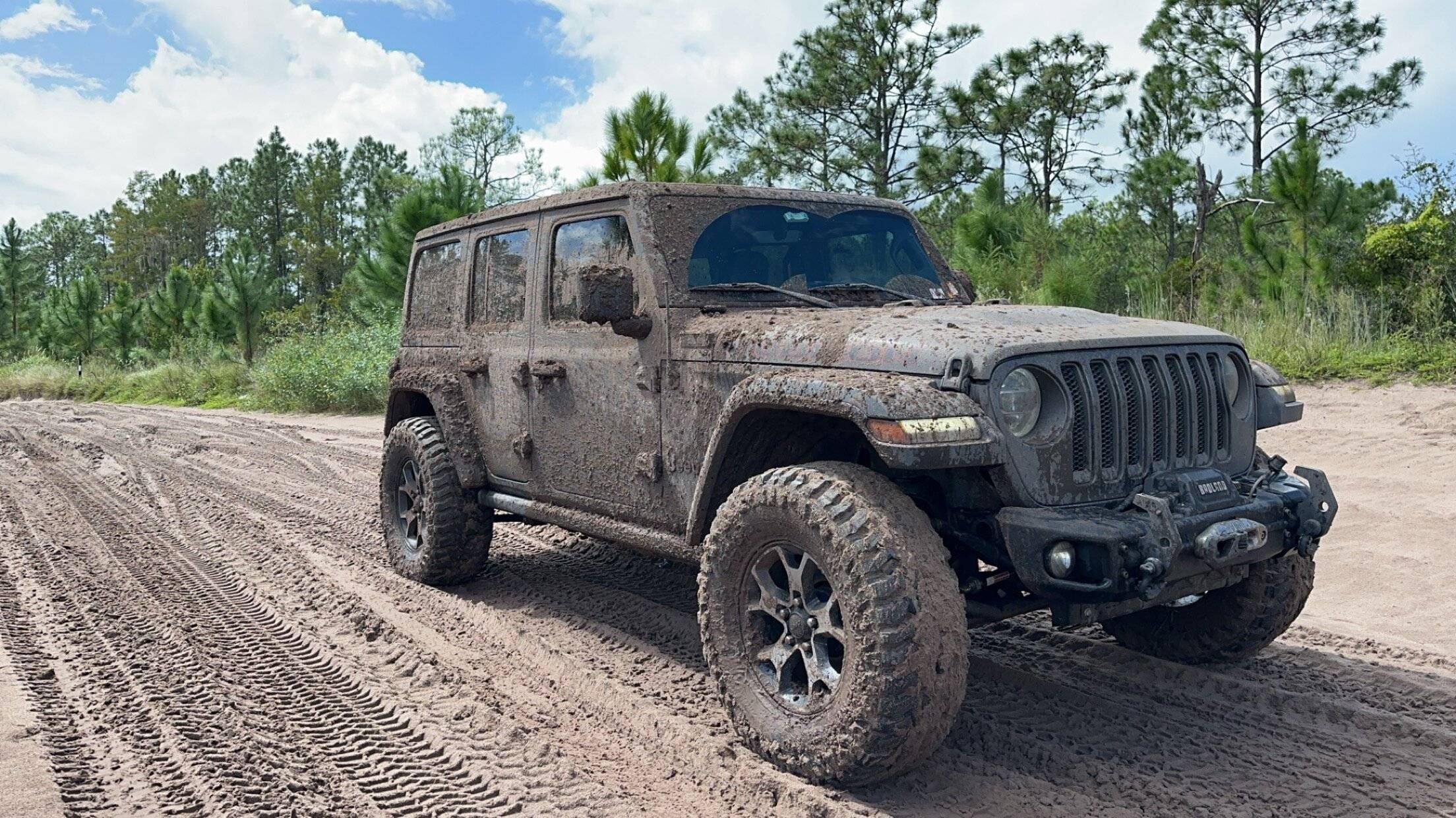

My dash is saying Im only getting around 12-13mpg which I know is an average always being updated. Biggest thing I can think of hurting mpg avg other than it being less aerodynamic than a cow and mud tires is when I go wheeling, I go through some swampy and muddy stuff when on the trails down here often times requiring constant throttle to clear the mud out of my tires and keep me moving through stuff that looks like wet concrete any stoppage and you’re bogged good. But even then I go wheeling about every other weekend with hour drives in between I feel I should at least be seeing 15 or above.
2.0 etorque 4.10 89 octane. Top off with 93 every time before I go wheeling hard so it mixes with 89 creating 91.
