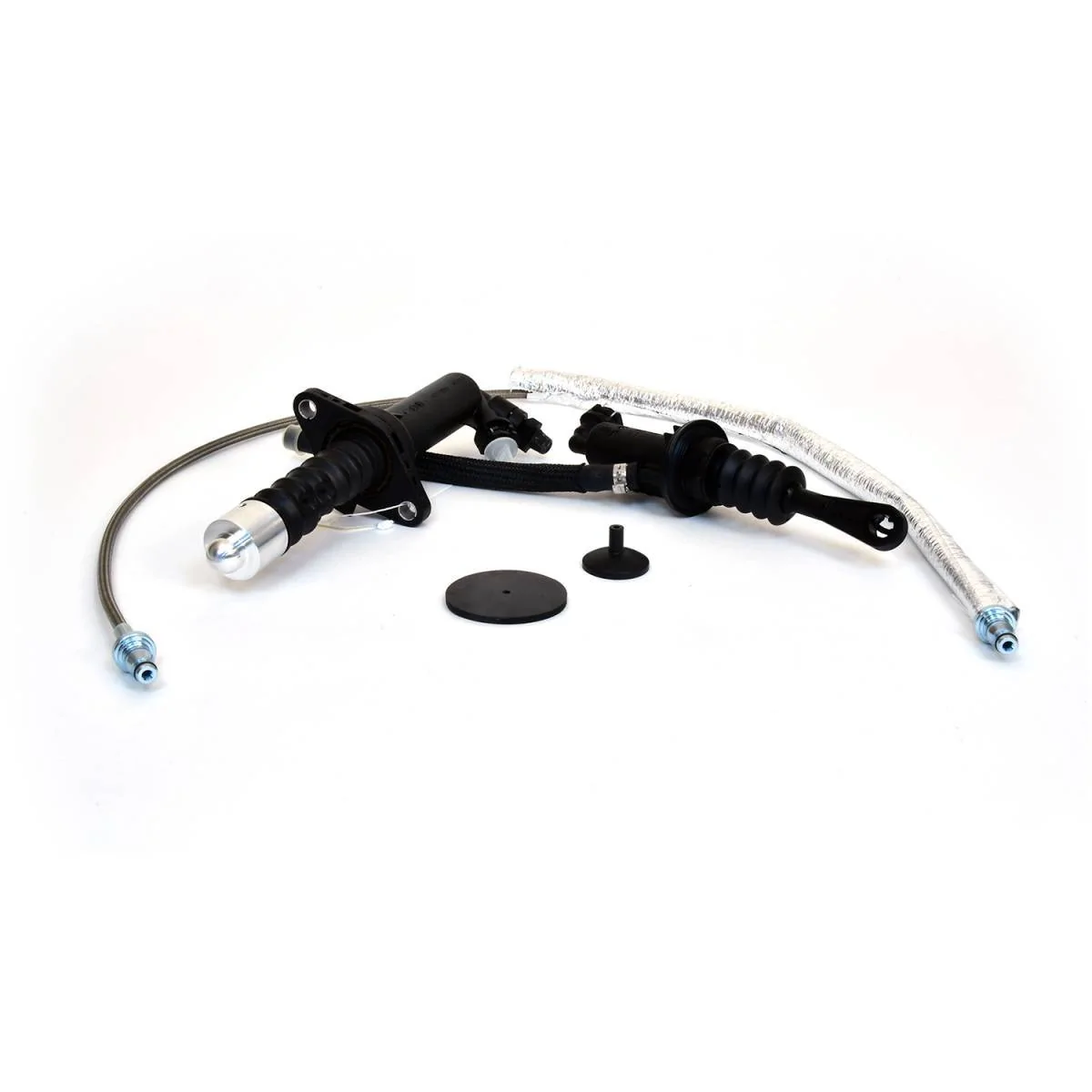

CFII kit is the way to go imo.
Shifts so smoothly, no groans.
Gets rid of the JL factory hydraulics.
sexy.
sexy.
I just sent CF a message asking if this will work with the OE clutch and asking how it's different than the OE master and slave. To me, these look like the OE cylinders, with some minor mods. I just don't think CF made their own injection molds.
If i recall correctly, they are OEM JK hydraulics modified to actuate a JL/JT clutch.

Well, I just bought the Centerforce Hydraulics. Should have them on tuesday. So Im kicking off the new year with some bleeding(hopefully just brake fluid)
