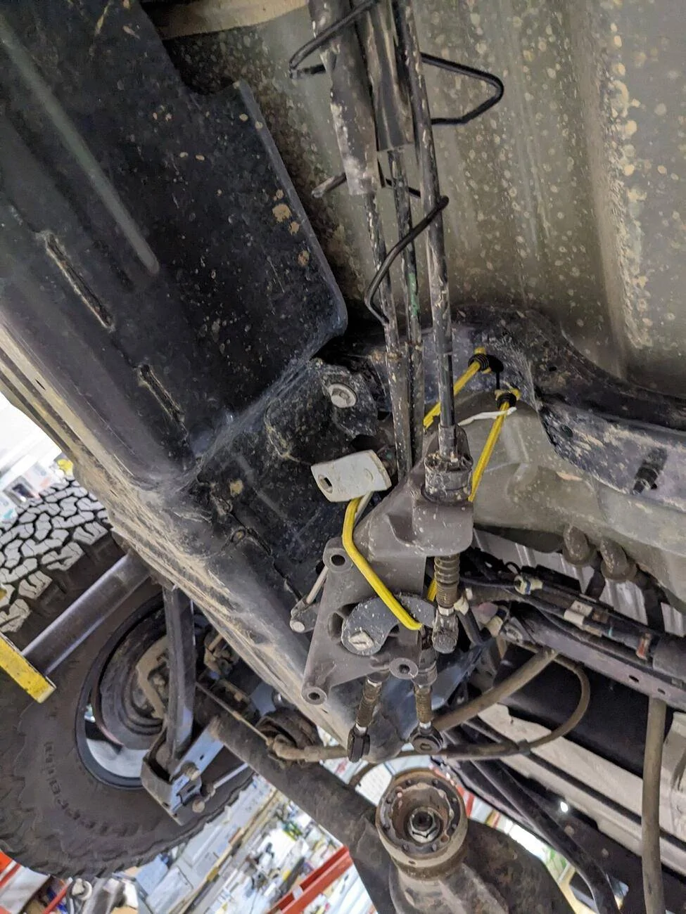

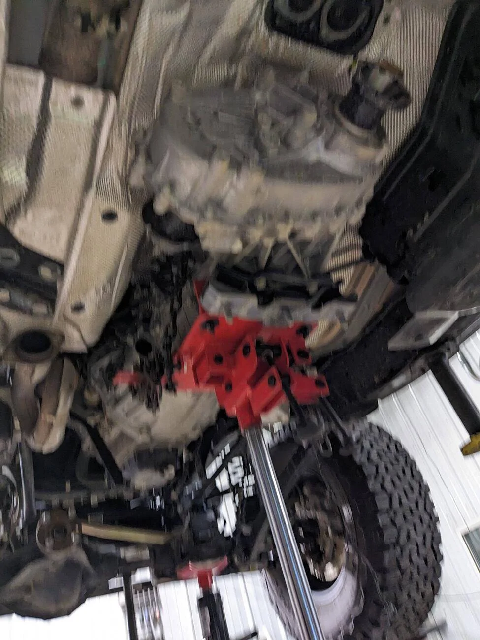

It turns out I did take a pic of the cables and apparently I did take the t-case bracket off, but not the main shifter bracket. Then hung them towards the rear of the Jeep. The pic that should show what I did with the slave is the blurriest one. Looks like it might just be hanging there?
