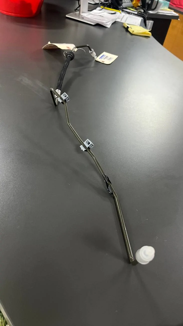

An interesting thing I noticed is that the hydraulic hose from the center force kit is much larger diameter then the combination of plastic and metal tubing from the OEM hydraulic lines. I wish I took a picture of it but the OEM ones almost looked kinked at the bends, which may be why we're having a hard time bleeding those.
Here's an OEM line.

Yeah, replacing that line was one of the big appeals with the CF hydraulic kit.
