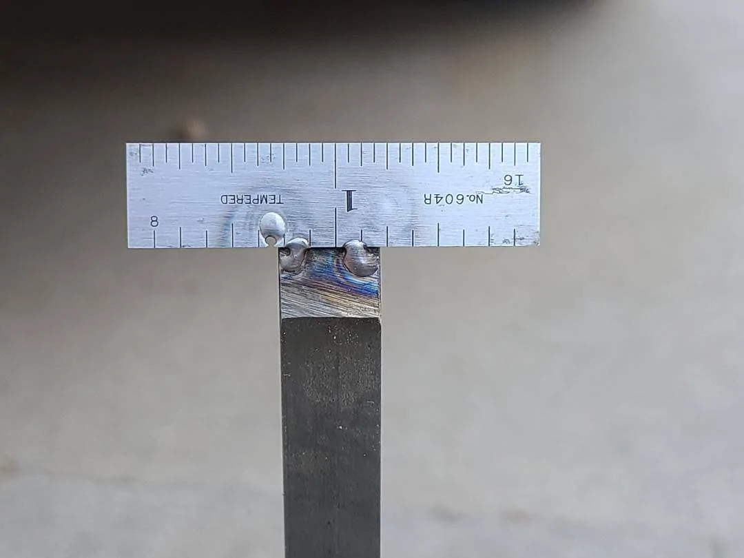

Another was a simple trammel to set alignment toe-in. Finished that this week too. Needs some paint on the square tube and pointers to keep them from rusting.
Jeep Wrangler JL Makin stuff trammel 1
Jeep Wrangler JL Makin stuff trammel 2
Jeep Wrangler JL Makin stuff trammel 3
