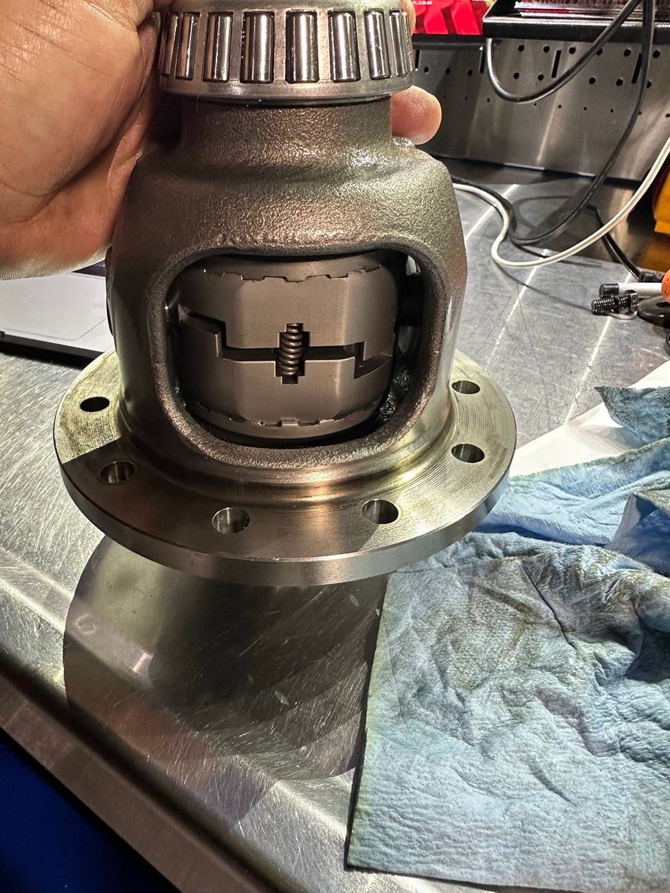

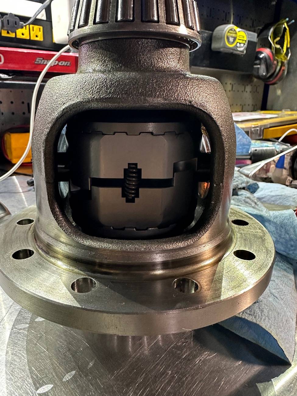

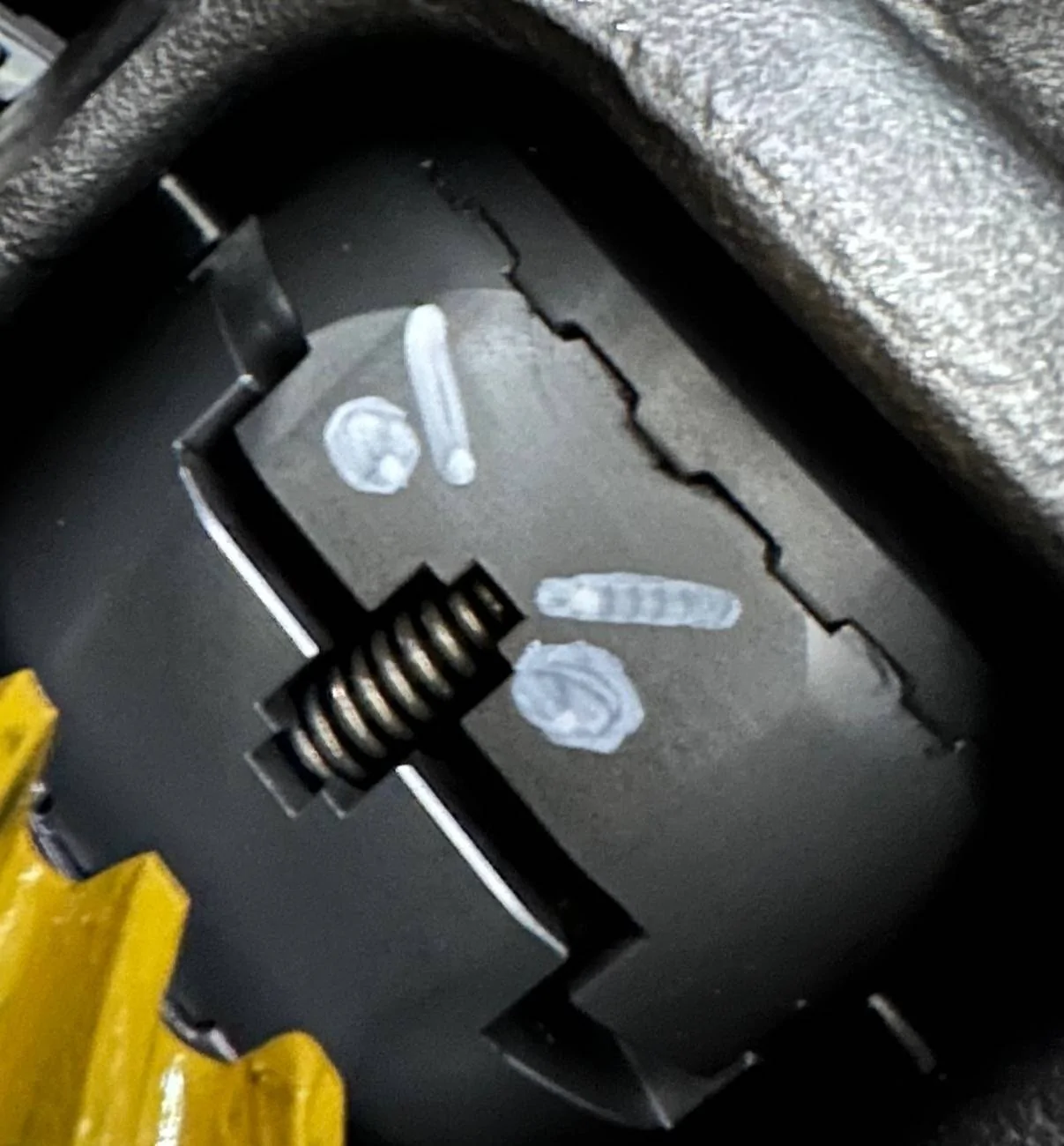

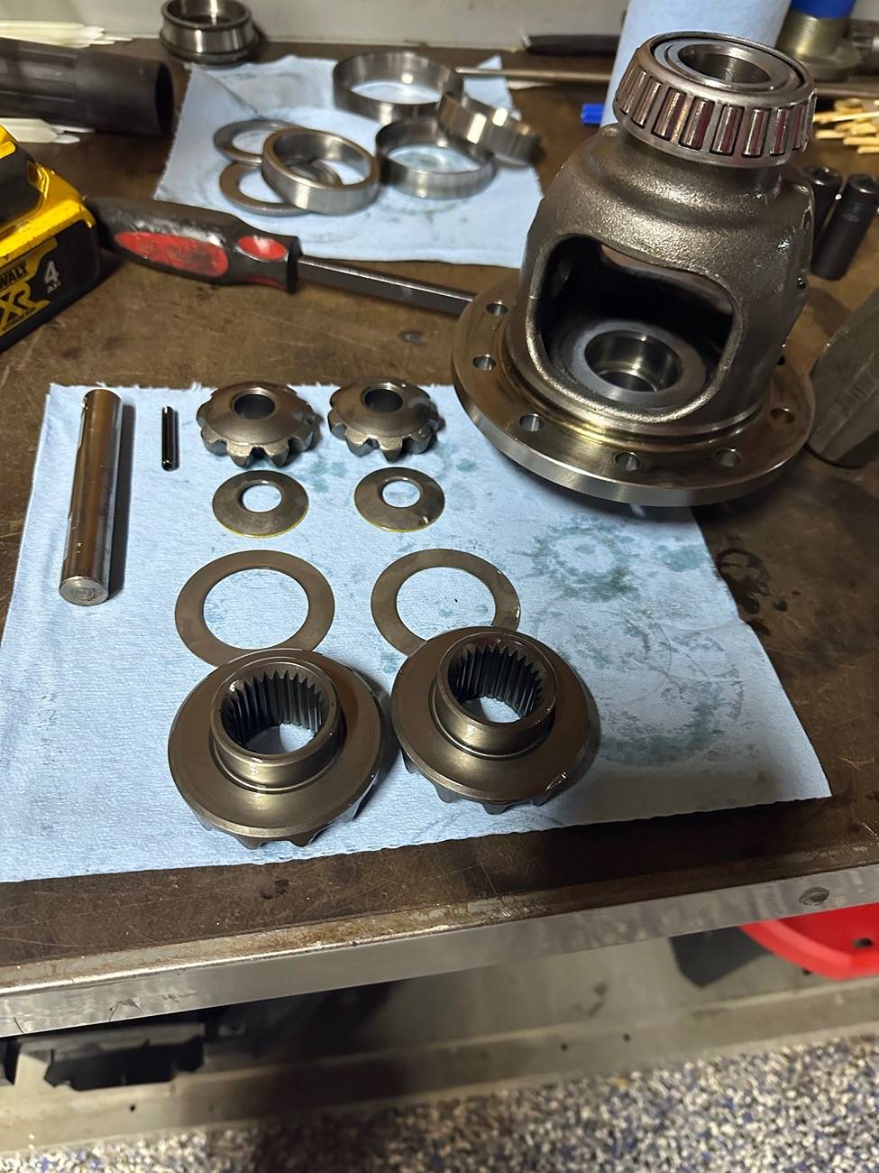

You can tap the pin out using a punch and use a brass drift and sledge to pound the pin out if you don’t have a press.
This was in a D30.

Thanks for the pics, great to see how it looks. The D30 has the pic where you can push it out with a punch from one side the other. Unfortunately, the M210 (D44) has only one opening for the pin to push down into, so now way to tap it back out again, it needs to be sheared off. But I was thinking of using a brass drift as you mentioned...
