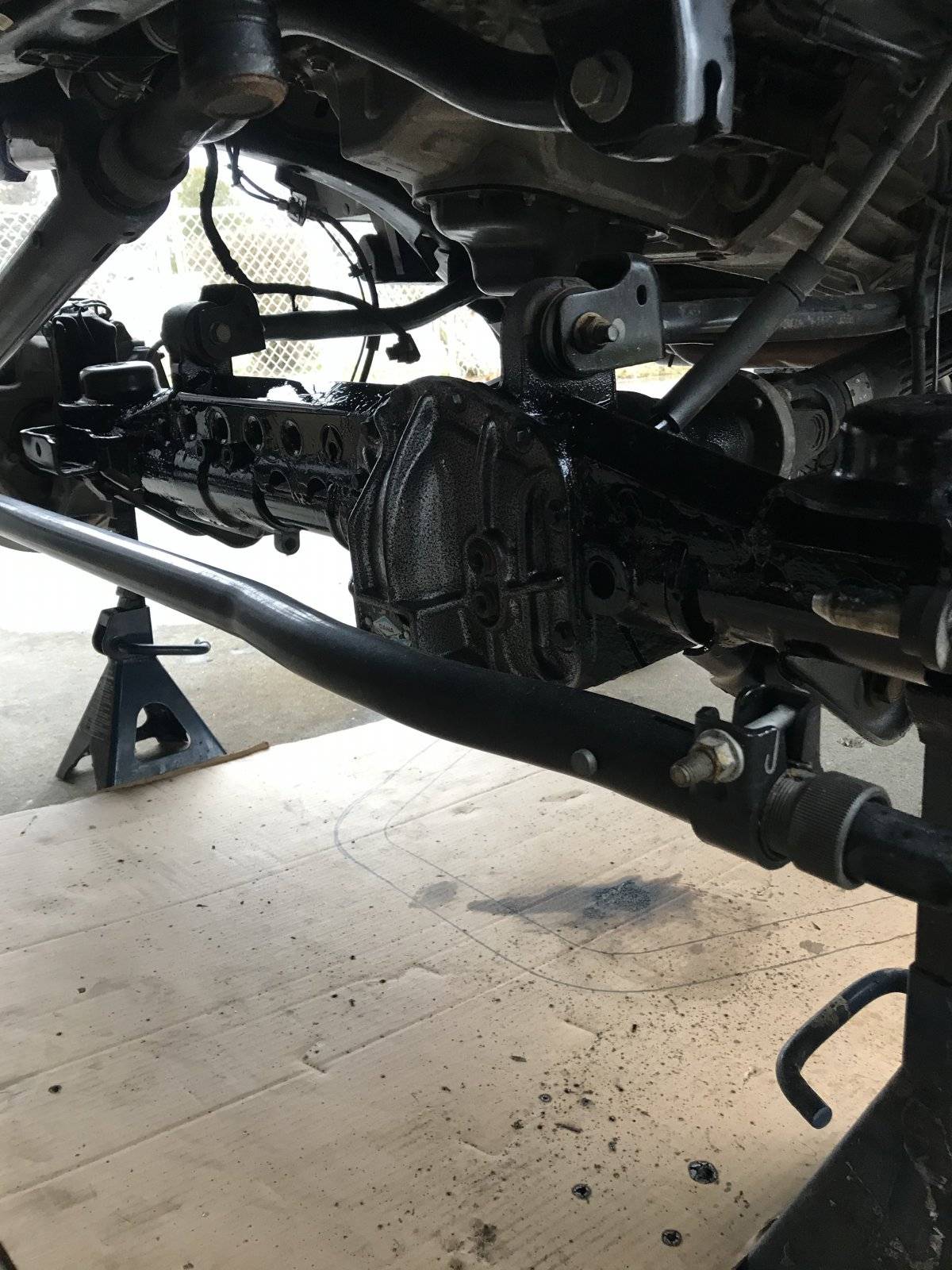

Heres my turd30
Artec truss and gussets $200
Has 4.56 gears and dana diff cover
Thinking about adding a lunchbox, or be smart and spend more for a rear locker on my 44
forgive my lack of knowledge but what are the gussets for? Is that a weak point? Common breaking point?
in JKs the gussets were weak and would bend the C
I dont think its as much of an issue on the JL, but for the $100 or so dollars, why not if you can weld yourself
