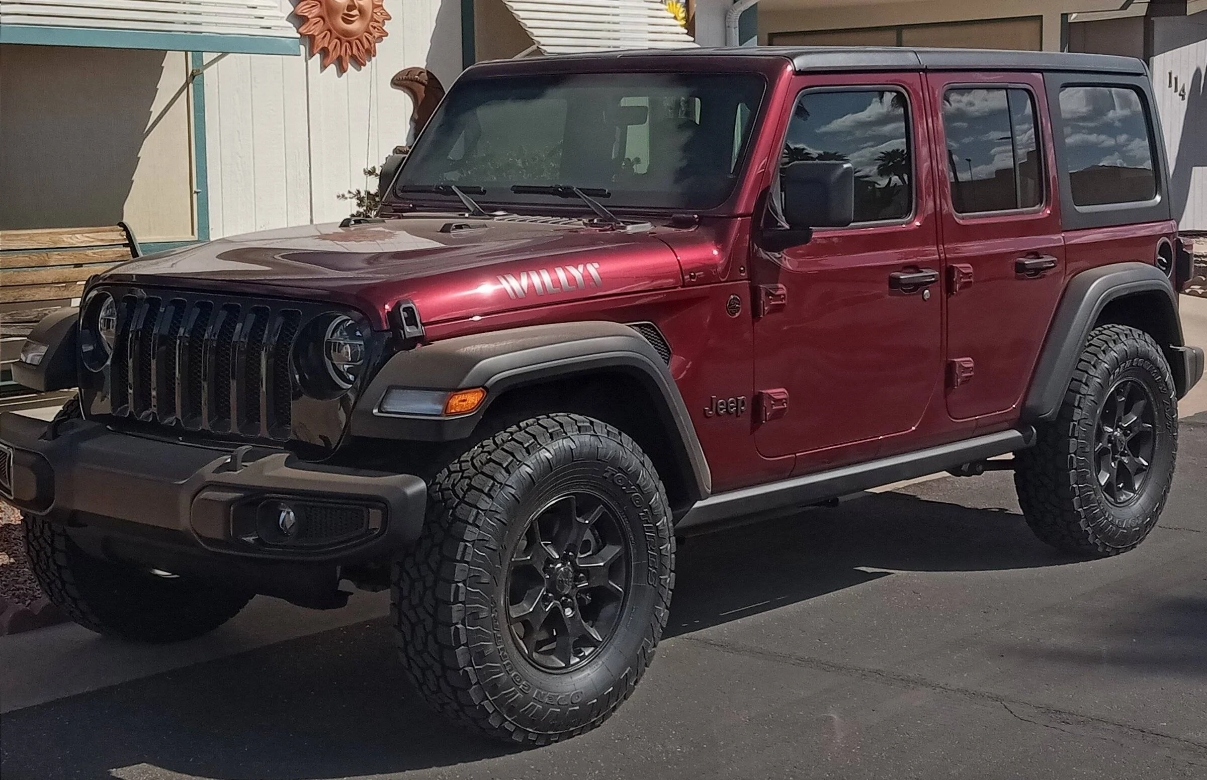

I didn't care one bit for the on-road performance of the Firestone Destination M/T tires the Wrangler was delivered with. Even with airing them down the Jeep still wandered, the tires were noisy and they sucked in the sand & rock offroad conditions in my area.
OEM Firestone:
Jeep Wrangler JL M/T Tires Suck Please Help 12
Less than a month after purchasing the vehicle I put on some Toyo ATIII tires and I couldn't be happier.
Toyo tires:
Jeep Wrangler JL M/T Tires Suck Please Help 20210304_104806
Out on the trail:
Jeep Wrangler JL M/T Tires Suck Please Help 07

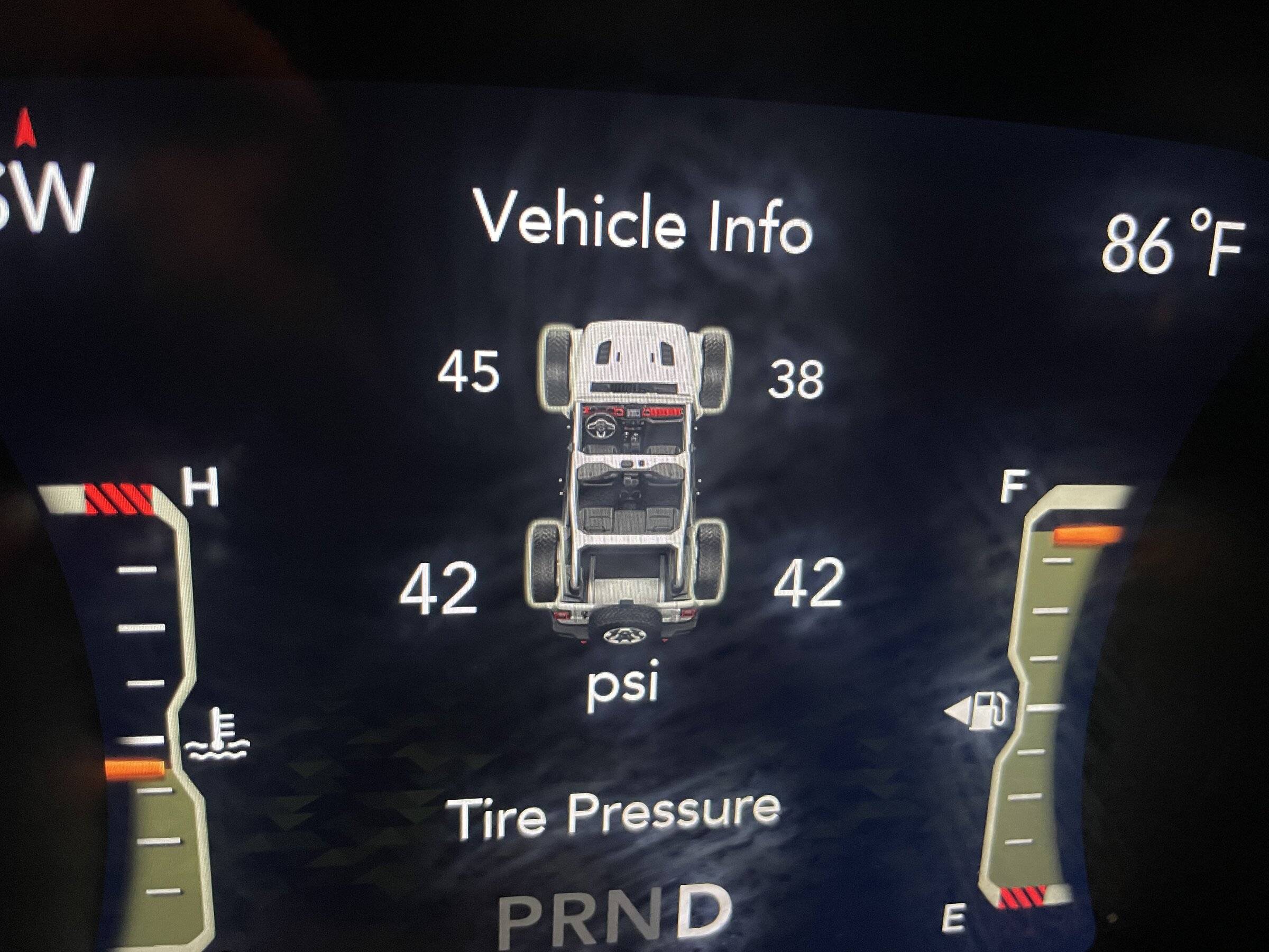

Jeep Wrangler JL M/T Tires Suck Please Help 91DAB5B1-A7CC-4FBD-ACDC-98E0E2F03EB0
Spring break here in Arizona and I rented a Jeep (Sahara) for the week. Keep in mind it’s a rental with 50,000 miles i it so I expected it to be rough. Got on the freeway and it was all over the place. Checked tire pressure and I see this! Pretty sure the 45-38 difference isn’t helping.
Going to check in the morning and likely set em at 35 all the way around.
