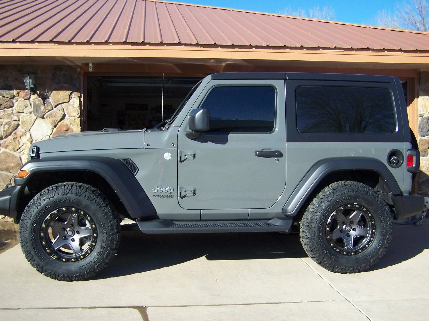

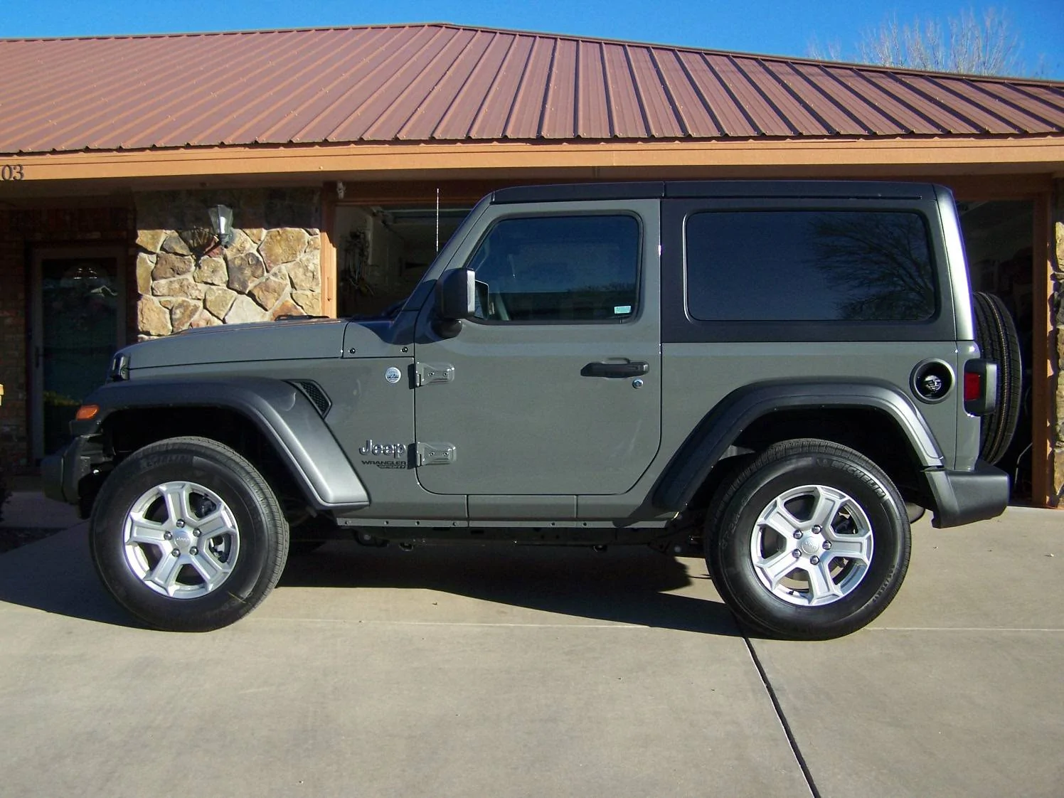

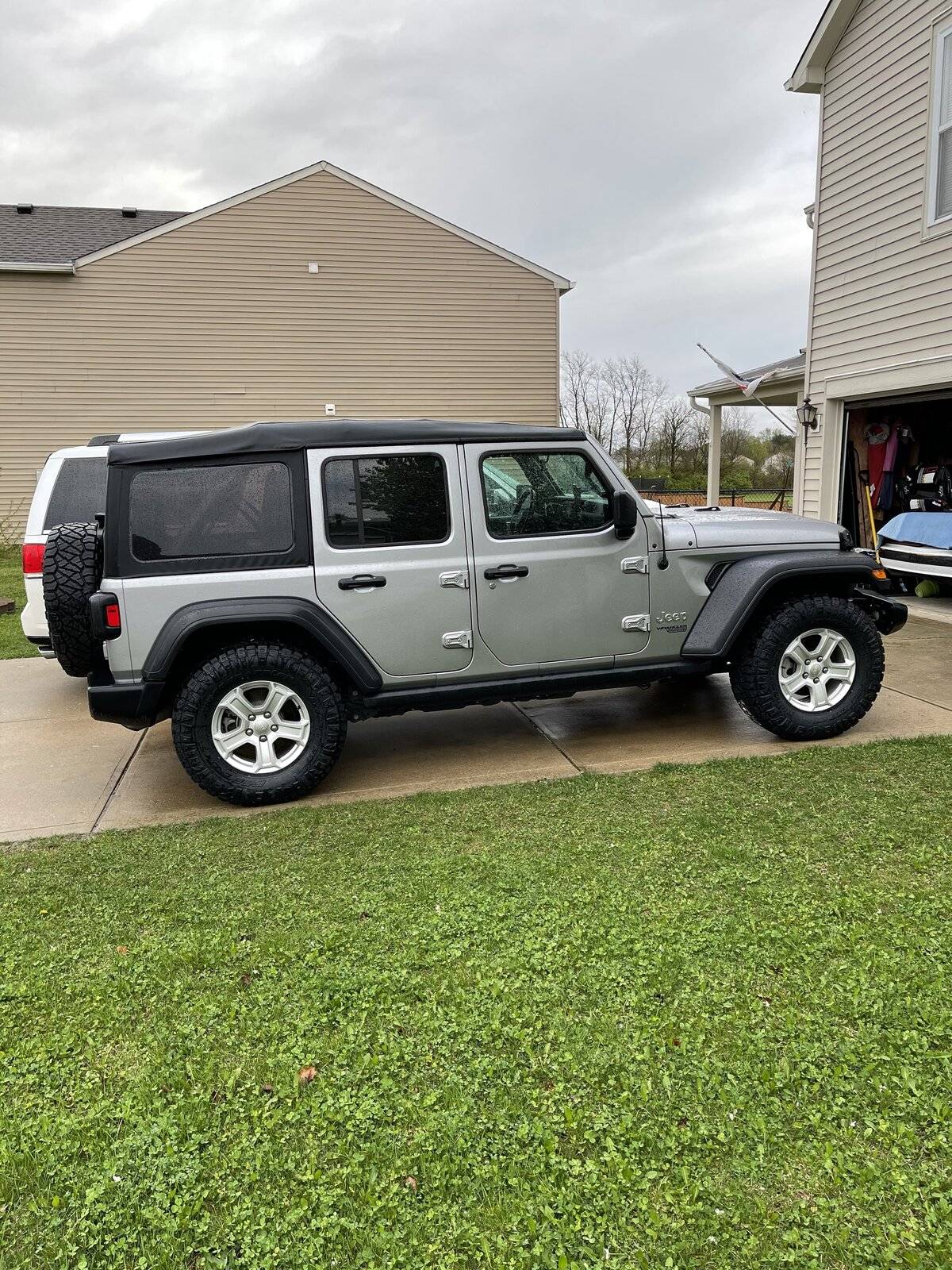

I really am enjoying my 295/70r17 ridge grapplers. Driveability really didn’t change once I updated the tire size with JSCAN. Mileage dropped from around 24 at 70mph to 21-22 at 70mph. Anything over 70 and just as stock tires the mileage drops quick from the brick like shape.
Ensure that you budget for something to correct tire size so the transmission shift points change accordingly.
pics are stock height with 295s

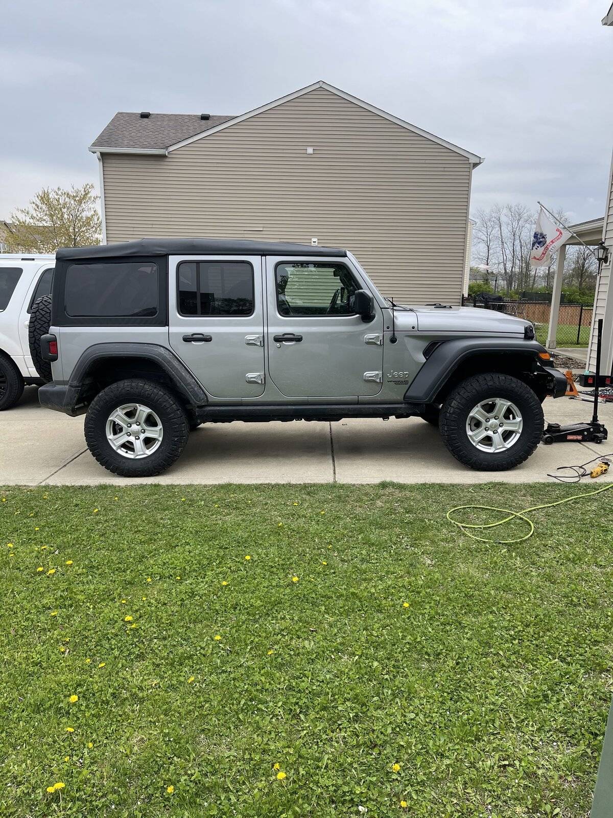

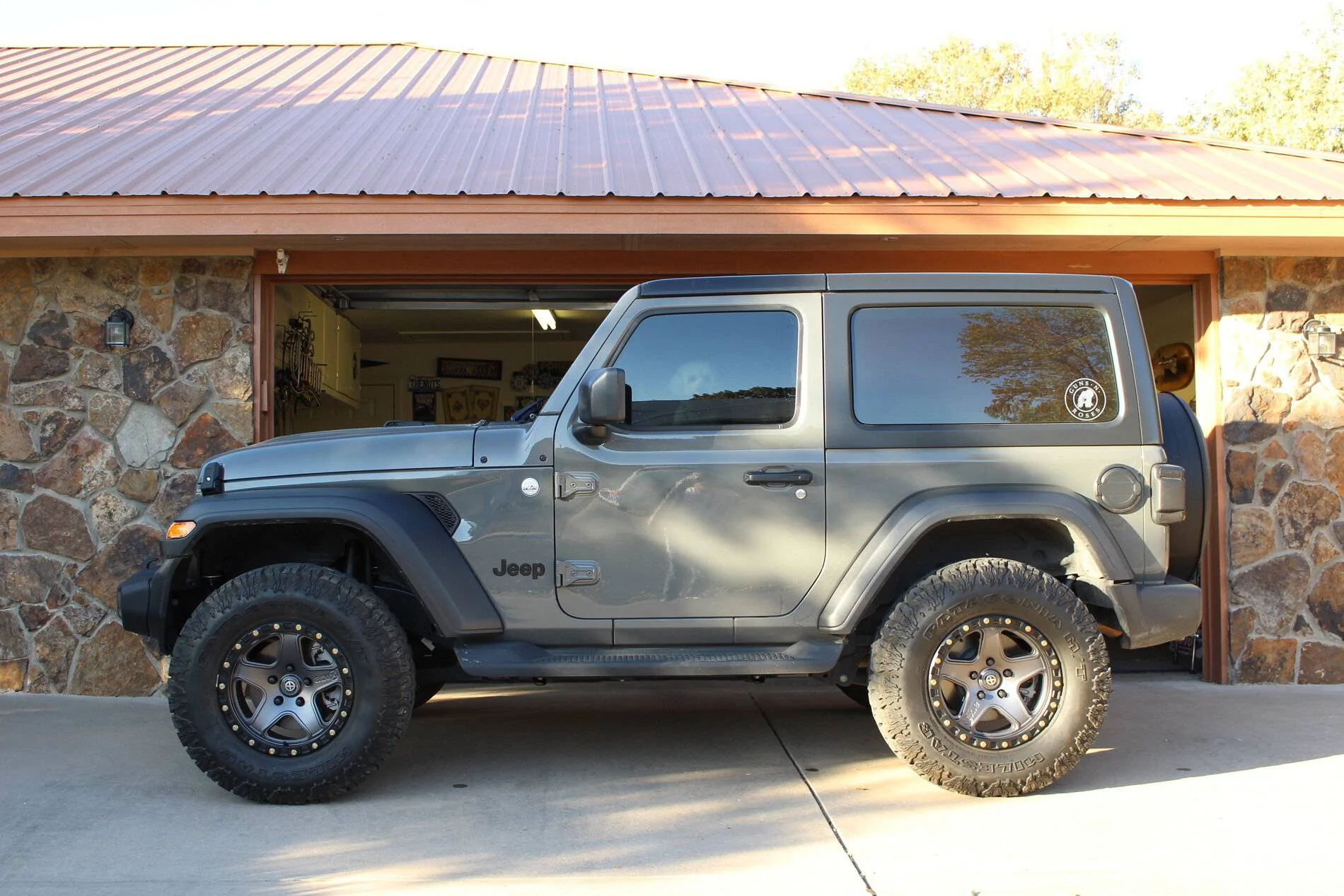

Thanks! It’s just where I want it for now. Starting to save for some rubi axles and after that it will 35s. Right now I wanted to keep it small enough to make getting the rear facing kiddo in a little easier.

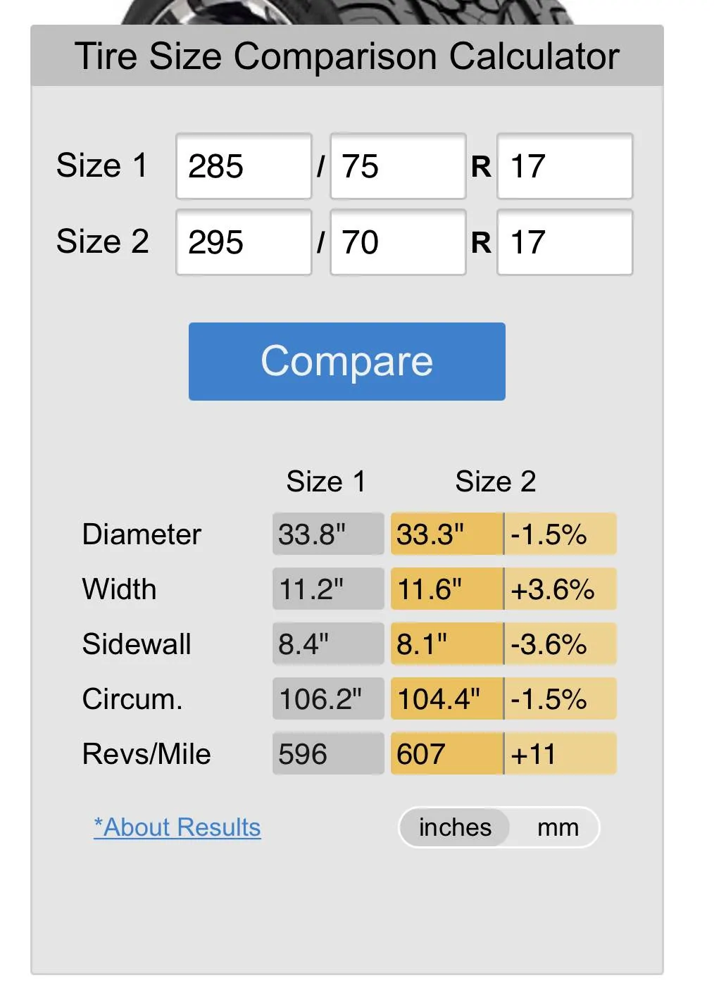

Also a screen shot of 295/70 vs 285/75. Realistic expectations either could be the larger depending on the brand. My ridge grapplers measure right on when mounted on stock wheels.
Jeep Wrangler JL Please help me select tires! 1AD41317-51FE-4EF9-8702-EF0D5DF4A3A9

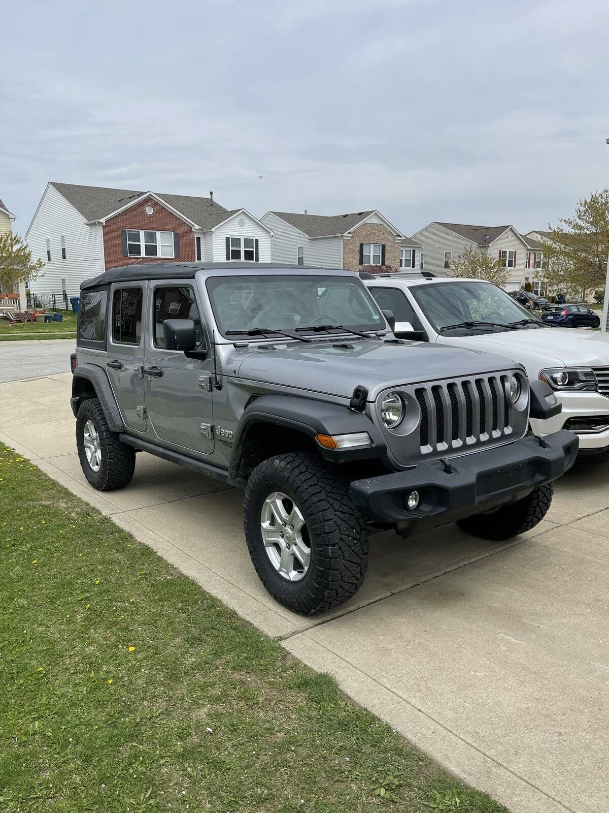

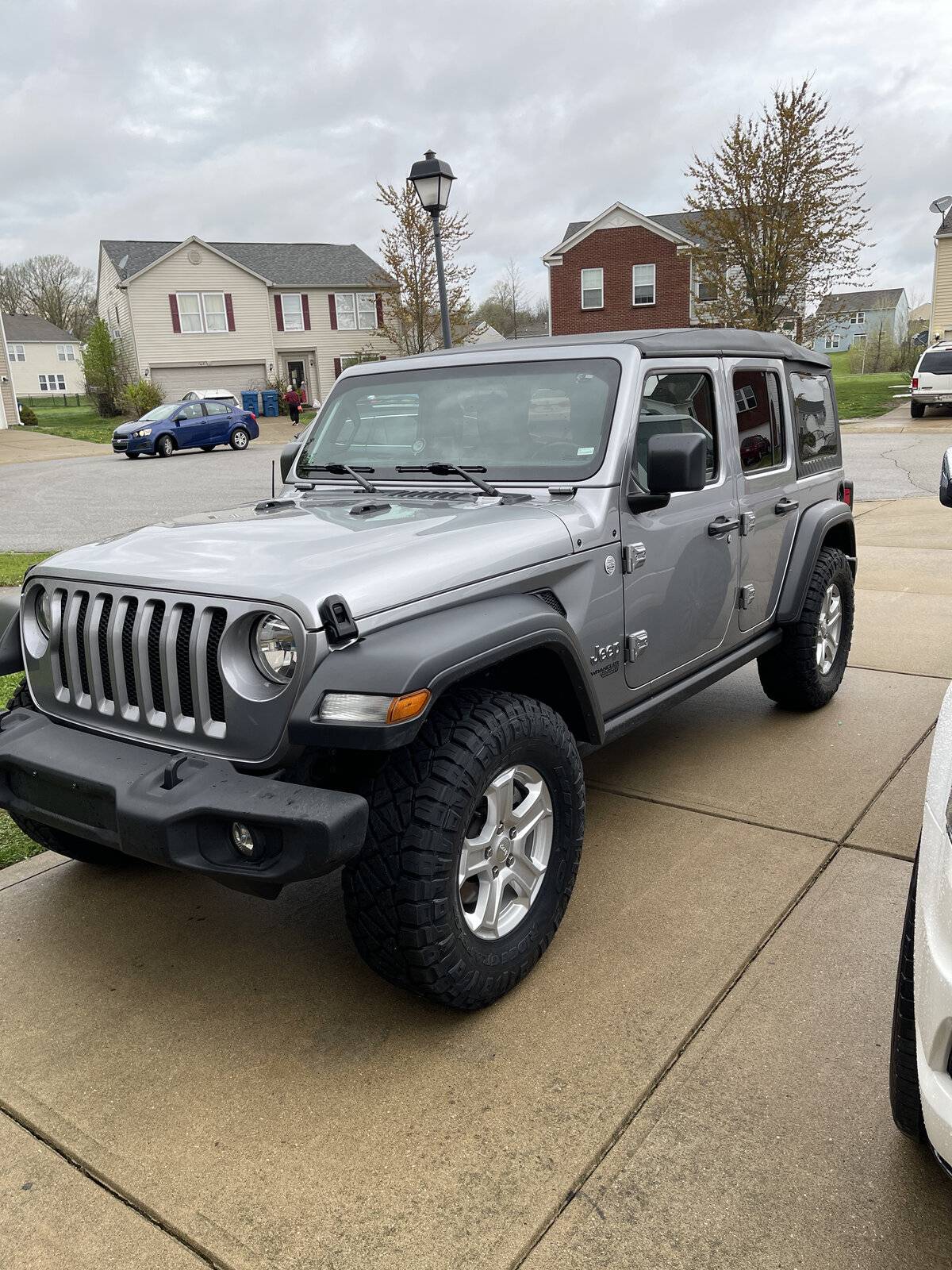

How it sits currently with 2” dynatrac springs giving exactly 3” of lift via the tape measure.
